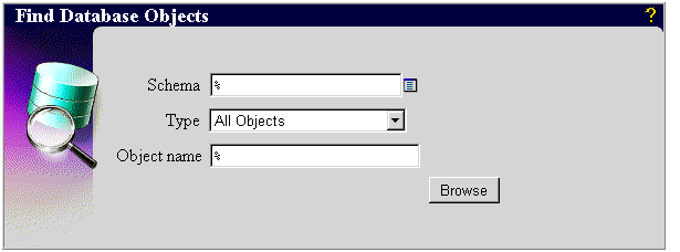

So far you have created a table (TUTORIAL_TABLE) and a procedure (TUTORIAL_PROC). Now you need to test these objects to make sure they meet the requirements of the Human Resources department. First, you need to find the table in the database.
  1. In the toolbar at the bottom of the page, clickto display the Browse Database page.
    The page displayed contains the Find Database Objects panel.
  2. In the Schema field, type the name of your own schema (the schema where you created the table).
    Tip:
    Clickto display a list of schemas if you don't know the name of the schema you want to browse.
  3. In the Type list, choose Tables.
  4. Click Browse to list all the tables in your own schema.

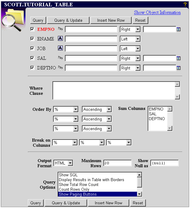

  5. Click Tutorial_Table to display the Query and Update Table page.
    The form on the Query and Update page is divided into three sections. The first section lists the columns in the table. You can type values in the fields to specify query criteria or to add new data. The second and third sections of the form enable you to specify the way the query results are displayed. For example, you can order the results by a specified column, or download the results and display them in Microsoft Excel.
    TUTORIAL_TABLE does not currently contain any data. Let's insert a row so that you have some test data to work with.
  6. Use the information in the following table to complete the first section of the Query and Update Table form.

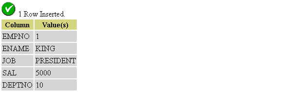

  7. Click Insert New Row to add the data to your table.
  8. Click Browse Table in the link history to return to the Query and Update Table page.

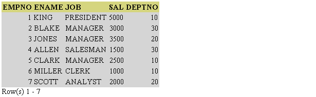

  9. Click Query to take a look at the data you just added.
  10. At the top right of the page, click Return to Table to return to the Query and Update Table page.

  12. After you have finished, in the Query and Update Table page, click Query again to review all the data.

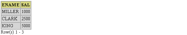

    You can also restrict which columns to query and control how the query results are displayed. For example, you might only want to see the name and salary of employees in Department 10.
  16. Click Return to Table.
  17. Uncheck EMPNO, JOB, and DEPTNO.
    ENAME and SAL should be checked.
  18. In the field for the DEPTNO column, type 10.
  19. In the Order By list, choose SAL.
  20. In the Query Options list, choose Display Results in Table with Borders.
  21. Click Query to display all those employees in Department 10. Make a note of this information, it will be useful to refer to later in this chapter.

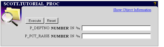

  5. Click Tutorial_Proc to display the Execute Procedure page. This is where you provide values for the arguments defined in the procedure.
  6. In the field for the P_DEPTNO argument, type 10.
  7. In the field for the P_PCT_RAISE argument, type 5.
  8. Click Execute.

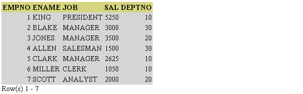

  14. Click Browse to list all the objects in your own schema that start with "tutorial".
  15. Click Tutorial_Table to display the Query and Update Table page.
  16. Click Query to view all the data in the table.
  17. Compare the salaries of the employees in Department 10 (KING, CLARK, and MILLER) with those that you noted down at the end of the previous exercise. Executing TUTORIAL_PROC has increased them by 5%.
