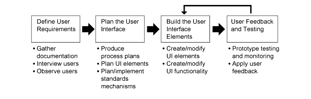

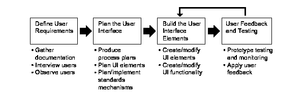

2.1.1 What are the stages?
As shown in the Figure 2-2, the process for developing a GUI consists of four major stages:
Figure 2-2 Stages in developing a user interface
The rest of this section offers guidelines for completing each of these stages:

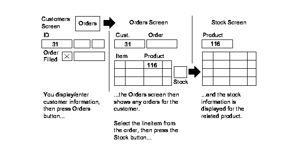

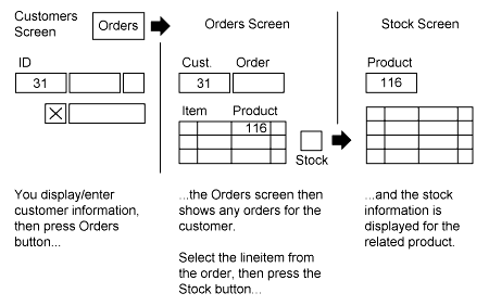

Prototypes are an extremely effective means for ensuring usability in your application. The most effective prototypes follow an iterative development model, beginning with a storyboard and ending with a fully functional application. The process breaks down as follows:
  1. Draft a storyboard to give you a clear picture of how the application will actually look and behave. A storyboard is a frame-by-frame drawing of screens showing transition and appearance. Include a narrative to describe how the screens relate to the tasks you identified when you defined the users' requirements.
    Here is an example of three panels from a storyboard for an ordering application:
Figure 2-3 Example of a storyboard
  1. Show the storyboard to users. Verify that your planned application addresses their needs and supports their tasks the way they perform them.
  2. Expand the storyboard into a paper prototype. Whereas a storyboard sketches task and window flow at a high level, a paper prototype is a fairly detailed illustration of the entire application. A paper prototype typically contains one piece of paper for each window you've planned, complete with widgets, arrows to represent task flow and navigation, and so on.

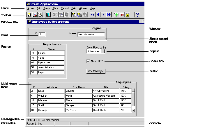

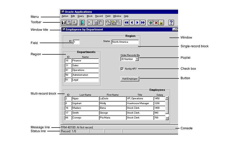

2.2.1.2 What are forms, blocks, items, regions, and frames?
Simply put, a form (or form module) is an application that provides access to information stored in a datasource. When you look at a form, you see interface items such as check boxes, radio groups, and so on, which enables the user to interact with the datasource. These interface items belong to a container called a block. In Figure 2-4, the fields Customer ID, First name, Title, and so on all belong to the same block.
Figure 2-4 Sample form
There are two types of blocks: a data block, which serves as a link between the datasource and the user, and a control block, which is not associated with a datasource. Each data block can enable the user to view and access data from one table in the datasource. Blocks can be single-record blocks, which means that they show one row of data at a time, or multi-record blocks, which enable users to see many rows of data at once. All of the fields in Figure 2-4 are in single-record blocks.
A region is a rectangle or line that separates a logical grouping of fields from others in the block. In Figure 2-4, the rectangle that separates the Customer Information fields from the Accounts icons is a region.
A frame is a pre-defined way of arranging certain items in a block. For example, the block shown in Figure 2-4 was arranged by a frame that established its margins and offsets, the distance between the items and prompts, and so on.

Here is an example of a typical Form Builder window:
Figure 2-5 Typical Form Builder window
Like most Windows 95 Form Builder windows, this one contains:
