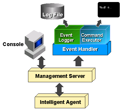

Important: The Event Handler is a pre-production feature in this release of Enterprise Manager and should not be used in a production environment. |
Applications accessing the Oracle Management Server event services may require trapping of specific event conditions and the ability to handle them appropriately. This can be achieved using the Event Handler, an application that listens for event notifications from the Oracle Management Server and allows these events to be further processed by event "adapters". An adapter is an additional piece of software that takes events from the Event Handler for further processing.
Enterprise Manager 2.1 ships with 2 event adapters:

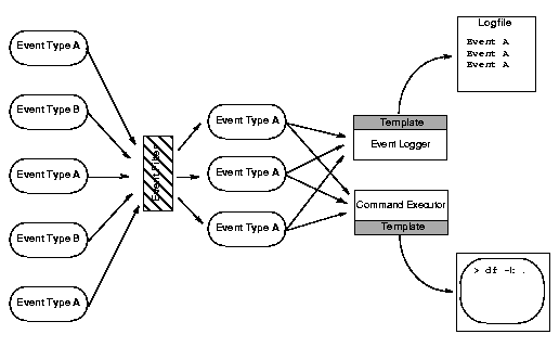

These adapters permit other types of applications to integrate with the Enterprise Manager event system and trigger other operations based on these trapped events. You can have either or both adapters working with the Event Handler.
Prior to passing event notifications for further processing, the Event Handler also provides a simple filtering mechanism that allows system administrators to specify the conditions by which the events are passed to either or both event adapters.
When the Event Handler starts, information from the filters are used to determine which events the Event Handler should select and pass on to the Event Logger and/or Command Executor adapters. Once the adapters receive the event, they further process the event based on the templates set up for the adapter. Templates provide a way to customize the behavior of the adapters. For the Event Logger, this means specifying which events should be logged. For the Command Executor, this means specifying the types of events it should respond to and the operating system command it should execute in response to that event.
To set up and implement an Event Handler, you must perform the following steps:
Filters determine which events are passed on to the Event Logger and Command Executor adapters.
Templates tell the Event Logger and Command Executor adapters how to process the event. For the Event Logger, a template specifies which events should be logged and how the information should be formatted. For the Command Executor, a template specifies the events the adaptor should respond to and the operating system command it should execute in response to that event.
There are two ways to start the Event Handler: As a Management Server service, or as a client application.

When the Event Handler starts, it uses "filters" to determine which events are passed on to the Event Logger and/or Command Executor adapters. The system administrator can designate what events, if any, are sent to the Event Logger and Command Executor adapters. This is called "filtering." Events may be filtered on a global basis (i.e. applied to both adapters) or on a per-adapter basis. Filters are set up by means of entries in the omsconfig.properties file located in the $ORACLE_HOME/sysman/config directory. Each entry specifies the conditions by which the events are passed to the adapters. The conditions are based on 'eventname' and/or 'node' on which the event occurred. An event passes thru the filter if it meets the conditions specified by the filter.
Each filter is distinguished by having a common name associated with it and the entries for that filter are grouped under this common name.

Assuming the event has passed thru the filters, they are forwarded on to the event adapters, Event Logger or Command Executor. We will describe what happens to them next.
The Event Logger logs events received from the Management Server to a file.

The Command Executor adapter executes simple commands in response to event occurrences. The command executor looks at a set of user-defined templates to decide what command to execute in response to an event occurrence. A template can contain several place-holders, which are symbolic representations for interesting pieces of information about the event. Place-holders are enclosed within '%' characters to distinguish them from ordinary words in the template string. For a list of currently used place-holders, see Table 8-1, "Event Handler Place Holders"
