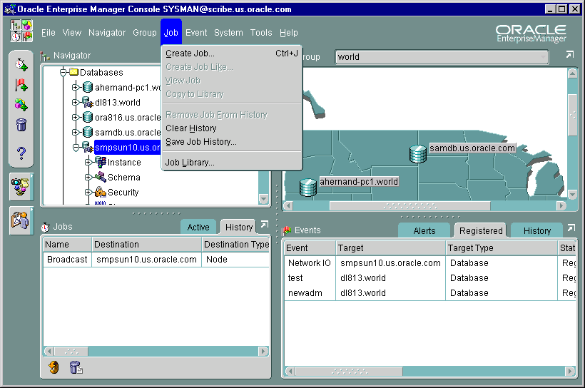

Job Menu
The Job menu allows you to create, modify, save, submit, and manage jobs. The menu options are enabled depending on the items selected in the Job pane. See Figure 4-1, "Job Pane in the Console" for an illustration of the Job menu.
Create Job
Allows you to create a new job. See "Creating, Modifying, or Viewing a Job" on page 4-11 for more information.
Create Like
Allows you to create a new job like the selected job in the Job pane. See "Creating, Modifying, or Viewing a Job" on page 4-11 for more information.
Edit Job
Allows you to modify the job selected in the Job pane. The property sheet is the same as the property sheet for creating a new job. See "Creating, Modifying, or Viewing a Job" on page 4-11 for more information.
Copy to Library
Copies the selected job to the Job Library if it does not already exist there.
View Job
Displays the property sheet for the selected job in the Job pane. The property sheet is in read-only format. Active jobs can be removed but not modified. See "Creating, Modifying, or Viewing a Job" on page 4-11 for more information.
Remove Job
Removes the selected job from the Active or History page of the Job pane. When you delete a job, there is usually a slight delay while the request is processed. See "Cancelling Jobs" on page 4-5 for specifics on job cancellation.
Job Library
Displays the Job Library dialog. See "Job Library" on page 4-11 for more information.
Save Job History
Saves the contents of the Job History page to a text file. Enter a valid file name or select an existing file in the file selection dialog box.
Clear History
Clears the jobs listed in the Job History page.
Remove Job from History
Clears the selected job listed in the Job History page.

Example: Creating a Job
This example illustrates how to complete the General, Tasks, Parameters, and Schedule Pages when creating a job. It also describes how to save and submit a job.
  1. Select Create from the Job menu to create a new job. The Create Job property sheet displays.
  2. Do not change the Owner Name.
  3. Enter a name for the new job in the Job Name field of the General Page. You may also enter a description for the job in the Description field.
  4. Select Database from the Destination Type pull-down list.
  5. Do not check the Fixit Job box for this job. You can create jobs that are used specifically as fixit jobs. Fixit jobs can be run automatically in response to an event occurrence. See "Event Parameters Page" on page 5-29 for information on fixit jobs with events.
  6. Select a destination from the Available Destinations list, then click on the << (Add) button to add the destination to the Selected Destinations list. These are destinations where an Intelligent Agent is running. The Job Credentials must be set up correctly for these destinations. See "Job Credentials" on page 4-4 for more information.
  7. Repeat the previous step for another destination. You are choosing the destinations where the job will be run.
  8. Click on the Task Page tab of the Create Job property sheet.
  9. Select Run SQL*Plus Script from the Available Tasks list, then click the << (Add) button to add the task to the Selected Tasks list. For this example, add only the Run SQL*Plus task. You can specify multiple tasks for a job and make a task conditional on a previous task.
  10. Make sure the task is set to run Always. If you specified multiple tasks for this job, you could make a task conditional on a previous task.
  11. Check the box to send an enhanced notification if the job task fails.
  12. Click on the Parameters Page tab of the Create Job property sheet to set the parameters:
    • Enter "SELECT * FROM dba_users;" in the text box.
    • Do not check the Override Preferred Credentials box. If you do not override the credentials, the information that is set up with the administrator Preferred Credentials property sheet is used. See "Job Credentials" on page 4-4 for permissions needed to run job tasks.
  13. Click on the Schedule Page tab of the Create Job property sheet to schedule the execution of the job.
  14. Select the On Interval under Run Job to execute the job on a specific interval.
  15. Set the Start Running Date of the job to 7/1/2000. Select the month value in the Start Execution Date field and enter 7. You can also click the up and down arrows to change the value when a number is selected.
  16. Repeat the process in the previous step for the day and year values of the Start Running Date.
  17. Change the Start Running Time to 12:00 AM. Use the same procedure that you used to set the date.
  18. Check the Stop Running box to set a final execution date for this job.
  19. Set the Stop Running Date of the job to 12/30/2000. Set the Stop Running Time of the job to 12:00 AM.
  20. The Time Zone should be set to Intelligent Agent (currently static text). This job will execute at the local time zone where the Intelligent Agent is located. This is the time zone of the destination.
  21. Select the Every ... Days button to set the job frequency for day interval. Click on the up arrow to change the value to 3 days.
  22. Click on the Permissions Page tab of the Create Job property sheet to assign permissions on this job for other administrators.
  23. Allow all other Enterprise Manager administrators to view and receive notifications for this job.
  24. Click the Submit and Add to Library button to save the new job in the Job Library and submit the job to the selected destinations.
  25. If you want to modify this job later, select the job in the Job Library dialog and choose the Edit option. You can also double-click on the job.
A submitted job is sent to the Intelligent Agents at the selected destinations. The Intelligent Agent for a destination begins processing the job, the job appears in the Active Jobs page in the Job window. If the job is processed successfully, the job will start executing on 7/1/2000 at 12:00 AM. After an execution of a job, it is moved to the Job History page of the Job window. You can view the progress of the job and any output in the Job Progress Page.
