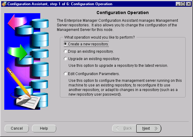

Step 1 "Configuration Operation"
When you start the Enterprise Manager Configuration Assistant as a standalone application, the "Configuration Operation" page appears.
When the Configuration Assistant is launched from an installation session and you have selected to create a new repository from the install dialog, the Configuration Operation screen will not appear. The screen will be "Select Database for Repository." In this case, proceed to Step 2 of 5.
Select "Create a new repository" from the list of repository operations and press Next. The "Select Database for Repository" page appears.

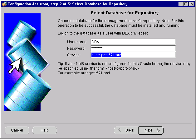

Step 2 "Select Database for Repository"
Log in to the database where you want to create the repository.
User name and Password: You must connect to the database as a user with DBA privileges. This is an individual database user account, not an Oracle Enterprise Manager administrator account.
For example, system/manager.
Service: The service may be specified using the form:
<host>:<port>:<sid>
where
host is the machine name where the database is located
port is the database listener port address, usually 1521 or 1526
SID is the database system identifier
An example:
pjlee-pc:1521:orcl
which connects to the orcl database using port 1521 on the pjlee-pc machine.
Press Next to continue.
Refer to "Troubleshooting the Enterprise Manager Configuration Assistant" on page C-18 for information about error messages.
When configuring your repository, choose a database that meets the following criteria:

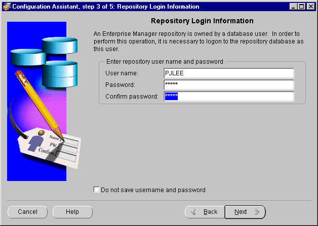

Step 3 "Repository Login Information"
An Enterprise Manager repository is owned by a database user. During repository creation, a database user (repository schema user) who owns the repository will be created by the Enterprise Manager Configuration Assistant with the username and password you enter on this page.
User name: Enter the repository's user name that will be used to create a database user that will own the repository. The repository's user name must be unique across the network. The TCP/IP hostname of the machine is assumed to be unique; therefore it is used by default. If you choose another name, you must ensure that it is unique.
Password: Enter the password for that user.
Confirm: Verify the password by typing it again.
You can choose whether to save the user name and encrypted password in the omsconfig.properties file, which is read by the Management Server on startup. If these repository credentials are stored in the file, the Management Server uses them to login to the repository; if they are not saved, the Management Server prompts you for a user name and password before it starts up.
If you do not want to store the user name and encrypted password in the omsconfig.properties file, check the "Do not save username and password" checkbox.
If the username you chose for your repository already exists, the Select Repository User Tablespace page is skipped. The Create Repository Summary page is your next page.
The repository schema user created by the Enterprise Manager Configuration Assistant is different from the individual database user account with DBA privileges that you use to connect to a database in the "Select Database for Repository" step of the Enterprise Manager Configuration Assistant. The repository schema user will not have the necessary DBA privileges for this step.
To avoid potential security issues, do not grant more privileges to your repository schema user than is necessary.
For the "Select Database for Repository" step of the Enterprise Manager Configuration Assistant, connect to the database as a database user with DBA privileges instead of granting DBA privileges to the repository schema user and using it to connect to the database. For example, system/manager.
For the "Repository Login Information" step of the Enterprise Manager Configuration Assistant, logon to the repository database as the repository schema user.

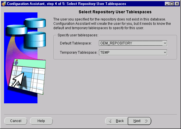

If the OEM_REPOSITORY tablespace already exists, the following screen appears.
Select the default and temporary tablespaces for the Enterprise Manager repository to use.

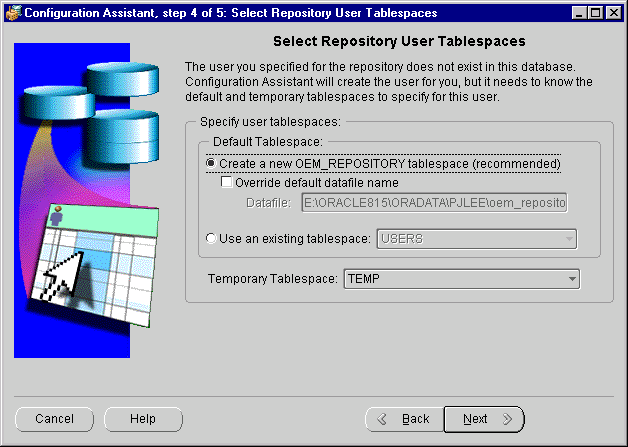

If the OEM_REPOSITORY tablespace does not exist, the following screen appears:
Default Tablespace:
Temporary Tablespace
Select a temporary tablespace from the pull-down list.
Click Next to continue.
If the Enterprise Manager Configuration Assistant detects that the default tablespace for the repository contains the required amount of free space, the "Create Repository Summary" page appears.

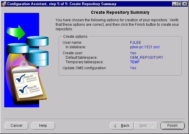

Step 5 "Create Repository Summary"
The "Create Repository Summary" page appears, showing a summary of the processing to be performed. Verify that all of the information supplied during the create repository wizard operation is accurate.
Click Finish to initiate repository creation or click Back to return to previous pages to make modifications.

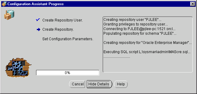

When you click the Finish button, the Configuration Assistant Progress window appears, showing the processing performed and the processing steps that comprise the operation being performed.
Step 6 "Configuration Assistant Progress Window"
If you want to see detailed information about what is happening during the processing, including any errors that might occur, click the "Show Details" button to expand the dialog to show a text area. You can hide the detailed information by clicking the "Hide Details" button.
The Cancel button changes to a Close button when processing is completed whether it is successful or not.
When all of the steps have been completed without error, the "Processing completed." message appears.
You can cancel the requested operation before it completes by clicking the Cancel button.
If you cancel the repository creation while it is in progress, the state of the repository is in doubt. In these circumstances, you should drop the repository using the Enterprise Manager Configuration Assistant.
You must click the Close button to exit the Configuration Assistant.
