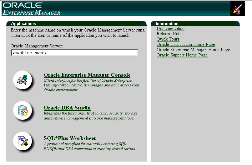

  1. Launch your web browser and enter the following URL regardless of which webserver you have installed.
    http://<webserver hostname>:<port number>/
    oem_webstage/EMWebSite.html
    For example:
    http://jfox-sun:3339/oem_webstage/EMWebSite.html
The Oracle Application Server Listener port number is 3339.
  1. On this index page, enter the machine name for the Management Server to which you want to connect and click the application icon or name of the application you want to launch.
Once you are prompted to install the plug-in and you exit or cancel, you will no longer be prompted to install it the next time you launch the browser-based Enterprise Manager. In this situation, to install the plug-in, enter the URL:
http://<webserver hostname>:<port number>/oem_webstage/java-plugin/
install_win32.html.
