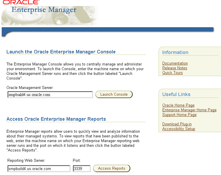

The index (emwebsite.html
) page will appear. The index page allows you to start the Enterprise Manager Console, Enterprise Manager Reporting web site, and documentation, and access various web sites. For information on setting up the Enterprise Manager Reporting Web Site, see "Configuring Enterprise Manager Reporting".

In addition, the Oracle Enterprise Manager Console Login will appear.
Note: Starting the browser-based Oracle Enterprise Manager for the first time may take several minutes, and if you are running a dial up connection, download times will typically be longer and vary based on the line speed. A progress dialog will appear the first time you start browser-based Oracle Enterprise Manager.
Administrator = sysman
Password = oem_temp
These credentials are for the default Super Administrator account. The first time you start Enterprise Manager, you must login as this Super Administrator. After other administrator accounts have been created using the Super Administrator account, you can login as a different administrator.
Note: If you are not able to connect to the Management Server specified, you must return to the index (emwebsite.html
) page to enter a different Management Server machine name. You cannot simply enter a new Management Server machine name at the Oracle Enterprise Manager Console Login.
