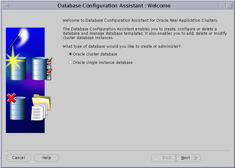

The following section describes how to use the DBCA to create a database for Real Application Clusters. When you run the DBCA the first page displayed is the Database Configuration Assistant Welcome page for Real Application Clusters shown in Figure 4-1. The DBCA only displays this page when it detects that your Cluster Manager (CM) software is running.
If the DBCA does not display the Real Application Clusters Welcome page with the Oracle cluster database option, then perform clusterware diagnostics as shown in the bulleted items in Step 6.

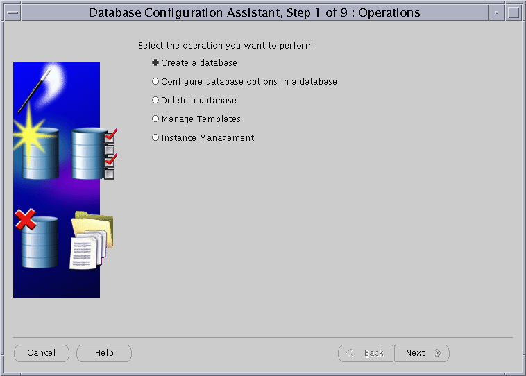

After you click Next, the DBCA displays the Operations page shown in Figure 4-2.

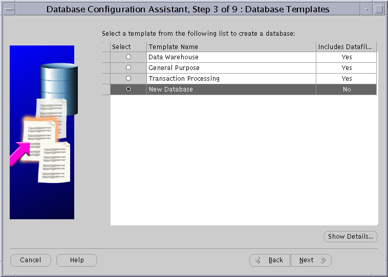

After you click Next, the DBCA displays the Database Templates page shown in Figure 4-4.
The templates on this page include the Data Warehouse, Transaction Processing, and General Purpose templates. These templates include datafiles and specially configured options for each environment. However, the New Database template does not include datafiles or the specially configured options.

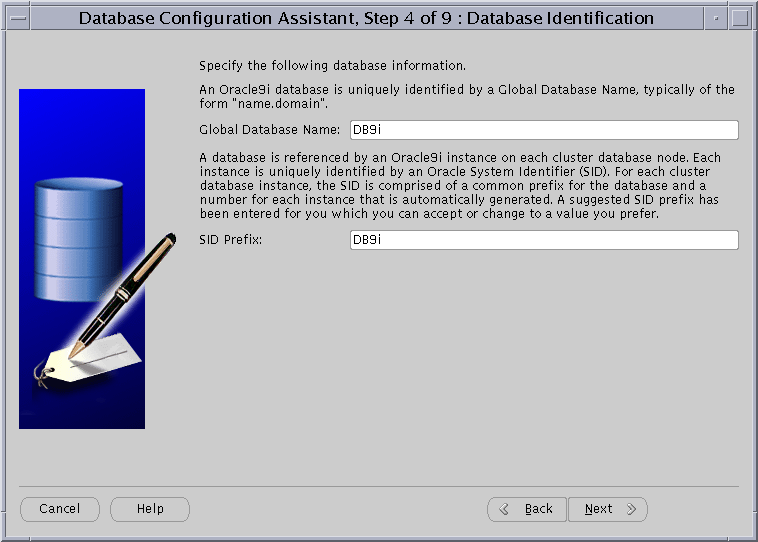

After you click Next, the DBCA displays the Database Identification page shown in Figure 4-5.
Note: The SID prefix must be between one and five characters in length and the database name must begin with an alphabetical character. |

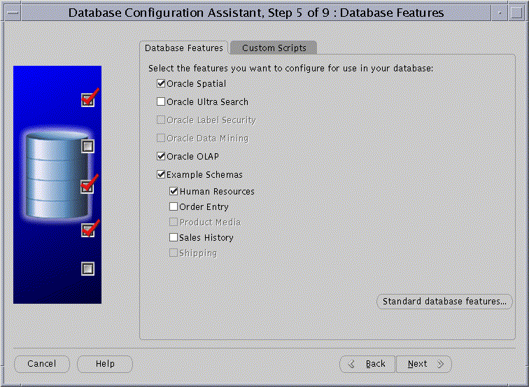

After you click Next, if you have selected the New Database template, then the DBCA displays the Database Features page shown in Figure 4-6. If you selected one of the other preconfigured database options, then after you click Next the DBCA displays the Initialization Parameters page shown in Figure 4-8.

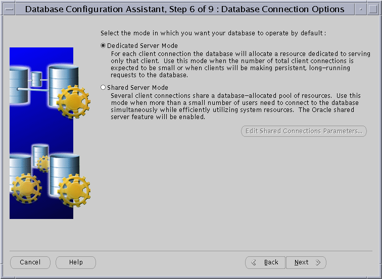

After you click Next, if you have selected the New Database template, then the DBCA displays the Database Connection Options page shown in Figure 4-7.

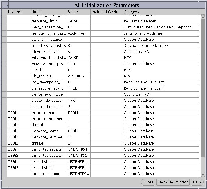

After you click Next, the DBCA displays the Initialization Parameters page shown in Figure 4-8.
If you select Create server parameter file (spfile), then you may need to modify the location for the server parameter file depending on the type of file system you use as described for the following conditions:
Instance-specific parameter settings for your Real Application Clusters database appear at the bottom of this dialog. The sid prefixes for these entries appear in the left-hand column.
The DBCA only places parameter entries from the All Initialization Parameters dialog into the server parameter file that have check marks in the Included (Y/N) column. Also note the following about the All Initialization Parameters dialog:

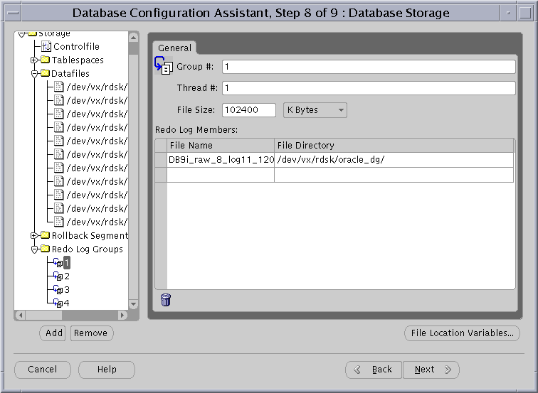

After you click Next, the DBCA displays the Database Storage page similar to the page in Figure 4-10.
Use the Database Storage page to enter file names for each tablespace such as SYSTEM, USERS, TEMP, DRSYS, TOOLS, INDX, and so on. The Storage page displays these file names in the Datafiles folder.
Platform-specific issues for entering file names in the Database Storage page are:
DBCA_RAW_CONFIG environment variable, then the DBCA displays default datafile names. You must override these names to provide raw device names on this page for each control file, datafile, and redo log group file.If you select a template that includes datafiles, then the Storage page does not display tablespace information. Instead, the Storage page displays default datafile names that you must replace with raw device filenames. If you are creating a database with a preconfigured database template, then the Storage page does not allow you to change tablespace sizes.

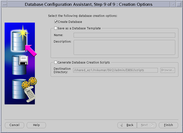

After you click Next, the DBCA displays the Creation Options page shown in Figure 4-11.

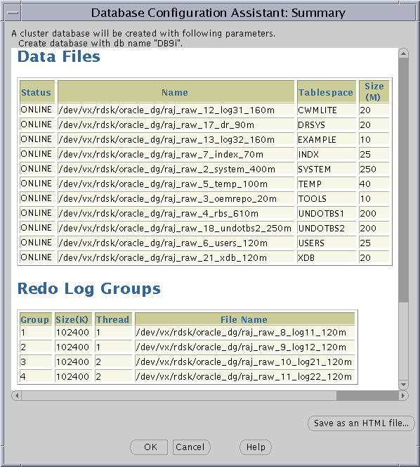

After you click Finish on the Creation Options page, the DBCA displays a Summary dialog similar to the dialog in Figure 4-12.
At this point in the database creation process you have:

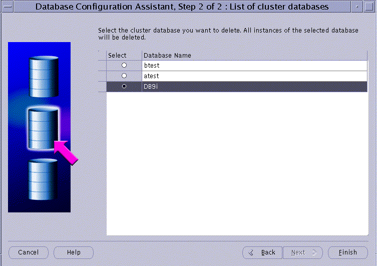

After you click Next, the DBCA displays the List of Cluster Databases page similar to the page in Figure 4-14.

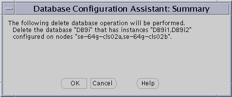

After you click Finish, the DBCA displays a Summary dialog showing the database name and associated instances that the DBCA is going to delete. This Summary dialog, which is similar to the dialog in Figure 4-15, also describes the node or nodes on which the instances reside.
When you click OK, the DBCA continues the operation and deletes all the associated instances for this database. The DBCA also removes the parameter files, password files, OracleServicesid services, and oratab entries.
