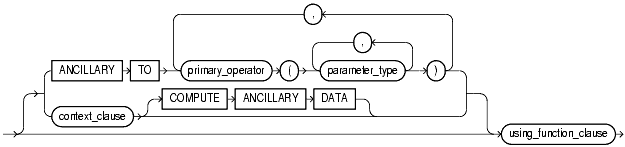

Use the binding_clause
to specify one or more parameter datatypes (parameter_type
) for binding the operator to a function. The signature of each binding (that is, the sequence of the datatypes of the arguments to the corresponding function) must be unique according to the rules of overloading.

Use the ANCILLARY
TO
clause to indicate that the operator binding is ancillary to the specified primary operator binding (primary_operator
). If you specify this clause, do not specify a previous binding with just one number parameter.
Use the context_clause
to specify the name of the implementation type used by the functional implementation of the operator as a scan context.
Specify COMPUTE
ANCILLARY
DATA
to indicate that the operator binding computes ancillary data.
The using_function_clause
lets you specify the function that provides the implementation for the binding. function_name
can be a standalone function, packaged function, type method, or a synonym for any of these.
