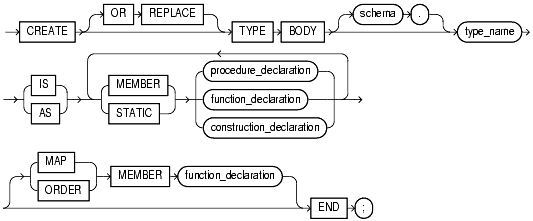

create_type_body::=

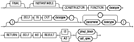

constructor_declaration::=

Specify OR REPLACE to re-create the type body if it already exists. Use this clause to change the definition of an existing type body without first dropping it.
Users previously granted privileges on the re-created object type body can use and reference the object type body without being granted privileges again.
You can use this clause to add new member subprogram definitions to specifications added with the ALTER TYPE ... REPLACE statement.
Specify the schema to contain the type body. If you omit schema, Oracle creates the type body in your current schema.
Specify the name of an object type.
Specify the type of method function or procedure subprogram associated with the object type specification.
You must define a corresponding method name, optional parameter list, and (for functions) a return type in the object type specification for each procedure or function declaration.
Declare a procedure or function subprogram.
Declare a user-defined constructor subprogram. The RETURN clause of a constructor function must be RETURN SELF AS RESULT. This setting indicates that the most specific type of the value returned by the constructor function is the same as the most specific type of the SELF argument that was passed in to the constructor function.

You can declare either a MAP method or an ORDER method, but not both. If you declare either method, you can compare object instances in SQL.
If you do not declare either method, you can compare object instances only for equality or inequality. Instances of the same type definition are equal only if each pair of their corresponding attributes is equal.
Specify MAP MEMBER to declare or implement a member function (MAP method) that returns the relative position of a given instance in the ordering of all instances of the object. A MAP method is called implicitly and specifies an ordering of object instances by mapping them to values of a predefined scalar type. PL/SQL uses the ordering to evaluate Boolean expressions and to perform comparisons.
If the argument to the MAP method is null, the MAP method returns null and the method is not invoked.
An object type body can contain only one MAP method, which must be a function. The MAP function can have no arguments other than the implicit SELF argument.
Specify ORDER MEMBER to specify a member function (ORDER method) that takes an instance of an object as an explicit argument and the implicit SELF argument and returns either a negative, zero, or positive integer. The negative, positive, or zero indicates that the implicit SELF argument is less than, equal to, or greater than the explicit argument.
If either argument to the ORDER method is null, the ORDER method returns null and the method is not invoked.
When instances of the same object type definition are compared in an ORDER BY clause, Oracle invokes the ORDER MEMBER function_declaration.
An object specification can contain only one ORDER method, which must be a function having the return type NUMBER.
