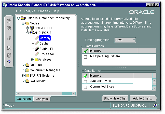

Figure 4-3 shows a typical collection class for a node target on Windows NT and the data sources and data items available for the class.
 The following list explains classes, data items, and data sources in more detail:
A class is a container for a particular category of data. For example, a node (or operating system) target might include the following classes:
When you select a target in the navigator, Capacity Planner displays the names of the classes below the target in the tree view.
You can collect data from none, some, or all displayed classes for a target. A class may also be a container for other classes, to provide logical groupings of the performance data at higher levels. For example, an I/O class may be a container for other more specific I/O classes.
In a class, each of the related statistics is referred to as a data item. For example, a LogicalDisk class might include the following data items:
A class can contain one or more data items. When you select a class in the navigator, the names of the data items and data sources associated with the data items are displayed on the Collection Details property page. Select the data items that you are interested in collecting.
A green check mark appears next to the name of each data item that is selected for collection. You can toggle the state of all data items between collected and not collected by clicking the Data Items column header that contains the check mark.
A data source is a description of where Oracle Capacity Planner can collect the data items for a class. A class can contain one or more data sources. When you select a class in the navigator, the names of the data items and data sources associated with the class are displayed on the Collection Details property page.
The type of data in the class determines the data sources for the class. For example, in a LogicalDisk class, the data sources might be the individual disks for the operating system (for example, disk1, disk2, and so on). In a CPU Utilization class, the sources are the individual CPUs for the host (for example, cpu1, cpu2, and so on). You can collect data items from one or more data sources.
When you select a data source, a green check mark appears next to the name of the data source on the Collection Details property page. You can toggle the state of all data sources between collected and not collected by clicking the Data Sources column header that contains the check mark.
After you select the data items that you want to collect from the available data sources on the Collection Details property page, click Apply to confirm your selections, or click Revert to cancel the selections.
When you click Apply for a class of data, Capacity Planner marks the icon for the selected class and the selected target with a green dot in the Collection view of the navigator panel. A green dot on a collection class icon indicates that one or more data sources are selected for the class. A green dot on a target icon indicates that Capacity Planner is collecting data for one or more classes in the target.
For example, in Figure 4-4, Capacity Planner is actively collecting data for the Processor, Memory, and Cache classes for node ANG-PC. Capacity Planner is not collecting data for the System collection class.

When you expand a target in the navigator under the Historical Database folder, two forms of data are displayed below the target:
The classes displayed for the target are the collection classes for which data is available in the Oracle Capacity Planner historical database. You can select and view data from these classes by selecting a class in the navigator, specifying the selection criteria, and then clicking Show New Chart. These operations are the first step in creating an analysis.
Below each target in the navigator is an Analyses folder, which contains predefined and user-defined analyses. Predefined analyses are provided for some targets. You can create user-defined analyses by selecting a class of data, displaying an analysis of the data, and then saving the analysis. You can also create a user-defined analysis by using an existing analysis as a template, making modifications to the analysis, and then saving the analysis under a new name.
To browse the collected data for a particular target:
You are prompted for the credentials for the historical database that contains the collected data that you want to analyze.
The navigator displays the:
To view an analysis chart for a selected class of data:
Capacity Planner displays the property page for the class (Figure 4-6).
Capacity Planner displays the Analysis window, which contains two or more pages. The Chart page displays the chart. The remaining pages are Details pages. A separate Details page exists for each class from which one or more data items are included in the analysis.
For information about the Analysis window, choose Window from the Analysis window Help menu. For information about modifying the analysis or changing the way the data is displayed, see "Working with Analyses" .
After you view an analysis for a class of data, you can save it as a user-defined analysis to view later.
To save the analysis:
Performance Manager places the new user-defined analysis in the Analyses folder of the navigator panel.
 When you select a class in the navigator panel in analysis view, Capacity Planner displays a property sheet that contains options available for selecting data from the Oracle Capacity Planner historical database for that class.
Before you display a chart of the collected data you must:
For example, select Hours if you want to analyze hourly data, Days if you want to analyze daily data, and so on.
A check mark appears next to each data item that is selected for analysis.
