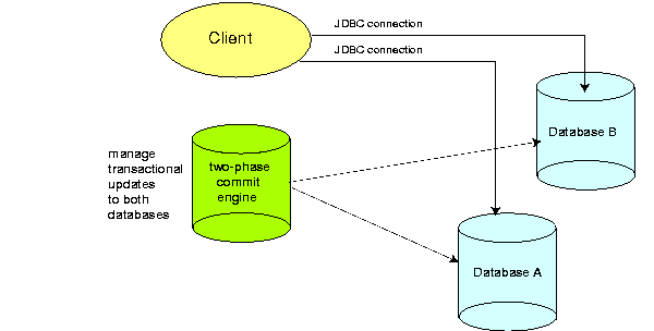

Two-Phase Commit
One of the primary advantages for a global transaction is the number database resources managed as a single unit within the transaction. If your global transaction involves more than one database resource, you must specify a two-phase commit engine, which is an Oracle9i database designated to manage the changes to all databases within the transaction. The two-phase commit engine is responsible for ensuring that when the transaction ends, all changes to all databases are either totally committed or fully rolled back.
On the other hand, if your global transaction has multiple server objects, but only a single database resource, you do not need to specify a two-phase commit engine. The two-phase commit engine is required only to synchronize the changes for multiple databases. If you have only a single database, single-phase commit can be performed by the transaction manager.
Your two-phase commit engine can be any Oracle9i database. It can be the database where your server object exists, or even a database that is not involved in the transaction at all. See "Configuring Two-Phase Commit Engine" for a full explanation of the two-phase commit engine setup.
Figure 17-1 shows two databases enlisted in the transaction and another database that is designated as the two-phase commit engine. Databases A and B are enlisted when a JDBC connection is opened, within a global transaction, to each database. The two-phase commit engine must be identified within the UserTransaction object and database links from the two-phase commit engine to each database involved in the transaction must be created. See "Configuring Two-Phase Commit Engine" on how to perform this setup.
When the global transaction ends, the two-phase commit engine ensures that all changes made to the databases A and B are committed or rolled back simultaneously.
Figure 17-1 Two-Phase Commit for Global Transactions
Text description of jta_jdbc.gif follows
When multiple databases are included in a global transaction, the changes to these resources must all be committed or rolled back at the same time. That is, when the transaction ends, the transaction manager contacts a coordinator--also known as a two-phase commit engine--to either commit or roll back all changes to all included databases. The two-phase commit engine is an Oracle9i database that is configured with the following:
In order to facilitate this coordination, you must configure the following:
  1. Designate an Oracle9i database as the two-phase commit engine.
  2. Configure fully-qualified public database links (using the CREATE DATABASE LINK command) from the two-phase commit engine to each database that may be involved in the global transaction. This is necessary for the two-phase commit engine to communicate with each database at the end of the transaction. These database link names must be included when binding the JTA DataSource (OracleJTADataSource) object.
  3. Bind a JTA DataSource (OracleJTADataSource) object for each database in the transaction. You must include the following in the bindds command:
    1. The JNDI bound name for the object
    2. The URL for creating a connection to the database
    3. The fully-qualified database link from the two-phase commit engine to this database
      Provide the fully-qualified database link name in the -dblink option of bindds for each individual database when binding that database's DataSource into the namespace.
