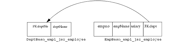

If the employee example included a one-to-many relationship, the abstract accessor methods would pass back and forth a Set or Collection of objects, each of which contains target bean local interface objects. When you have a "many" relationship, multiple records are being passed back and forth.
A department contains many employees. In this one-to-many example, the abstract accessor methods for the department retrieves multiple employees. Thus, the abstract accessor methods pass a Collection or a Set of employees, as follows:
public Collection getDeptEmployees(); public void setDeptEmployees(Collection deptEmpl);

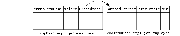

The one-to-one entity relationship is managed between the entity tables with a foreign key. Figure 4-1 demonstrates a one-to-one unidirectional relationship between the employee and address bean.
empl.jar and the application name is employee, then the table names are EmpBean_empl_jar_employee and AddressBean_empl_jar_employee.
<cmp-field> and <cmr-field> elements declared in the deployment descriptor.
EmpBean table are empno, empname, and salary. A foreign key is created called address, from the <cmr-field> declaration, that points to the primary key column of the AddrBean table.
AddressBean table are an auto-generated long primary key and columns for stree, city, state, and zip.
empno. The AddressBean is configured for an auto-generated primary key by specifying only <primkey-class> of java.lang.Object.

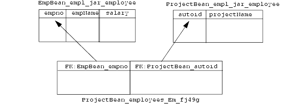

You cannot facilitate the one-to-many and many-to-many relationships using only a primary key and foreign key in the entity tables. To facilitate these relationships, the container creates an association table. The association table contains two columns, where each contains a foreign key to each of the entity tables in the relationship.
Figure 4-2 shows the tables that are created for the employee/project relationship. Each project can have multiple employees, and each employee can belong to several projects. Thus, the employee and project relationship is a many-to-many relationship. The container creates three tables to manage this relationship: the employee table, the project table, and the association table for both of these tables.
The association table contains a foreign key column that points to the employee table and a foreign key column that points to the project table. The column names of the association table are a concatenation of the entity bean name in <ejb-name> and its primary key name. If the primary key for the bean is auto-generated, then "autoid" is appended as the primary key name. For example, the foreign key that points to the employee table is the bean name of EmpBean, followed by the primary key name of empno, which results in the column name EmpBean_empno. The foreign key that points to the address table is the bean name of ProjectBean concatenated with autoid, because the primary key is auto-generated, which results in the column name ProjectBean_autoid.
The following is a demonstration of the association table for the employee/projects relationship. Employee 1 is assigned to projects a, b, and c. Project a involves employees 1, 2, and 3. The association table contains the following:

empl.jar and the application name is employee, then the table names are EmpBean_empl_jar_employee and ProjectBean_empl_jar_employee.
<cmp-field> elements declared in the deployment descriptor.
EmpBean table are empno, empname, and salary. The primary key is designated as the empno field.
ProjectBean table are autoid for an auto-generated primary key and a projectName column. The primary key is auto-generated because the <prim-key-class> is defined as java.lang.Object, and no <primkey-field> element is defined.
<cmr-field> definitions for each of the entity beans in the relationship. The format for the association table name consists of the following, separated by underscores: first bean name, its <cmr-field> to the second bean, second bean name, its <cmr-field> to the first bean, JAR file name, and application name. The rule of thirty characters also applies to this table name, as to the entity tables. Thus, the association table name for the employee/projects relationship is ProjectBean_employees_EmpBean_projects_empl_jar_employee. Because this name is over thirty characters, it is truncated to twenty-four characters, and then an underscore plus five characters of a hash code are added. Thus, the official association table would be something like ProjectBean_employees_Em_fj49g
autoid if auto-generated). In our example, the column names would be EmpBean_empno and ProjectBean_autoid. These columns are foreign keys to the entity tables that are involved in the relationship. The EmpBean_empno foreign key points to the employee table; the ProjectBean_autoid foreign key points to the projects table.

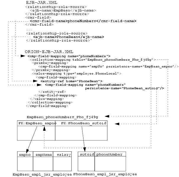

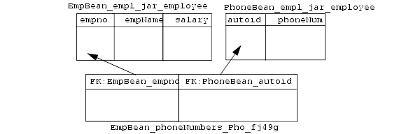

The following XML demonstrates how to configure a single employee who can have multiple phone numbers. You can add another source of the phone numbers table, such as department phone numbers, so that the department entity bean has a one-to-many relationship with the phone number entity bean. This is why the employee to phone numbers relationship is unidirectional.
The employee entity bean, EmpBean, defines a <cmr-field> element designating a Collection of phoneNumbers within the PhoneBean.
<relationships> <ejb-relation> <ejb-relation-name>Emp-Phone</ejb-relation-name> <ejb-relationship-role> <ejb-relationship-role-name>Emp-PhoneNumbers</ejb-relationship-role-name> <multiplicity>One</multiplicity> <relationship-role-source> <ejb-name>EmpBean</ejb-name> </relationship-role-source> <cmr-field> <cmr-field-name>phoneNumbers</cmr-field-name> <cmr-field-type>java.util.Collection</cmr-field-type> </cmr-field> </ejb-relationship-role> <ejb-relationship-role> <ejb-relationship-role-name>Phone-has-Emp</ejb-relationship-role-name> <multiplicity>Many</multiplicity> <relationship-role-source> <ejb-name>PhoneBean</ejb-name> </relationship-role-source> </ejb-relationship-role> </ejb-relation> </relationships>
The container maps this definition to the following:

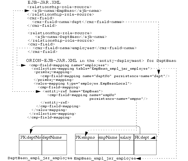

How you map relationship fields is dependent on the type of relationship:
Modify elements and attributes of the <entity-deployment> element in the orion-ejb-jar.xml file to explicitly map relationship fields.
The following XML shows the relevant elements and attributes for explicit mapping of a one-to-one relationship:
<entity-deployment name=" " location=" " table=" " data-source=" "><cmp-field-mapping name=" "><entity-ref home=" "><cmp-field-mapping name=" " persistence-name=" " /></entity-ref></cmp-field-mapping> </entity-deployment>
The following XML illustrates the relevant elements and attributes for explicitly identifying the association table for one-to-many or many-to-many:
<entity-deployment name=" " location=" " table=" " data-source=" "><cmp-field-mapping name=" "><collection-mapping table=" "><primkey-mapping><cmp-field-mapping name=" " persistence-name=" " /></primkey-mapping><value-mapping type=" "><cmp-field-mapping><entity-ref home=" "><cmp-field-mapping name=" " persistence-name=" "/></entity-ref></cmp-field-mapping></value-mapping></collection-mapping></cmp-field-mapping></entity-deployment>

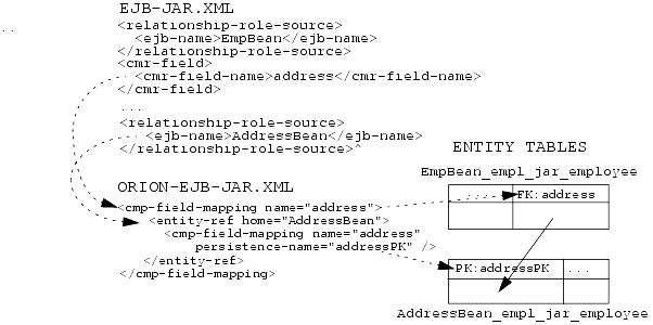

Figure 4-1 shows a one-to-one unidirectional relationship between an employee and an address. The employee table has a foreign key that points to the primary key of the employee. A one-to-one bidirectional relationship would add a foreign key to the address table that points to the employee.
<enterprise-beans> <entity> ... <ejb-name>EmpBean</ejb-name> <local-home>employee.EmpHome</local-home> <local>employee.Emp</local> <ejb-class>employee.EmpBean</ejb-class> ... <cmp-field><field-name>empNo</field-name></cmp-field> <cmp-field><field-name>empName</field-name></cmp-field> <cmp-field><field-name>salary</field-name></cmp-field> <primkey-field>empNo</primkey-field> <prim-key-class>java.lang.Integer</prim-key-class> ... </entity> <entity> ... <ejb-name>AddressBean</ejb-name> <local-home>employee.AddressHome</local-home> <local>employee.Address</local> <ejb-class>employee.AddressBean</ejb-class> ... <cmp-field><field-name>addressPK</field-name></cmp-field> <cmp-field><field-name>addressDescription</field-name></cmp-field> <primkey-field>addressPK</primkey-field> <prim-key-class>java.lang.Integer</prim-key-class> ... </entity> </enterprise-beans> <relationshipe> <ejb-relation> <ejb-relation-name>Emp-Address</ejb-relation-name> <ejb-relationship-role> <ejb-relationship-role-name>Emp-has-Address </ejb-relationship-role-name><multiplicity>One</multiplicity><relationship-role-source><ejb-name>EmpBean</ejb-name> </relationship-role-source> <cmr-field><cmr-field-name>address</cmr-field-name></cmr-field> </ejb-relationship-role> <ejb-relationship-role> <ejb-relationship-role-name>Address-has-Emp </ejb-relationship-role-name><multiplicity>One</multiplicity><relationship-role-source><ejb-name>AddressBean</ejb-name> </relationship-role-source> </ejb-relationship-role> </ejb-relation> </relationships
The EmpBean requires a foreign key to the AddressBean. Thus, the container modifies the <entity-deployment> element for the EmpBean to include a foreign key to the primary key of the AddressBean. The following mapping for this relationship is located in the orion-ejb-jar.xml file:
<entity-deployment name="EmpBean" location="emp/EmpBean"wrapper="EmpHome_EntityHomeWrapper2" max-tx-retries="3" table="emp" data-source="jdbc/OracleDS"><primkey-mapping> <cmp-field-mapping name="empNo" persistence-name="empno" /> </primkey-mapping> <cmp-field-mapping name="empName" persistence-name="ename" /> <cmp-field-mapping name="salary" persistence-name="sal" /><cmp-field-mapping name="address"><entity-ref home="AddressBean"><cmp-field-mapping name="address"persistence-name="addressPK" /></entity-ref></cmp-field-mapping>... </entity-deployment>
This mapping specifies:
<entity-deployment> attributes define the following:
name attribute: The name of the source bean is EmpBean.
location attribute: The JNDI location is emp/EmpBean.
table attribute: The database table in which the persistent data for this entity bean is stored is emp.
data-source attribute: The database in which this table resides is defined by the data source jdbc/OracleDS.
<cmp-field-mapping> elements identify the table columns and the persistent data to be stored in each: The columns in this table are empno, ename, sal, and address. The empno column contains the primary key, as defined in the EmpBean as empNo. The empName and salary CMP data are saved in the ename and sal columns. The address column is a foreign key that points to the primary key of the AddressBean table.
address foreign key points to the primary key of the AddressBean. The <cmp-field-mapping> for address describes this, as follows:
<cmp-field-mapping> name attribute identifies the <cmr-field> that was defined in the source bean. This is the column name for the foreign key called address in the emp table. However, it is not mapped to the primary key of the target table here.
<entity-ref> home attribute identifies the <ejb-name> of the target bean. The target in this example is the AddressBean. The container understands the entity table in which AddressBean is stored.
<cmp-field-mapping> name attribute maps the source foreign key to the primary key of the target table. Thus, this second name attribute is identical to the first--address, which is the foreign key of the EmpBean table. The persistence-name attribute identifies the primary key column name of the target bean. In this example, the primary key of the AddressBean table is the addressPK column.
In the original example, the container auto-generates a primary key for the target AddressBean table. For the auto-generated example, the second <cmp-field> mapping is mapped to an auto-generated primary key, known as autoid, as follows:
<cmp-field-mapping name="address" persistence-name="autoid" />
Figure 4-4 displays the relationship mapping of the EmpBean address foreign key to the AddressBean addressPK primary key.
In summary, an address column in the EmpBean_empl_jar_employee table is a foreign key that points to the primary key, addressPK, in the AddressBean_empl_jar_employee table. For the example in which the AddressBean has an auto-generated primary key, an address column in the EmpBean_empl_jar_employee table is a foreign key that points to the primary key, autoid, in the AddressBean_empl_jar_employee table.
Figure 4-3 shows a one-to-many unidirectional relationship between an employee and his/her phone numbers. Because this involves a "many" in the relationship, an association table is created. The association table is the same whether this is a unidirectional or bidirectional, or one-to-many or many-to-many relationship.
In the ejb-jar.xml file, the cardinality is defined in the <relationships> element. The container knows from this definition whether the relationship is one-to-many or many-to-many. In the orion-ejb-jar.xml file, the mapping of this relationship to an association table is described in a <collection-mapping> element. Because the cardinality is already known, only one entity in the relationship defines the <collection-mapping> element.
<collection-mapping> element as it receives back a Collection or Set of the target.
<collection-mapping> element with the association table specifications. The other entity bean has an empty <collection-mapping> element.
In the orion-ejb-jar.xml file for the employee example, the EmpBean <entity-deployment> element defines the <collection-mapping> element to designate a Collection of phone numbers. The <collection-mapping> element defines the association table.
<entity-deployment name="EmpBean" location="emp/EmpBean"wrapper="EmpHome_EntityHomeWrapper2" max-tx-retries="3" table="EmpBean_phoneNumbers_Pho8fj49g" data-source="jdbc/OracleDS"><primkey-mapping><cmp-field-mapping name="empNo" persistence-name="empno" /></primkey-mapping><cmp-field-mapping name="empName" persistence-name="ename" /> <cmp-field-mapping name="salary" persistence-name="sal" /><cmp-field-mapping name="phoneNumbers"><collection-mapping table="EmpBean_phoneNumbers_Pho8fj49g"><primkey-mapping><cmp-field-mapping name="empNo" persistence-name="EmpBean_empno" /></primkey-mapping><value-mapping type="employee.PhoneLocal"><cmp-field-mapping><entity-ref home="PhoneBean"><cmp-field-mapping name="phoneNumbers"persistence-name="PhoneBean_autoid"/></entity-ref></cmp-field-mapping></value-mapping></collection-mapping></cmp-field-mapping>... </entity-deployment>
<collection-mapping> element is contained within the <cmp-field-mapping> for phoneNumbers, which is the EmpBean <cmr-field> element definition. It defines the association table name in the table attribute, which currently defines the association table name as EmpBean_phoneNumbers_Pho8fj49g.
<primkey-mapping> and <value-mapping> elements respectively.
EmpBean_empno and PhoneBean_autoid.
<value-mapping> element specifies the target entity bean.
You can bypass an association table in the one-to-many bidirectional entity relationship. The "one" relationship has a primary key that points to the "many"; the "many" has a foreign key that points back. With both tables maintaining primary keys, and the "many" table maintaining a foreign key back to the "one" table, there is no need for an association table.
Figure 4-6 shows the department<->employee example, where each employee belongs to only one department and each department can contain multiple employees. The department table has a primary key. The employee table has a primary key to identify each employee and a foreign key to point back to the employee's department. If you want to find the department for a single employee, a simple SQL statement retrieves the department information from the foreign key. To find all employees in a department, the container performs a JOIN statement on both the department and employee tables and retrieves all employees with the designated department number.
This is not the default behavior. To have this type of relationship, do one of the following:
-DassociateUsingThirdTable=false on the OC4J.JAR startup options before deployment. Restart the OC4J instance.
<collection-mapping> element in the orion-ejb-jar.xml file.
To manipulate the <collection-mapping> element in the orion-ejb-jar.xml file, you modify the <entity-deployment> element for the "one" entity bean, which contains the Collection, as follows:
<collection-mapping> table attribute to be the "many" table. In this example, you would modify this attribute to be the EmpBean_empl_jar_employee table.
persistence-name attribute for each entity bean in the <collection-mapping> table as follows:
persistence-name of the <primkey-field> element should be the primary key of the source entity bean and the database column name of the foreign key in the target entity bean.
<value-mapping> element provides a pointer to the target bean--the "many" bean. Thus, the <entity-ref> home attribute should be the target entity bean name. In the second <cmp-field-mapping> element, the name attribute contains the <cmr-field> defined in the "one" entity bean in the orion-ejb-jar.xml file. The persistence-name attribute defines the primary key column of the "one" entity bean table.
Figure 4-7 demonstrates how the department/employee one-to-many bidirectional example is mapped without the use of an association table.
