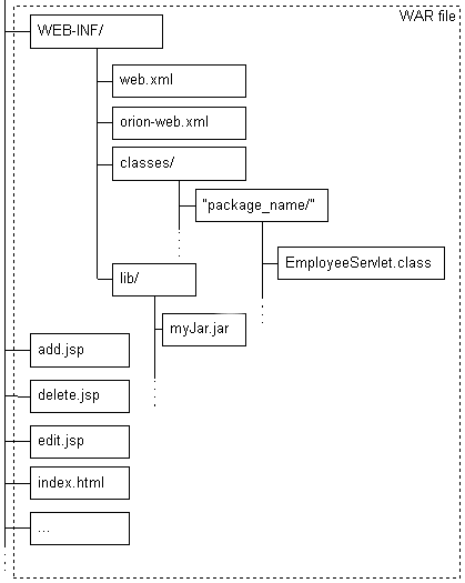

Figure 3-1, shows the directory structure under the application root directory for a typical Web application. In OC4J, the root directory is <app-name>/<web-app-name>, according to the application name and corresponding Web application name. The application name is defined in the server.xml file and mapped to a Web application name in the default-web-site.xml file, http-web-site.xml file, or other Web site XML file. (The default-web-site.xml file is for Oracle9iAS environments; http-web-site.xml is for OC4J standalone. See "The default-web-site.xml, http-web-site.xml, and Other Web Site XML Files".)
For easier application assembly and deployment, it is advisable to set up your Web application files in a pattern that is required for the deployment WAR file. The general rules are as follows:
root attribute of the <web-app> element of the xxx-web-site.xml file for a particular Web site.
<app_name>/<web-app-name>/WEB-INF/classes directory, in subdirectories named after packages as appropriate. For example, if you have a servlet called EmployeeServlet in the employee package, then the class file should be as follows:
<app_name>/<web-app-name>/WEB-INF/classes/employee/EmpServlet.class
<app_name>/<web-app-name>/WEB-INF/lib.

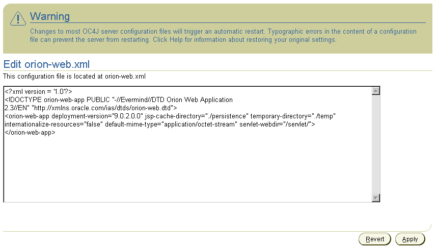

The file global-web-application.xml, in the OC4J configuration files directory, is the descriptor for the OC4J "global Web application". The elements in this file define the default behavior of an OC4J Web application.
There is also, for each Web application, an application-specific web.xml file and an optional deployment-specific orion-web.xml file. Both of these files should be in the application /WEB-INF directory. Use of web.xml is standard, according to the Servlet 2.3 specification. Elements defined for the orion-web.xml file are a superset of those defined for web.xml, adding elements for OC4J-specific features. The orion-web.xml DTD is also used for global-web-application.xml--the two files support the same elements.
On deployment of a Web application, OC4J generates an orion-web.xml file, using the settings from the parent global-web-application.xml file. You can then update orion-web.xml as desired to override default values. You can also package orion-web.xml as part of your EAR file if you want to specify resource mappings or OC4J-specific configuration.
The global-web-application.xml, orion-web.xml, and web.xml files all support a <web-app> element, which has many subelements. As you can see in "Default global-web-application.xml File", the global-web-application.xml file typically defines defaults for many settings of the <web-app> element and its subelements. The <web-app> element and subelements in the web.xml file are for desired settings specific to an application. When deploying an application, the <web-app> element and subelements in orion-web.xml are for overriding any settings of the web.xml <web-app> element for this particular deployment.
OC4J-specific features are supported through the <orion-web-app> element and its many subelements in the global-web-application.xml and orion-web.xml files. The <web-app> element in these files is a subelement of <orion-web-app>. This element and its subelements in orion-web.xml can override global-web-application.xml settings of OC4J features for a particular application deployment.

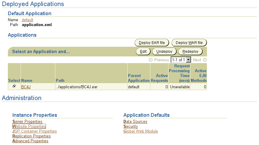

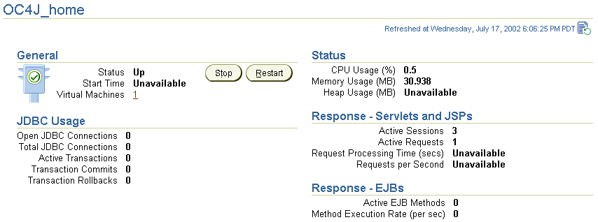

From the Oracle9iAS Application Server Instance Home Page (the main page you reach when you first access Enterprise Manager), you can drill down to any of the running OC4J instances by selecting the name of the instance (OC4J_home, for example) in the System Components table. Enterprise Manager will display the OC4J Home Page for that instance.
Figure 3-2 and Figure 3-3 show portions of the OC4J Home Page for the OC4J_home instance.
The OC4J Home Page enables you to access instance properties. In particular, relating to topics covered in this manual, note the following:

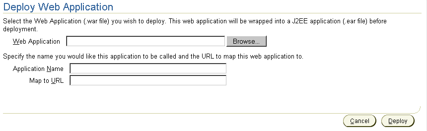

Figure 3-4 shows the key portion of the Enterprise Manager Deploy Web Application Page, which is the page for deploying a WAR file. Drill down to this page from any OC4J Home Page, such as the page for OC4J_home, by clicking the Deploy WAR file button.
In the Deploy Web Application Page, click the Browse button to select a WAR file to deploy. Then specify the application name along with a URL to map to the application. Specifying the application name will result in an entry in the server.xml file, and there will also be a resulting entry in the default-web-site.xml file mapping the application name to the URL. This is accomplished through the application and root attributes of a <web-app> subelement of the <web-site> element. In addition, the mod_oc4j.conf configuration file for the Oracle HTTP Server mod_oc4j Apache mod is updated with appropriate mount points.

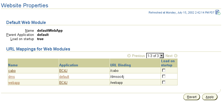

Figure 3-5 shows the key portion of the Enterprise Manager Website Properties Page for an OC4J instance. Drill down to this page from the OC4J Home Page, such as the page for OC4J_home, by selecting Website Properties under Instance Properties in the Administration section of the page.
Among other things, this page enables you to specify whether each application should be loaded automatically when OC4J starts. (Otherwise, an application is not loaded until the first request for it.) This corresponds to the load-on-startup attribute of the appropriate <web-app> subelement of the <web-site> element in the default-web-site.xml file. (For general information about loading an application at OC4J startup, see "Servlet Preloading".)

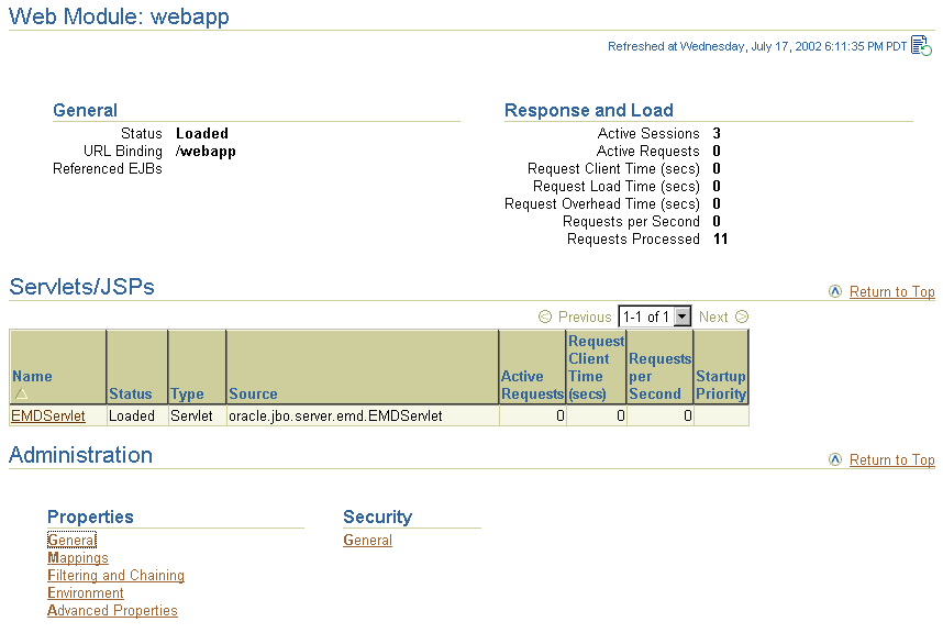

From the Website Properties Page, drill down to the Web Module Page for any particular Web module. In the sample page above, for example, you can select webapp to drill down to the Web Module Page for that module.
Figure 3-6 shows the key portion of the Enterprise Manager Web Module Page for the module webapp. Drill down to the Web Module Page for a particular module by selecting the module name in the Website Properties Page.
From the Web Module Page, you can access several categories of Web module properties through the following links under Properties in the Administration section of the page:

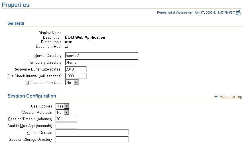

Figure 3-7 and Figure 3-8 show portions of the Enterprise Manager Web Module Properties Page for a particular module. Drill down to this page by selecting General under Properties in the Administration section of the Web Module Page.
Correspondence of these settings to orion-web.xml elements is as follows.
In the General section:
servlet-webdir attribute of the <orion-web-app> element.
temporary-directory attribute of the <orion-web-app> element.
default-buffer-size attribute of the <orion-web-app> element.
file-modification-check-interval attribute of the <orion-web-app> element.
get-locale-from-user attribute of the <orion-web-app> element.
In the Session Configuration section:
cookies attribute of the <session-tracking> element, which is a subelement of the <orion-web-app> element.
autojoin-session attribute of the <session-tracking> element.
<session-timeout> subelement of the <session-config> subelement of the standard <web-app> element. You can use a <web-app> subelement under <orion-web-app> in orion-web.xml for deployment-specific overrides of <web-app> settings in the application web.xml file.
cookie-max-age attribute of the <session-tracking> element.
cookie-domain attribute of the <session-tracking> element.
persistence-path attribute of the <orion-web-app> element.

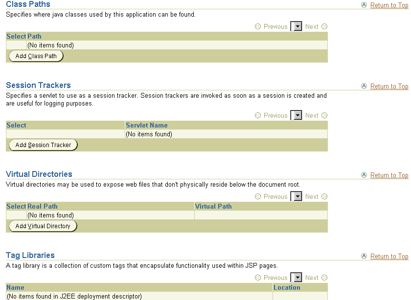

In the Class Paths section:
path attribute of a <classpath> subelement of the <orion-web-app> element.
In the Session Trackers section:
servlet-name attribute of a <session-tracker> element, which is a subelement of the <session-tracking> element.
In the Virtual Directories section:
real-path and virtual-path attributes of a <virtual-directory> subelement of the <orion-web-app> element.
In the Tag Libraries section:

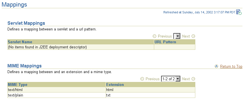

Figure 3-9 and Figure 3-10 show portions of the Enterprise Manager Web Module Mappings Page for a particular module. Drill down to this page by selecting Mappings under Properties in the Administration section of the Web Module Page.
These settings all correspond to subelements of the <web-app> element in the web.xml file. You can use a <web-app> subelement under <orion-web-app> in orion-web.xml for deployment-specific overrides of these settings. You can use the Advanced Properties Page for this purpose--see "Enterprise Manager Web Module Advanced Properties Page".
In the Servlet Mappings section:
<servlet-name> and <url-pattern> subelements of a <servlet-mapping> subelement of the <web-app> element.
In the MIME Mappings section:
<mime-type> and <extension> subelements of a <mime-mapping> subelement of the <web-app> element.

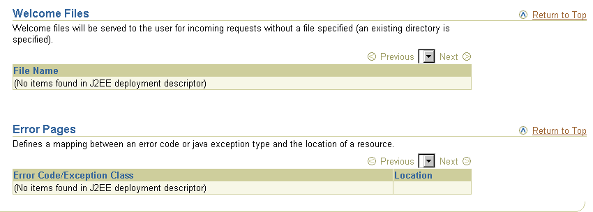

In the Welcome Files section:
<welcome-file> subelement of the <welcome-file-list> subelement of the <web-app> element.
In the Error Pages section:
<error-code> and <location> subelements of an <error-page> subelement of the <web-app> element.
<exception-type> and <location> subelements of an <error-page> subelement of the <web-app> element.

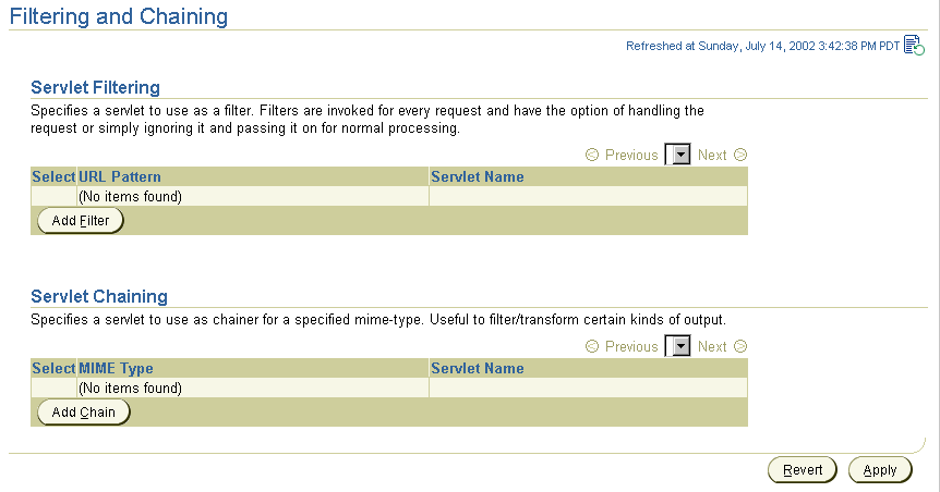

Figure 3-11 shows the key portion of the Enterprise Manager Web Module Filtering and Chaining Page for a particular module. Drill down to this page by selecting Filtering and Chaining under Properties in the Administration section of the Web Module Page.
In the Servlet Filtering section:
servlet-name and url-pattern attributes of a <servlet-filter> subelement of the <orion-web-app> element. The servlet name you specify is tied to a servlet class through its standard configuration in the web.xml file.
In the Servlet Chaining section:
servlet-name and mime-type attributes of a <servlet-chaining> subelement of the <orion-web-app> element. The servlet name you specify is tied to a servlet class through its standard configuration in the web.xml file.

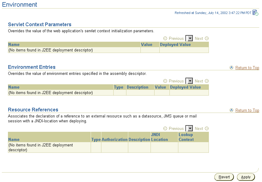

Figure 3-12 shows most of the Enterprise Manager Web Module Environment Page for a particular module. Drill down to this page by selecting Environment under Properties in the Administration section of the Web Module Page.
This page shows settings for servlet context parameter overrides, environment entry overrides, and resource references. The overrides indicate settings in the orion-web.xml file that override corresponding web.xml settings.
Correspondence of these settings to web.xml and orion-web.xml elements is as follows.
In the Servlet Context Parameters section:
web.xml <context-param> elements that can be overridden for this deployment, along with any Deployed Value overrides that have already been specified. Enter a new value in the Deployed Value column to specify a new override. Doing so creates a <context-param-mapping> entry in orion-web.xml.
In the Environment Entries section:
web.xml <env-entry> elements that can be overridden for this deployment, along with any Deployed Value overrides that have already been specified. Enter a new value in the Deployed Value column to specify a new override. Doing so creates an <env-entry-mapping> entry in orion-web.xml.
In the Resource References section:
web.xml and orion-web.xml settings. The name and type of a resource reference correspond to <res-ref-name> and <res-type> subelements under a <resource-ref> subelement of the <web-app> element in the web.xml file. The JNDI location and lookup context correspond to settings under a <resource-ref-mapping> element and its <lookup-context> subelement, under the <orion-web-app> element in the orion-web.xml file.
Figure 3-13 shows the key portion of the Enterprise Manager Web Module Advanced Properties Page for a particular module. Drill down to this page by selecting Advanced Properties under Properties in the Administration section of the Web Module Page.
You can use the Web Module Advanced Properties Page to edit orion-web.xml or global-web-application.xml for any settings not covered by the previously discussed Enterprise Manager Web module pages. (In fact, you can make any orion-web.xml or global-web-application.xml entries through the Advanced Properties Page; however, it is advisable to use the previously described pages whenever possible because of their error handling and reporting features.)
