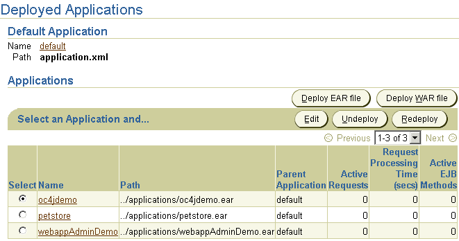

Figure 2-3 shows the Deployed Applications section. In this section, you can deploy applications using the Deploy EAR file or Deploy WAR file buttons. After deployment, you can modify configuration for each application. See "Configuring the Pet Store Web Application Demo" or "Deploying Applications" for more information.

To deploy your application, drill down to the OC4J Home Page and scroll to the Deployed Applications section. Figure 2-3 shows this section.

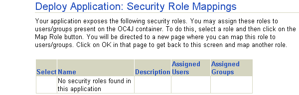

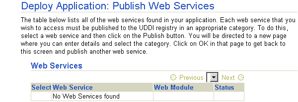

Both of these buttons start an eight-step application deployment wizard, which guides you through deploying an application. In the case of the WAR file, the application.xml file is created for the Web application. Whereas, you must create the application.xml file within the EAR file. Thus, deploying a WAR file is an easier method for deploying a Web application.
Figure 2-7 shows the eight steps required for application deployment:
The first page is an introduction to these steps. It reminds you to provide an EAR file with any OC4J-specific XML configuration files, if necessary. It also outlines some of the other steps in the deployment process.
Click the Next button to go to the next step in the wizard deployment process.

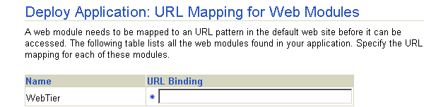

Map any Web modules in your application to a specific URL for its servlet context. All OC4J servlet contexts must be prefixed with a slash "/". When you try to access any Web applications, you provide the host, port, and Web context.
For all Web modules, your URL mapping for this module includes the URL you bind in this screen. Thus, for the URL http://<host>:<port>/url_name, provide /url_name in the URL mapping screen of the wizard.

Map any security roles defined in your application to existing users and groups. If you have defined a security role within your application, you can map this role to a security group or role. You do not define security groups and users in this screen. Users and groups are obtained from your user manager.
For more information on security roles, see both the Chapter 8, "Security", the Security chapters in the Oracle9iAS Containers for J2EE Services Guide and the Oracle9iAS Containers for J2EE Enterprise JavaBeans Developer's Guide and Reference.
Publish any Web services defined in your application. This feature requires the UDDI registry. Web services are not installed with a core install.
If you have defined any Web services, they are shown in the following screen:
If you want to publish these Web services, then click on the Publish button. This leads you through the process of publishing your Web services. When finished, it brings you back to this screen.

You can remove a J2EE Web application from the OC4J Web server by selecting the application in the Applications section of the OC4J Home Page (see Figure 2-3) and clicking the Undeploy button. This command removes the deployed J2EE application and results in the following:
You can also undeploy applications with the DCM command. See Appendix B, "DCM Command-Line Utility (dcmctl)" for directions.
