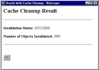

Oracle9iAS Web Cache Manager provides an easy-to-use interface for invalidating cached objects. The message mechanics are much like the telnet example. The advantage of using Oracle9iAS Web Cache Manager is that the administrator is isolated from the intricacies of the HTTP and XML formats, and consequently, there is less chance for error. The administrator need only specify which objects to invalidate and how invalid those objects should be.
To invalidate documents with Oracle9iAS Web Cache Manager:
The Content Invalidation page appears in the right pane.
To preview the list of documents:
Oracle9iAS Web Cache displays the Invalidation Preview Results message box, which lists the documents that meet the invalidation criteria. Oracle9iAS Web Cache Manager lists only those documents that are valid. Although the cache may contain documents that are expired or that have been invalidated, those documents are not listed.
If the documents listed are those that you want to invalidate, then continue with the next step. If they are not, then modify the invalidation criteria and preview the list again.
Oracle9iAS Web Cache processes the invalidation request, and returns a Cache Cleanup dialog box that the shows the invalidation status and the number of objects invalidated. For example:
For prefix-based invalidations that require Oracle9iAS Web Cache to traverse a complex directory structure, invalidation can take some time. Therefore, do not choose Submit again until the Cache Cleanup Result dialog box appears. Creating a queue of invalidation requests can degrade the performance of Oracle9iAS Web Cache.
In a cache cluster environment, if Propagate Invalidation is enabled, Oracle9iAS Web Cache sends the invalidation requests to one cluster member who acts as the invalidation coordinator. The coordinator propagates the invalidation requests to other cluster members. When the invalidation has been completed for all cluster members, Oracle9iAS Web Cache returns a Cache Cleanup box, that lists, for each cluster member, the cache name, the status of the invalidation request, and the number of objects invalidated.

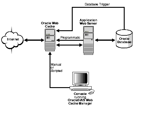

Invalidation requests can originate from a Web site's underlying application logic or from the content management application used to design Web pages.
Oracle9iAS Web Cache ships with the following Application Program Interfaces (APIs) that you can implement:
jawc.jar for a Java invalidation API
jawc.jar is located in the $ORACLE_HOME/webcache/jlib directory on UNIX and ORACLE_HOME\webcache\jlib directory on Windows
wxvutil.sql and wxvappl.sql for a PL/SQL invalidation API
wxvutil.sql and wxvappl.sql are located in the $ORACLE_HOME/webcache/examples directory on UNIX and ORACLE_HOME\webcache\examples directory on Windows
Oracle9iAS Web Cache also ships with the following sample code for generating invalidation requests. You can create invalidation tools following these examples and use them with your applications.
Invalidate.java for Java source
invalidate.c for C source
invalidate.sh for a shell script that invalidates documents with a telnet session
nvalidate.sql for PL/SQL source
These files are located in the $ORACLE_HOME/webcache/examples directory on UNIX and ORACLE_HOME\webcache\examples directory on Windows.
Database triggers are procedures that are stored in the database and activated ("fired") when specific conditions occur, such as adding a row to a table. You can use triggers to send invalidation requests. To do this, use the UTL_TCP Oracle supplied package to send invalidation requests through database triggers.
Many Web sites use scripts for uploading new content to databases and file systems. A large online book retailer, for instance, might run a PERL script once a day in order to bulk load new book listings and price changes into its catalog database. The retailer would want the price changes and availability listings to be reflected in the item views and search results currently cached in Oracle9iAS Web Cache. To achieve this, the PERL script can be modified such that when the bulk loading operation has completed, the script will send an invalidation request to the cache invalidating all catalog views and search results. (Note that the invalidation request need not list every individual search page or item view that might be effected by the data change.) The performance assurance feature of Oracle9iAS Web Cache enables administrators to use broad brush strokes when invalidating content, making it safe to invalidate all catalog content even if only a fraction of that content has changed.
