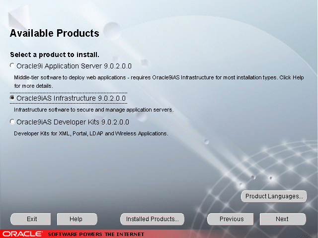

Oracle9iAS Infrastructure needs to be installed in a separate Oracle home, preferably on a separate host from any Oracle9iAS installations. Do not install Oracle9iAS Infrastructure into an existing:
Oracle9iAS Infrastructure installs Oracle9iAS Metadata Repository, Oracle Internet Directory, Oracle9iAS Single Sign-On, and Oracle Management Server. Oracle9iAS Infrastructure is required for all of the Oracle9iAS middle-tier applications except when installing the J2EE and Web Cache install type without single sign-on or clustering. Prior to installing an instance of either Portal and Wireless, Business Intelligence and Forms, or Unified Messaging, you must install and configure the Oracle9iAS Infrastructure somewhere in your network.

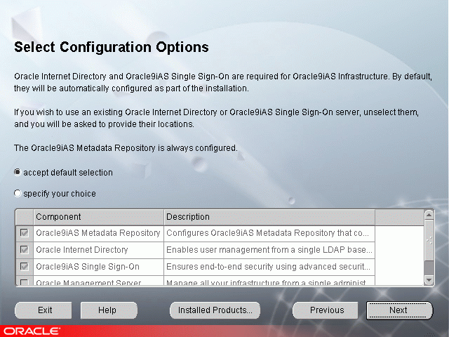

The Select Configuration Options screen offers two configuration options
If you deselect a component here, the installer installs it, but does not configure or start it. After installation, the installer starts the selected Oracle9iAS component. If you decide to use that component at a later time, then launch the Oracle Enterprise Manager Home Page to configure that component.
If you would like to configure Oracle Internet Directory and Oracle9iAS Single Sign-On on separate hosts:
If you plan to install copies of Oracle Internet Directory on different hosts to form a directory replication network, configure Oracle9iAS Single Sign-On with only one of the Oracle Internet Directory copies. The remaining copies of Oracle Internet Directory must not be associated with any Oracle9iAS Single Sign-On configuration. Refer to the Oracle Internet Directory Administrator's Guide for more information.
Oracle9iAS Metadata Repository is always configured and started during Oracle9iAS Infrastructure installation.

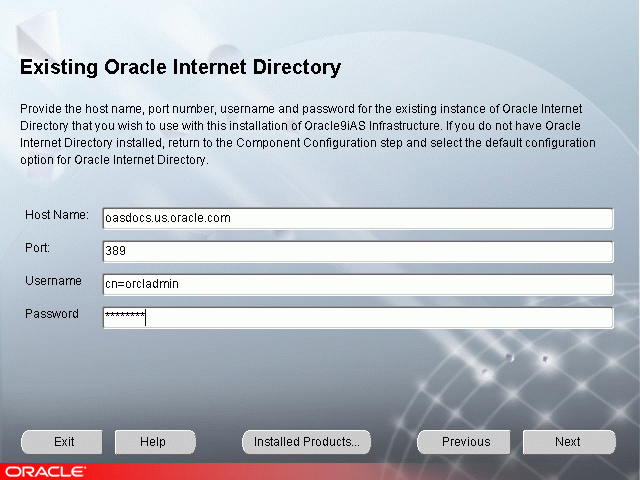

Enter the host name and port number for the existing instance of Oracle Internet Directory that you wish to use with this installation of Oracle9iAS Infrastructure and click Next.
This screen appears if you have unchecked the configuration of Oracle Internet Directory on the Component Configuration and Startup screen.
If you do not have Oracle Internet Directory installed, you must install it through the Oracle9iAS Infrastructure installation before proceeding with this installation.

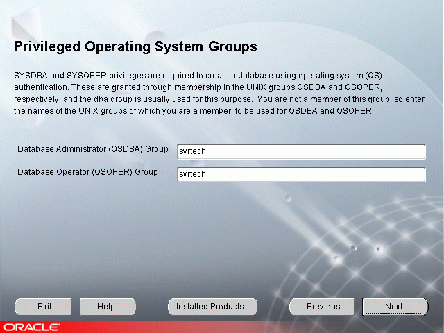

oracle account is not a member of the dba group. Enter the database administrator and operator group name and click Next.
The Privileged Operating System Groups screen allows you to enter the database administrator and operator group name for installation of the Oracle9iAS Metadata Repository. For more information regarding privileged group names, refer to Section 2.5.5.3, "UNIX Group Names for Privileged Groups". The installer detects and defaults to the your OS group.

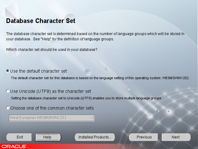

Choose from one of the three following character sets for your database:

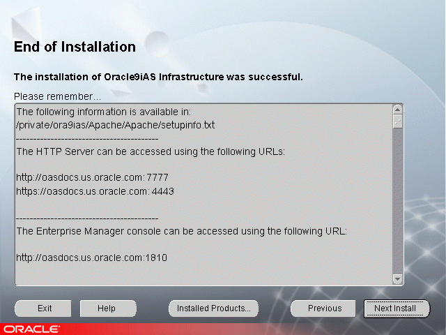

The End of Installation screen appears at the end of the installation process. It notifies you whether the installation was successful or unsuccessful and provides information about accessing the Oracle9iAS instance.
The End of Installation screen displays the URL and port number for accessing the Oracle HTTP Server page and the Oracle Enterprise Manager Web Site. The default Oracle HTTP Server page is the Oracle9iAS Welcome page. The Oracle9iAS Welcome page provides links to demonstrations and information about new features.
