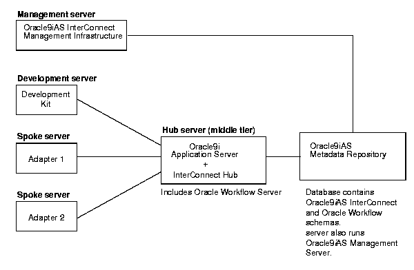

C.1.2.1 Topology 1 (with Oracle9iAS)
Running Oracle9iAS InterConnect with Oracle9iAS is the recommended topology. In this topology, you need to do the following:
The following figure shows the recommended topology. Oracle9iAS InterConnect hub uses the Oracle9iAS Infrastructure database as the hub database.
Figure C-1 Recommended Topology with Oracle9iAS
Text description of install_oaia.gif follows

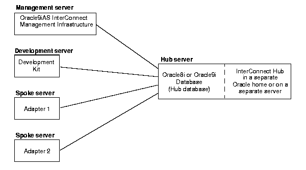

C.1.2.2 Topology 2 (with Oracle database)
In this topology, you need an Oracle8i or Oracle9i database. Oracle9iAS InterConnect uses the database as the hub database to store its schemas. In this topology, you need to install Oracle9iAS InterConnect hub (Oracle Workflow included) on the same server as the Oracle database or on a different server. If you are installing Oracle9iAS InterConnect hub on the same server as the database, you must install it in an Oracle home separate from the Oracle database.
The following figure shows such a topology.
Figure C-2 Topology with Oracle9i Database
Text description of install_oai2.gif follows

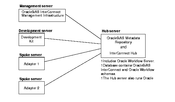

C.1.2.3 Topology 3 (with Oracle9iAS Metadata Repository)
This topology is similar to Topology 1 in that Oracle9iAS InterConnect uses the Oracle9iAS Infrastructure database as the hub database. The difference between the two topologies is that in Topology 3, you install only the Infrastructure from Oracle9iAS; you do not install Oracle9iAS installation types in the middle tier. You can use this topology if you do not wish to use Oracle9iAS.
Figure C-3 Topology with Oracle9iAS Metadata Repository
Text description of install_oai3.gif follows
