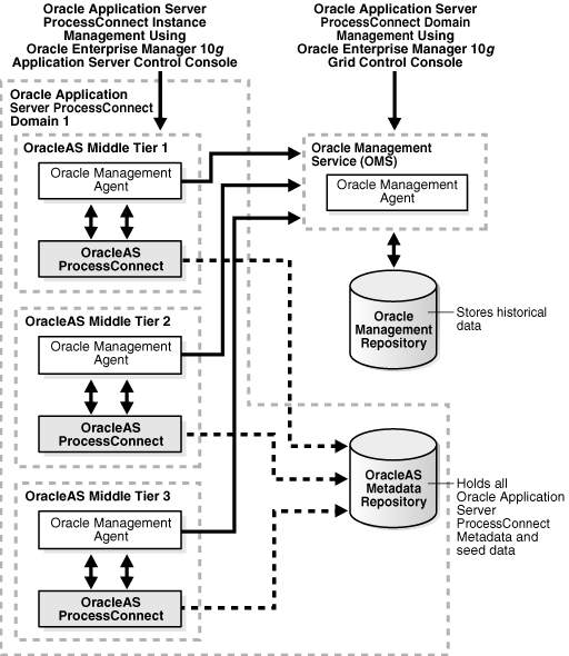

Figure 18-1 provides a high-level overview of how Oracle Application Server ProcessConnect (called OracleAS ProcessConnect) is managed.
Figure 18-1 Monitoring and Management with Oracle Enterprise Manager 10g
Description of ipusr050.gif follows
In Figure 18-1, Oracle Application Server ProcessConnect is installed on three Oracle Application Server middle tiers that connect to an Oracle Application Server Metadata Repository. Each Oracle Application Server middle tier is running the Oracle Management Agent. Oracle Management Agents monitor and perform administrative functions on managed targets. All three Oracle Application Server middle tiers are configured to use the Oracle Management Service as their management infrastructure. The Oracle Management Service works with all Oracle Management Agents in processing monitoring and job information.
The set of all Oracle Application Server ProcessConnect middle-tier instances that connect to the same Oracle Application Server Metadata Repository and that repository is called an Oracle Application Server ProcessConnect Domain. You can have multiple Oracle Application Server ProcessConnect Domains, all managed through the same Oracle Management Service.
The Oracle Management Service uses its own Oracle Management Agent. The Oracle Management Agent running in each middle tier uploads Oracle Application Server ProcessConnect specific metric details to the Oracle Management Server repository. In Figure 18-1, you can perform two types of system management tasks by connecting to either the Oracle Application Server middle tier (and using the Oracle Enterprise Manager 10g Application Server Control Console) or the Oracle Management Service (and using the Oracle Enterprise Manager 10g Grid Control Console).
The Oracle Enterprise Manager 10g Application Server Control Console and Oracle Enterprise Manager 10g Grid Control Console are designed to work together to perform the following tasks:

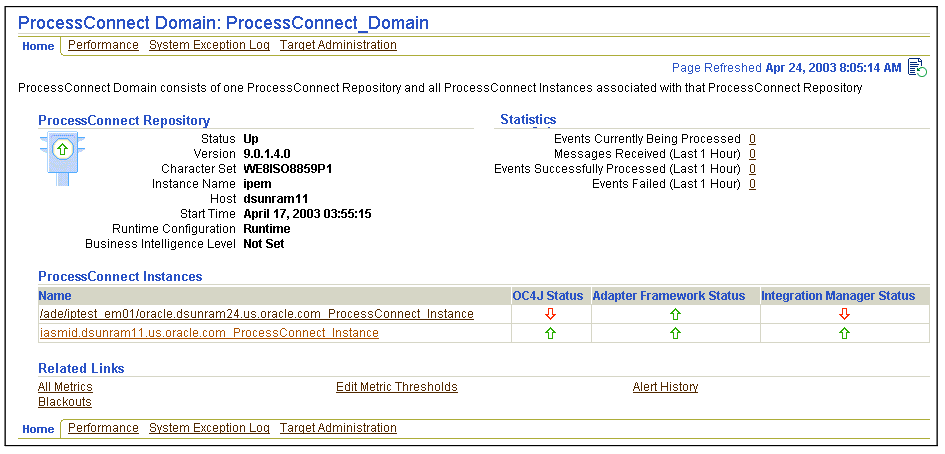

You can perform the following remote monitoring tasks from the Oracle Enterprise Manager 10g Grid Control Console:
  • Manage and monitor multiple Oracle Application Server ProcessConnect domains
  • Identify which Oracle Application Server ProcessConnect middle-tier instances are part of which Oracle Application Server ProcessConnect domain
  • Identify which Oracle Application Server Metadata Repository is used by which Oracle Application Server ProcessConnect middle-tier instance or Oracle Application Server ProcessConnect domain
  • Monitor Oracle Application Server ProcessConnect components running in multiple Oracle9i Application Server middle-tier instances. For example, in Figure 18-1 you can monitor the running status and metric details for the Oracle Application Server ProcessConnect components running in all three Oracle Application Server middle-tier instances.
  • Monitor the status of inbound and outbound events for all instances, including details about the number of events currently being processed, the number of successfully processed events, and the number of events that failed to process
  • Manage alerts and notifications. You can edit thresholds for different metrics, and register for notification on different alerts and alert levels. For example, you can raise a critical alert when the average transformation processing time takes more than 5000 milliseconds and send an e-mail to an appropriate contact such as an administrator when this alert happens.
    Oracle Application Server ProcessConnect monitors metric statistics (for example, average transformation time). Custom thresholds can be set for any given metric (for example, the critical threshold for average transformation time is 3000 milliseconds). When a given metric violates a set threshold, an alert is initiated. Response actions and notifications can be registered with alerts (for example, send e-mail when a critical alert is raised for average transformation time).
  • Change the server from which the Oracle Application Server ProcessConnect domain is managed.
  • Monitor adapter framework activity, including details about adapters, applications, and trading partners
  • Identify which Oracle Application Server middle-tier instance is using a particular adapter, integrating with a particular endpoint, or both.
  • Monitor integration manager activity, including performance details about the sizes of transformations and translations and the amount of time they take to complete

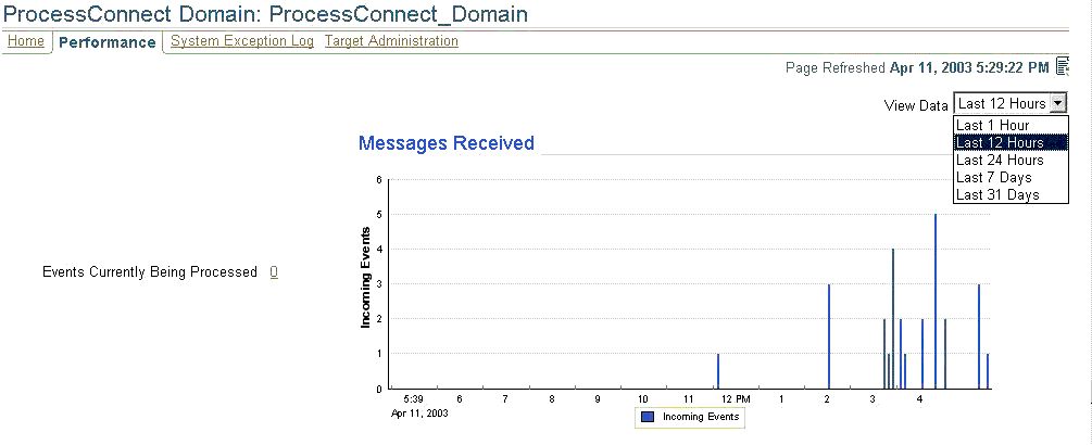

  • Analyze historical data. (For example, you can see the rate of incoming events over a period of 21 days.)
  • Log into an individual Oracle Enterprise Manager 10g Application Server Control Console to perform instance specific administration tasks such as modifying Oracle Application Server ProcessConnect configuration details or starting individual Oracle Application Server ProcessConnect components.

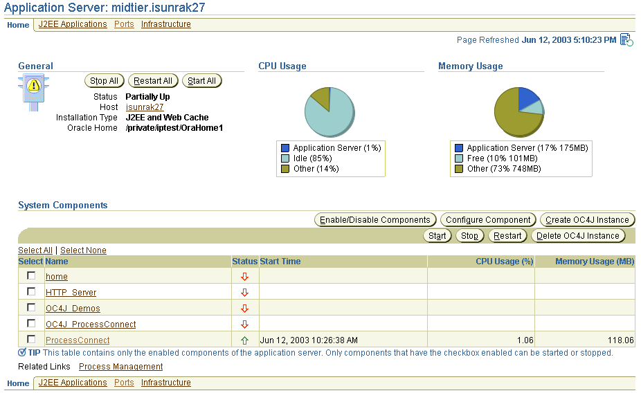

    The Oracle Application Server home page appears:
Description of oem_homepage.gif follows
  1. Select a management task to perform and see the referenced section for instructions.
Table 18-1 Management Tasks
Page Elements Management Task See Also
Name list of System Components section Select the Oracle Application Server ProcessConnect middle-tier instance to monitor and administer from the Oracle Enterprise Manager 10g Application Server Control Console "Oracle Application Server ProcessConnect Monitoring and Administration Tasks" for an overview of Oracle Application Server ProcessConnect tasks you can perform
Process Management link (at bottom) Select Process Management to view and edit the opmn.xml file. "Oracle Process Management Notification Management"
Ports link (at bottom) Select Ports to view ports assigned to Oracle Application Server ProcessConnect and other Oracle Application Server components "Oracle Application Server ProcessConnect Port Management"
Infrastructure link (at bottom) Select Infrastructure to review and modify details about the relationship between this Oracle Application Server instance and the rest of your enterprise. "Oracle Application Server and Enterprise Relationship Management"

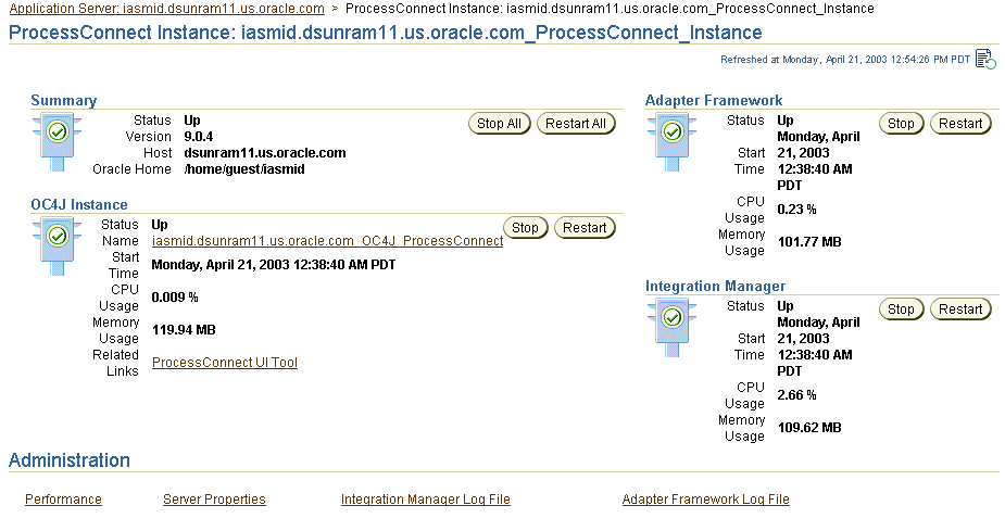

Figure 18-2 shows the Oracle Application Server ProcessConnect middle-tier instance page that displays after selecting the specific instance in Step 2. You can perform the following monitoring and administration tasks.
Figure 18-2 Oracle Application Server ProcessConnect Middle-Tier Instance Page
Description of oem_standalone.gif follows
Table 18-2 identifies the tasks that you can perform. These tasks are further described in the online help available by clicking Help in the top right corner of each page.
Table 18-2 Oracle Enterprise Manager 10g Application Server Control Console Monitoring and Administration Tasks
Summary section View an overall status of the integration manager, adapter framework, and OC4J instance components on this middle-tier instance. For the overall status to display as Up, all three components must be running.
Summary section Click Stop All to stop the integration manager, adapter framework, and OC4J instance together.
Summary section Click Restart All to restart the integration manager, adapter framework, and OC4J instance together.
Adapter Framework, Integration Manager, or OC4J Instance section Click Stop to stop a specific component (either integration manager, adapter framework, or OC4J instance). Each component has its own Stop button.
Adapter Framework, Integration Manager, or OC4J Instance section Click Restart to restart a specific component (either integration manager, adapter framework, or OC4J instance). Each component has its own Restart button.
Adapter Framework Log File link (at bottom) Click to access a page from which to view adapter framework log files.

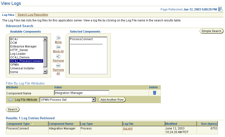

18.2.1.1 Oracle Application Server ProcessConnect Log Files
Oracle Application Server components such as Oracle Application Server ProcessConnect generate log files describing all types of events, including startup and shutdown details, errors, warning messages, access details on HTTP requests, and so on. You can view adapter framework and integration manager log files for Oracle Application Server ProcessConnect (for this example, integration manager logs are selected).
  1. Ensure that you followed the instructions in "Oracle Application Server ProcessConnect Monitoring and Administration Tasks" to access the page for viewing log files.
    The View Logs page appears.
Description of oem_logs.gif follows
  1. Select components for which to generate log details in the Available Components list.
  2. Use the Move arrows to move selected components to the Selected Components list.
  3. Click Search.
    A list of log files appears in the Results table.
  4. Click a specific log to view in the Log File column.

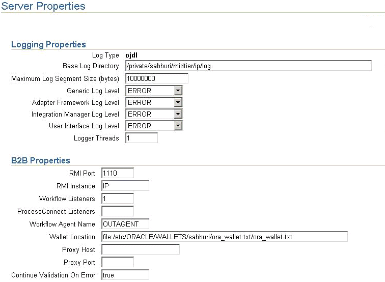

18.2.1.2 Oracle Application Server ProcessConnect Middle-Tier Instance Configuration Parameters
You can edit parameters settings for logging levels, security, number of role threads, trading partner (B2B) properties, and so on. These parameters also display in a file called tip.properties. However, Oracle recommends that you edit these parameters only through the Server Properties page. Do not edit these parameters by accessing the tip.properties file from the directory path location and using an ASCII editor. Figure 18-3 shows the upper portion of the page for viewing and editing configuration parameters.
Figure 18-3 Oracle Application Server ProcessConnect Middle-Tier Instance Configuration Parameters Page
Description of oem_sa_serv1.gif follows
See Also:
The online help for a description of parameters you can edit, their range of values, and the default values

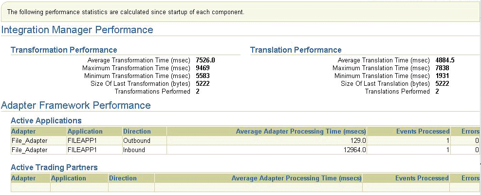

18.2.1.3 Oracle Application Server ProcessConnect Middle-Tier Instance Performance
You can view details about integration manager and adapter framework performance in a specific Oracle Application Server ProcessConnect middle-tier instance, including:
  • Transformation details, such as the average time to process a transformation, the maximum and minimum times to process a transformation, the size of the last transformation processed, and the number of transformations performed since the integration manager was started
  • Translation details, such as the average time to process a translation, the maximum and minimum times to process a translation, the size of the last translation processed, and the number of translations performed since the integration manager was started
  • Active application and trading partner details, such as the adapter used, the application name, the direction of the adapter interaction, the average adapter processing time, number of events processed, and number of event errors occurring since the adapter framework was started.
Figure 18-4 shows the performance page for a specific Oracle Application Server ProcessConnect middle-tier instance.
Figure 18-4 Oracle Application Server ProcessConnect Middle-Tier Instance Performance Page
Description of oem_sa_perf.gif follows

18.3.1 Oracle Application Server ProcessConnect Monitoring Tasks
Figure 18-5 shows the Oracle Enterprise Manager 10g Grid Control Console main page that displays after selecting an Oracle Application Server ProcessConnect middle-tier domain in Step 5. You can perform the following monitoring tasks.
Figure 18-5 Oracle Application Server ProcessConnect Domain Main Page
Description of oem_central1.gif follows
Tables for two types of alerts can also appear on this page:
  • Host Alerts that provide details for this host (such as if the amount of available space for a file system exceeds a specific limit)
  • Alerts that provide details for Oracle Application Server ProcessConnect middle-tier instances using this metadata repository (such as an event failing to process)
Table 18-3 identifies the tasks that you can perform. These tasks are described in detail in the online help available by clicking Help in the top right corner of each page.
Table 18-3 Oracle Enterprise Manager 10g Grid Control Console Management Tasks
Performance link Click to view overall event performance for all Oracle Application Server ProcessConnect middle-tier instances using this metadata repository.
See Also: "Oracle Application Server ProcessConnect Domain Event Performance" for additional details
System Exception Log link Click to view errors for all Oracle Application Server ProcessConnect instances using this metadata repository, including the error severity, the component that failed, the specific error message, and the time of error occurrence.
Target Administration link Click to view a list of Oracle Application Server ProcessConnect instances using this metadata repository. One of these instances can be selected to manage this Oracle Application Server ProcessConnect domain. A Oracle Application Server ProcessConnect domain consists of a single metadata repository and all of the Oracle Application Server ProcessConnect instances that use it. The Oracle Management Agent of each instance also displays.
Statistics section View specific details about all Oracle Application Server ProcessConnect instances using this metadata repository, including events currently being processed, the number of incoming events received in the last hour, the number of successfully processed events in the last hour, and the number of events that failed to process in the last hour (integration manager was unable to process them).
Integration Manager Status section Click to view integration manager performance details for a specific Oracle Application Server ProcessConnect middle-tier instance.
See Also: "Integration Manager Performance"
Adapter Framework Status section Click to view adapter framework performance details for a specific Oracle Application Server ProcessConnect middle-tier instance.
See Also: "Adapter Framework Performance"
ProcessConnect Repository section View the following details about the metadata repository:
  • Current status (either Up or Down)
  • Metadata repository version
  • The character set of the metadata repository database
  • Metadata repository database instance name
  • Name of host on which the metadata repository is installed
  • Time at which the metadata repository was last started
  • Name of the deployed configuration in the runtime environment (Named Runtime for this example)
  • Business intelligence data gathering setting for the deployed configuration (either High, Medium, or Low)
See Also: Chapter 16, " Creating and Deploying a Configuration" for details about configurations
ProcessConnect Instances section Lists the Oracle Application Server ProcessConnect middle-tier instances using this metadata repository. Click to view a specific Oracle Application Server ProcessConnect middle-tier instance and the status of its OC4J, integration manager, and adapter framework components.
See Also: "Oracle Application Server ProcessConnect Middle-Tier Instance Page" for additional details
Related Links section Provides links to related Oracle Enterprise Manager 10g topics.

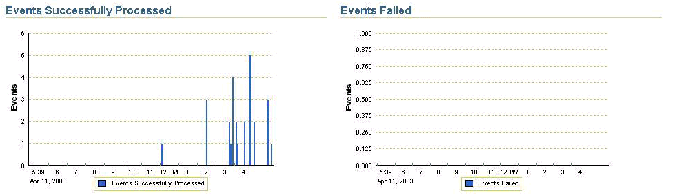

18.3.2 Oracle Application Server ProcessConnect Domain Event Performance
You can view the performance details in graphical charts for all Oracle Application Server ProcessConnect middle-tier instances using this metadata repository, including the following:
  • Number of events currently being processed
  • Number of events raised and messages received
  • Number of events successfully processed
  • Number of events that failed to process
The View Data list in the upper right corner of the page enables you to select a specific time period over which to view event performance. Figure 18-6 and Figure 18-7 show this page.
Figure 18-6 Performance Page (Part 1 of 2)
Description of oem_perf1.gif follows
Figure 18-7 Performance Page (Part 2 of 2)
Description of oem_perf2.gif follows

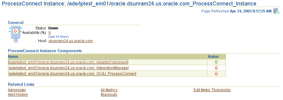

18.3.3 Oracle Application Server ProcessConnect Middle-Tier Instance Page
You can view details about the Oracle Application Server ProcessConnect middle-tier instances that use this metadata repository, including the following:
  • Status of the Oracle Application Server ProcessConnect middle-tier instances
  • Percentage of time the Oracle Application Server ProcessConnect middle-tier instance has been available in the last day
  • Name of the host on which the Oracle Application Server ProcessConnect middle-tier instances is installed
  • The Oracle Application Server ProcessConnect middle-tier instance components, each of which provide links to pages that describe the following details:
    • The adapter framework pages that provide details about adapters used, adapter interaction directions, active applications, active trading partners, events processed, adapter processing times, and number of errors
    • The integration manager pages that provide details about events processed, and graphical charts describing historical data, translation and transformation performance, including average processing time, time to process the last transformation or translation, the size of the last transformation or translation, and the number of transformations or translations performed since integration manager and adapter framework startup, respectively
    • The Oracle Enterprise Manager 10g OC4J page
Figure 18-8 shows the page that lists each Oracle Application Server ProcessConnect middle-tier instance. Click a specific component in the ProcessConnect Instance Components column to view the details described previously.
Figure 18-8 Oracle Application Server ProcessConnect Middle-Tier Instance Page
Description of oem_instance.gif follows
