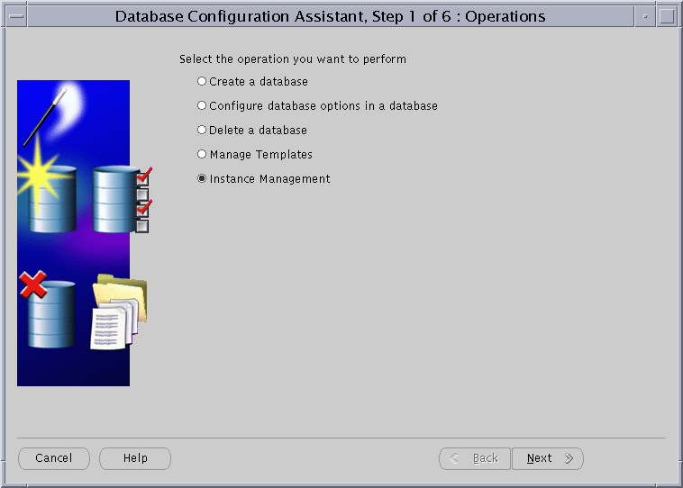

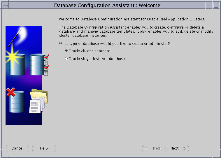

dbca in the bin directory in $ORACLE_HOME on UNIX, or on Windows NT and Windows 2000, choose Start > Programs > Oracle - HOME_NAME > Configuration and Migration Tools > Database Configuration AssistantThe DBCA wizard starts and displays the Welcome page for Real Application Clusters shown in Figure 8-1.
Note: If the Welcome page for Real Application Clusters does not display, then the DBCA was unable to:
To resolve this, refer to your vendor's operating system-dependent documentation to correct the problem and restart the DBCA. |

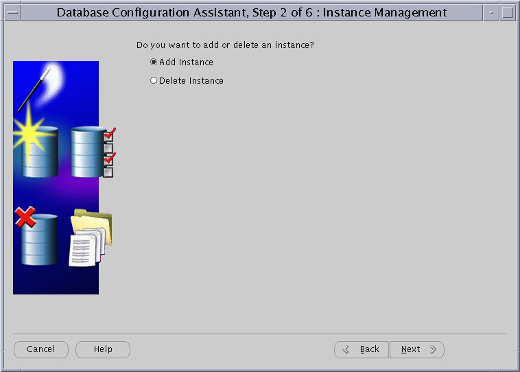

After you click Next, the DBCA displays the Instance Management page shown in Figure 8-3.

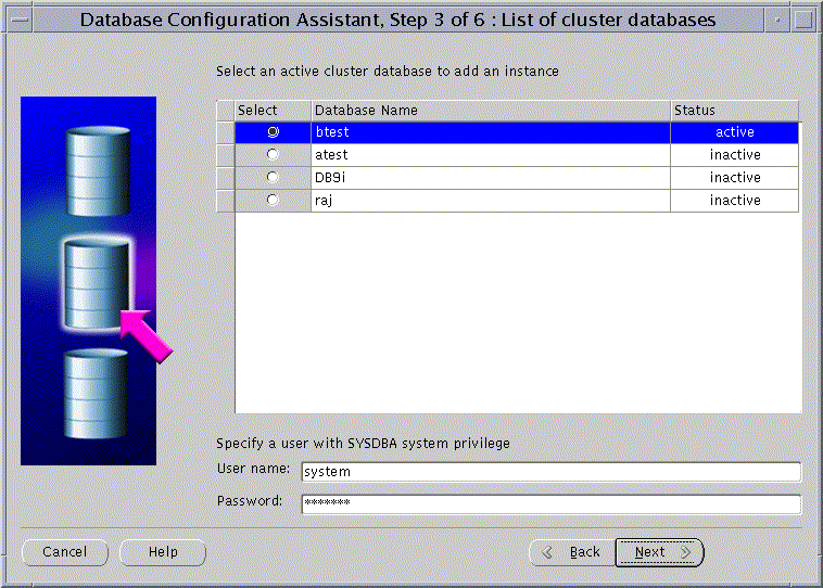

After you click Next, the DBCA displays the List of Cluster Databases page that shows the databases and their current statuses, such as ACTIVE, or INACTIVE, as shown in Figure 8-4.

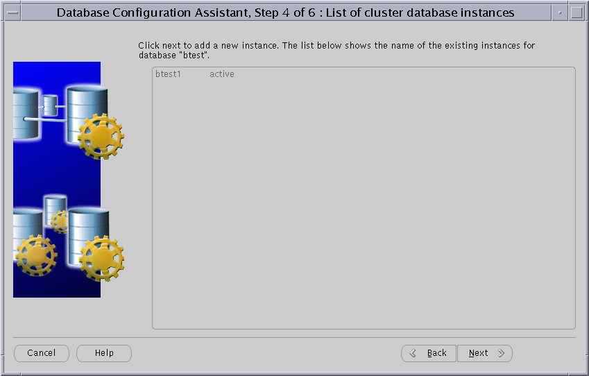

After you click Next, the DBCA displays the List of Cluster Database Instances page showing the names of the instances for the Real Application Clusters database that you selected as shown in Figure 8-5.

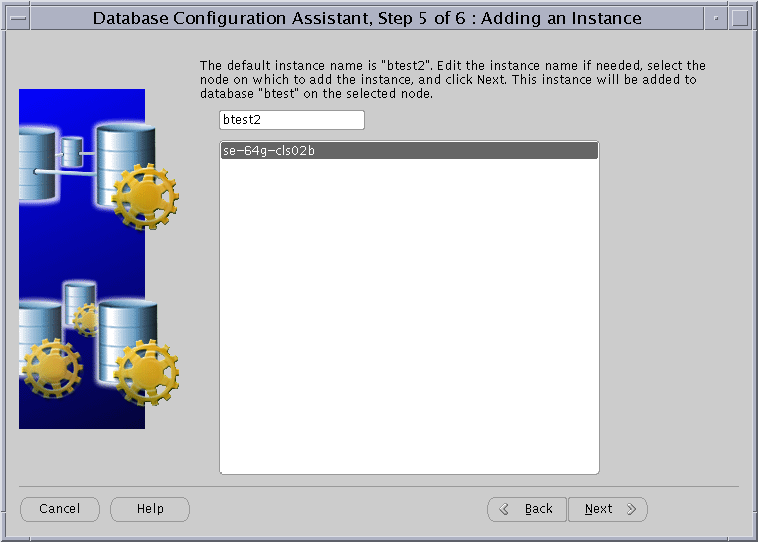

After you click Next, the DBCA displays the Adding an Instance page shown in Figure 8-6.

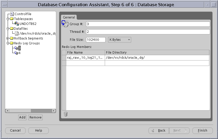

After you click Next, the DBCA displays the Database Storage page as shown in Figure 8-7.

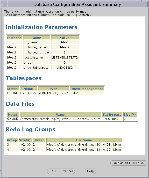

After you click Finish, the DBCA displays a Summary dialog similar to the dialog in Figure 8-8.
If you click OK, then the DBCA displays a progress dialog that shows the DBCA performing the instance addition operation. During this operation the DBCA adds the instance and creates the instance's Oracle Net configuration. When the DBCA completes the instance addition operation, the DBCA displays a dialog asking whether you want to perform another operation. Click No to exit the DBCA, or click Yes and the DBCA displays the Operations screen shown in Figure 8-3.
If you click No and continue the instance addition operation, then at this point you have accomplished the following:

After you click Next, the DBCA displays the Instance Management page shown in Figure 8-9.

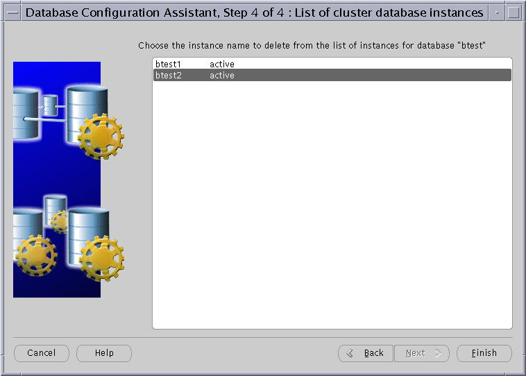

After you click Next, the DBCA displays the List of Cluster Database Instances page shown in Figure 8-11. The List of Cluster Database Instances page shows the instances associated with the Real Application Clusters database that you selected and the status of each instance.

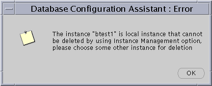

If you select the local instance, then the DBCA displays an Error dialog as shown in Figure 8-12.

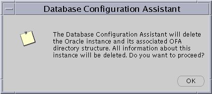

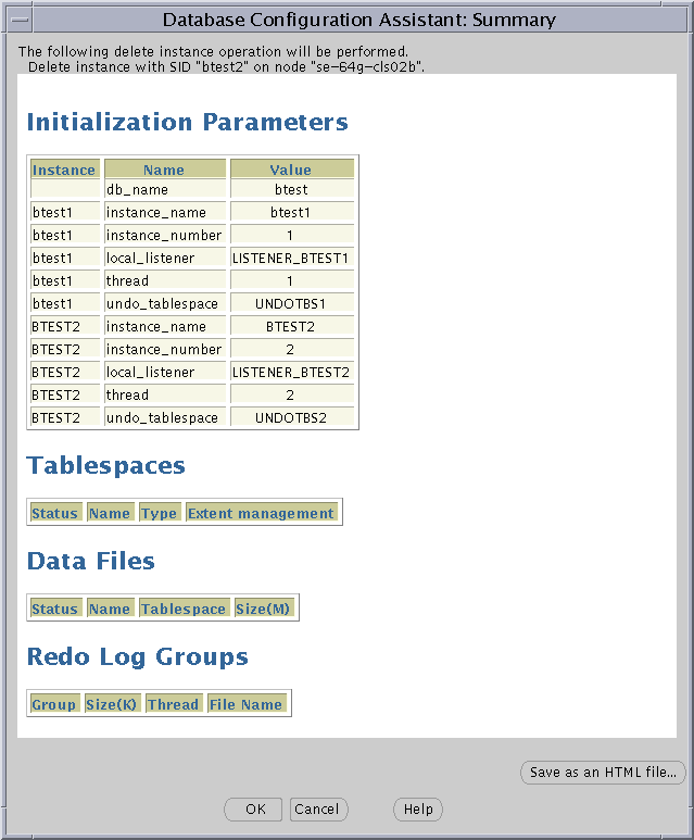

If you click OK, then the DBCA displays a Confirmation dialog similar to the dialog in Figure 8-14.
After you click OK, the DBCA displays a progress dialog showing that the DBCA is performing the instance deletion operation. During this operation the DBCA removes the instance and the instance's Oracle Net configuration. When the DBCA completes this operation, the DBCA displays a dialog asking whether you want to perform another operation. Click No and exit the DBCA or click Yes to perform another operation. If you click Yes, then the DBCA displays the Operations page shown in Figure 8-3.
At this point, you have accomplished the following:
