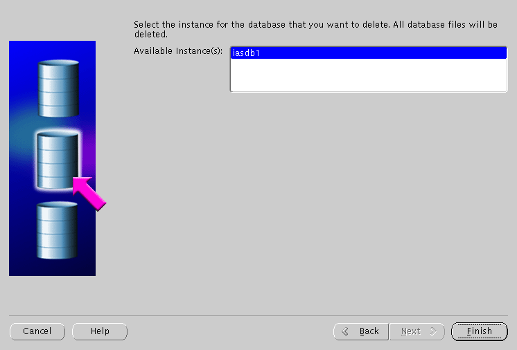

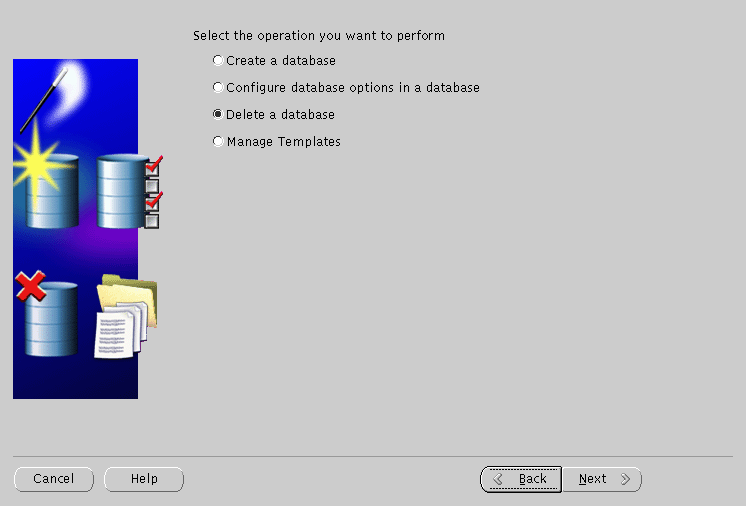

To delete a database with the DBCA:
The DBCA Welcome page appears. Click Next.
Based on your system configuration you may see the following screens:
Click OK to complete the deletion of the database and its associated files, or click Cancel to stop the operation.
When you click OK, the DBCA continues the operation and deletes all the associated instances for this database.

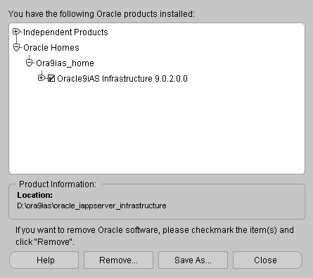

The Inventory screen appears when you click Deinstall Products on the Welcome screen, or Installed Products on any screen.
The Inventory screen displays all the components installed in Oracle home.
The Inventory screen contains the following:

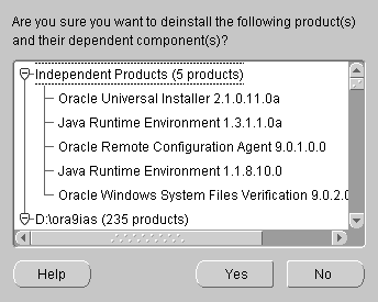

The Confirmation screen lists all the components selected for deinstallation in the Inventory screen. Scroll down the screen to verify selected components.
Note: Oracle Universal Installer does not delete all the files and directories during deinstallation. Remove remaining files manually. |
The following buttons appear on the Confirmation screen:

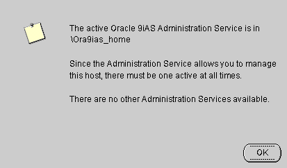

This screen presents one of the following messages:
Ora9ias_home. There are no other Administration Services available.
This message appears when there is only one Oracle9iAS installation on the host and you are about to deinstall it.
Ora9ias_home. You may select one of the Administration Services below to become the active one.
This message appears when there are multiple Oracle9iAS installations on the host and you are about to deinstall the primary installation. You can select one of the remaining Oracle9iAS installations which will then become the primary installation and the new location for the Oracle9iAS Administration Service.
