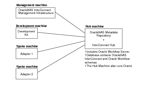

You can run Oracle9iAS InterConnect in three different topologies.
Running Oracle9iAS InterConnect with Oracle9iAS is the recommended topology. In this topology, you need to do the following:
The following figure shows the recommended topology. Oracle9iAS InterConnect hub uses the Oracle9iAS Infrastructure database as the hub database.

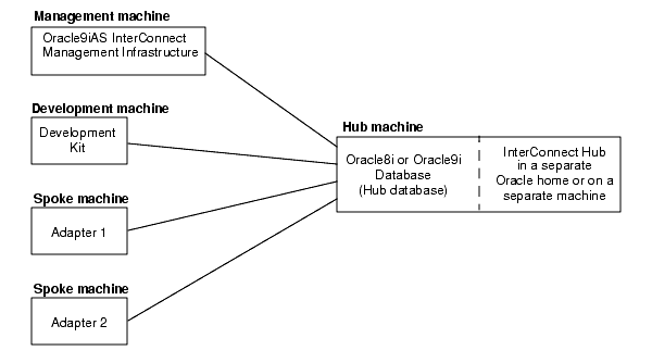

In this topology, you need an Oracle8i or Oracle9i database. Oracle9iAS InterConnect uses the database as the hub database to store its schemas. In this topology, you need the following:
The following figure shows such a topology.

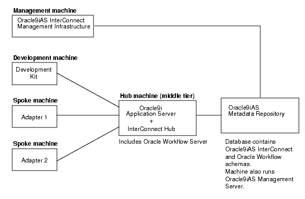

This topology is similar to Topology 1 in that Oracle9iAS InterConnect uses the Oracle9iAS Infrastructure database as the hub database. The difference between the two topologies is that in Topology 3, you install only the Infrastructure from Oracle9iAS; you do not install Oracle9iAS installation types in the middle tier. You can use this topology if you do not wish to use Oracle9iAS.
