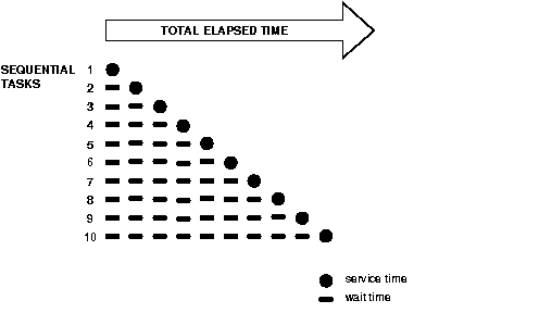

Figure 1-1 illustrates ten independent sequential tasks competing for a single resource as time elapses.
In the example shown in Figure 1-1, only task 1 runs without waiting. Task 2 must wait until task 1 has completed; task 3 must wait until tasks 1 and 2 have completed, and so on. Although the figure shows the independent tasks as the same size, the size of the tasks will vary.
In parallel processing with multiple resources, more resources are available to the tasks. Each independent task executes immediately using its own resource and no wait time is involved.

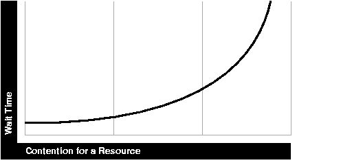

While the service time for a task may stay the same, wait time will lengthen with increased contention. If many users are waiting for a service that takes one second, the tenth user must wait 9 seconds. Figure 1-2 shows the relationship between wait time and resource contention. In the figure, the graph illustrates that wait time increases exponentially as contention for a resource increases.

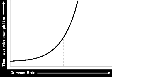

Figure 1-3 shows the relationship between time to service completion and demand rate. The graph in the figure illustrates that as the number of units requested rises, the time to service completion increases.
To manage this situation, you have two options:

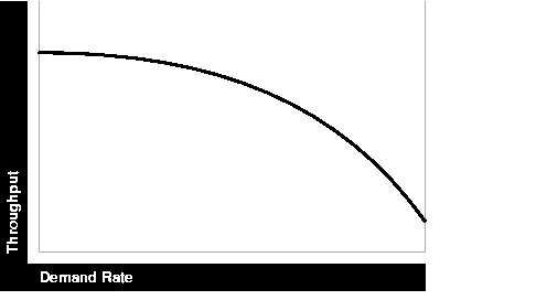

Excessive demand increases response time and reduces throughput, as illustrated by the graph in Figure 1-4.
If the demand rate exceeds the achievable throughput, then determine through monitoring which resource is exhausted and increase the resource, if possible.

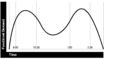

You also need to determine variances in the load. For example, users might access the system heavily between 9:00am and 10:00am and then again between 1:00pm and 2:00pm, as illustrated by the graph in Figure 1-5. If your peak load occurs on a regular basis, for example, daily or weekly, the conventional wisdom is to configure and tune systems to meet your peak load requirements. The lucky users who access the application in off-time will experience better response times than your peak-time users. If your peak load is infrequent, you may be willing to tolerate higher response times at peak loads for the cost savings of smaller hardware configurations.
