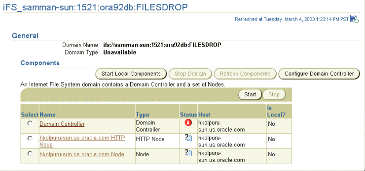

  4. From the Application Server Home page, click the name of the Oracle Files domain you want to manage.
    The Oracle Files top-level page appears, showing the status of the domain controller and the set of nodes that belong to the domain. The green checkmark in the Status column means the component has been started.
    Text description of oem02.gif follows.
    Some operations are performed on local domain components, while others are performed on the entire domain.
    • To start all the components on the local middle tier machine, click Start Local Components.
    • To start a single component, select it and click Start.
    • To stop a single component, select it and click Stop.
    • To stop the entire domain, click Stop Domain. This action stops everything, including the local and remote components. The presence of the Stop Domain button indicates that the domain is running.
    • To refresh the entire domain, click Refresh Components.
    • You can also migrate the domain controller from another host to the local host. See "Migrating the Domain Controller" in the next section for more information.
    If a component's selection button is greyed out, that component is not located on the local host.

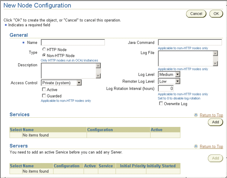

Creating a Regular Node Configuration
  1. From the Configuration section on the Oracle Files top-level page, click Node Configurations.
  2. On the Node Configurations page, decide whether to create a new node from scratch or to base it on the properties of an existing node.
    • To create the node from scratch, click Create.
    • To base the node on an existing node, select that node's checkbox and click Create Like.
    In both cases, the New Node Configuration page appears. If you selected Create Like, the properties have been filled in with those of the selected existing node.
    Text description of newnode.gif follows.
  3. Enter or change the node information:
    • Name of the node.
    • Type of the node; select Non-HTTP Node.
    • Default services for the node. For each, the node configuration records:
      • Service name.
      • Which service configuration object provides the service's configuration properties.
      • Whether the service is currently active. Inactive services are not automatically started by the node.
    • The node's default servers. For each, the node configuration records:
      • Server name.
      • Which server configuration object provides the server's configuration parameters.
      • Whether the server is currently active. Inactive servers are not automatically loaded by the node.
      • Name of the service against which the server should operate.
      • Java thread priority of the server.
      • Whether the server is automatically started once loaded.
  4. Click OK.
