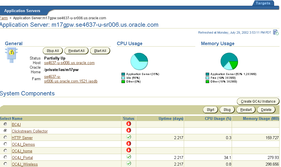

10.2.1.2 Starting and Stopping Components from the Oracle Enterprise Manager
You can start these components from the Oracle Enterprise Manager:
  1. Navigate to the Instance Home Page on the Enterprise Manager Web site.
  2. In the General section of the Instance Home Page, click Start All, Stop All, or Restart All. In the System Components section, review the status of each component and confirm it was started or stopped.
See the Oracle9i Application Server Administrator's Guide for further information, such as starting and stopping components using commands and dependencies for starting and stopping components.

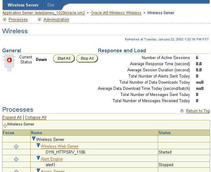

10.3 Managing the Wireless Server
You use the Wireless Server tab to view the performance of the server and the processes.
Figure 10-2 The Wireless Server Tab
Text description of orv_wsrv.gif follows.
The Wireless Server tab is divided into sections called General, Response and Load, Processes, and Administration.
The Response and Load section displays the overall performance of the Wireless Server. The Processes section includes a table that lists the following process types:

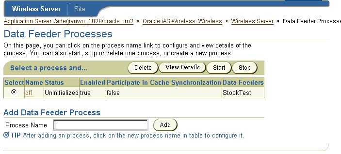

These process types, which represent the top-level of the Wireless server, display as hyperlinks in the Processes table; by clicking one, you drill down to screens that enable you to manage the processes themselves. For example, clicking the Data Feeder hyperlink in the Processes table enables you to navigate to the processes screen, which lists the current data feeder processes.
The processes screen includes a table that lists each processes by name and notes the current status for each process, such as started (running), stopped (suspended), or uninitialized (the process has never been run). The processes screen for the alert engine, data feeder, messaging server, and performance monitor process types also include columns that indicate if a process has been enabled, or if it participates in cache synchronization with other processes. In these columns, true indicates that the process has either been enabled or can participate in cache synchronization with other processes; a value of false indicates that the process has not been enabled or cannot participate in cache synchronization with other processes.
In addition to noting the status of a process, you can use the processes screen to perform such functions as adding, editing, deleting, or starting and stopping a selected a process.
In the Wireless Server tab, you can view all processes by clicking Expand All. Likewise, you can hide all the processes by clicking Collapse All. If you view and manage many processes, you can create a view that isolates these processes of one type by clicking Focus.

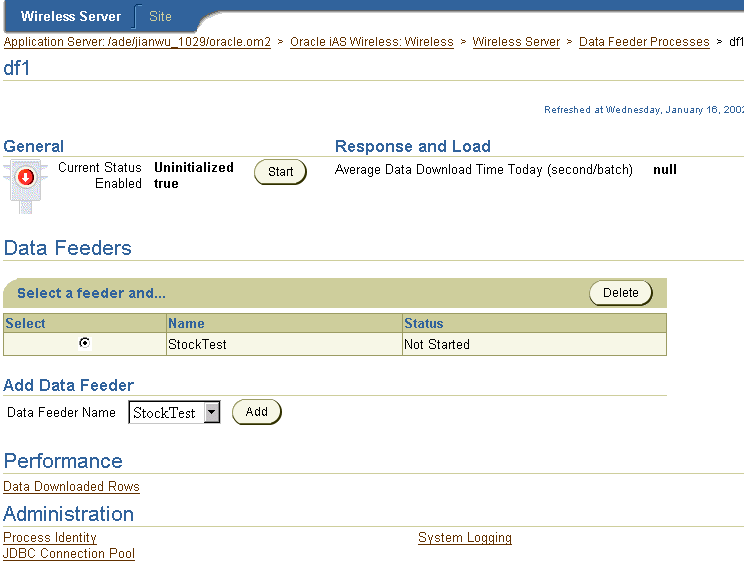

10.3.1 Accessing a Wireless Process
By selecting a process and clicking the View Details button (or by clicking the process itself, which is represented as hyperlink), you can drill down to a detail screen for the selected process. From the detail screen, you can start and stop the process, view its performance statistics, and configure it. A detail screen includes sections entitled General, Response and Load, Performance, and Administration.
Figure 10-3 The Processes Screen
Text description of orv_pcss.gif follows.
From the General section, you can start or stop the selected performance monitor process by clicking the Start or Stop buttons. Next to the Current Status label, the General section displays the current state of the selected process, noting it as started stopped, or uninitialized. The General sections of the detail screens for the alert engine, data feeder, messaging server, and performance monitor process types include the Enabled label. If true displays next to this label, then the has been enabled; if false displays, then the process has not been enabled.
The Response and Load section of the detail screen lists the overall performance statistics for the selected process. The Performance section lists performance metrics types for the selected process. From the Administration section of the screen, you can configure and administer the selected process.

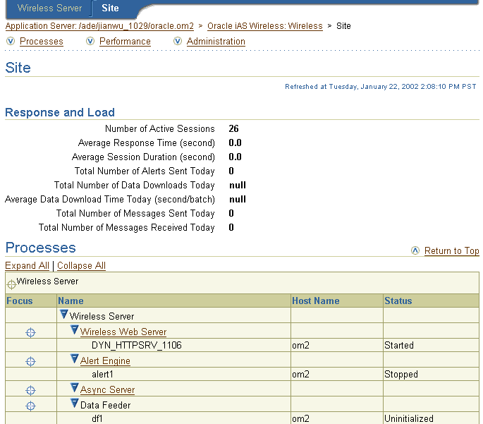

10.4 Managing Wireless Sites
The Site tab enables you to monitor and manage all the processes which run against a common database configuration. The site screen, invoked when you select the Site tab, displays overall site performance metrics in the Response and Load section. The Response and Load section includes overall performance statistics for the site-wide processes of the wireless web server.
Wireless Management provides you with current snapshots of the system performance metrics of the Wireless Web server, alert, and feed components that enable you to assess system health and performance. These individual metrics may not directly point to a fault in the system; however, building an abductive reasoning model from the data collected by these metrics enables you to diagnose the system's health.
The Site screen includes a Processes table that displays the site-wide process types. The individuals processes are listed under the process types. For each site-wide process, the table lists the name of the process, the machine on which it runs, and current status of the process (started, stopped, or uninitialized).
Like the Wireless Server screen, these process types are hyperlinks which give you access to detail screens that enable you to both configure a selected process and view its performance metrics. For more information on configuring the site-wide processes, see Section 12.2 in Chapter 12, "Server Configuration". See Section 13.2 in Chapter 13, "Server Performance Monitoring".
The Administration section of the screen enables you to configure such components as the proxy server, the JDBC connection pool, and runtime configuration (including session life time). In addition, you can upload and download repository objects and register providers. For more information, see Chapter 12, "Server Configuration".
In the Site tab, you can view all processes by clicking Expand All. Likewise, you can hide all the processes by clicking Collapse All. If you view and manage many processes, you can create a view that isolates these processes of one type by clicking Focus.
Figure 10-6 The Site Tab
