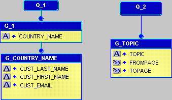

The steps in this section will show you how to create a second query in the data model with a formula column that calculates the page range for the data under each country name. This query will fetch the information from the database table you created in Section 34.2.1, "Create a table in the database to hold the information for the TOC". You will later create a tabular layout to display this information in your table of contents.
SELECT TOPIC, MIN(PAGE) FROMPAGE, MAX(PAGE) TOPAGE FROM TOC_EXAMPLE GROUP BY TOPIC
TOC_pages
, and the Datatype property to Character.
begin if :fromPage = :toPage then return (:fromPage); else return (:fromPage ||'-'|| :toPage); end if; end;

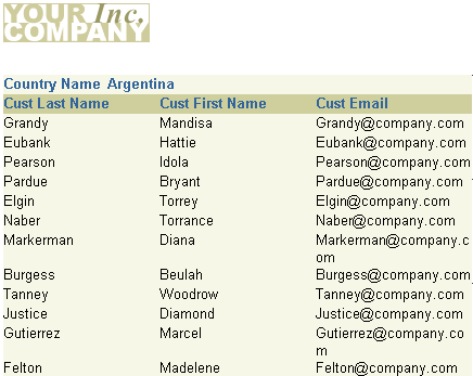

Click the Run to Paper button in the toolbar. The table of contents displays on the first page of the report, and looks like the following:
When you navigate to, for example, page 1, you'll see the e-mail addresses for the customers in Argentina:
You can navigate to various pages in your report to view the data for each country.

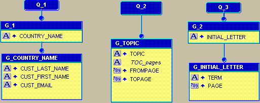

The steps in this section will show you how to add a query to your data model that will retrieve the individual customer names and the page numbers for your index.
SELECT SUBSTR(TERM,1,1) INITIAL_LETTER, TERM, PAGE FROM INDEX_EXAMPLE ORDER BY TERM
