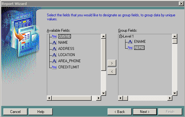

- On the Groups page, click ENAME and REPID in the Available Fields list and click the right arrow (>) to move these fields to the Group Fields list, then click Next.
Figure 19-2 Selecting group fields in the Report Wizard

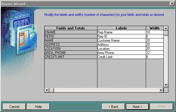

- On the Labels page, change the labels and field widths as follows, then click Next:
Figure 19-3 Specifying labels and widths in the Report Wizard

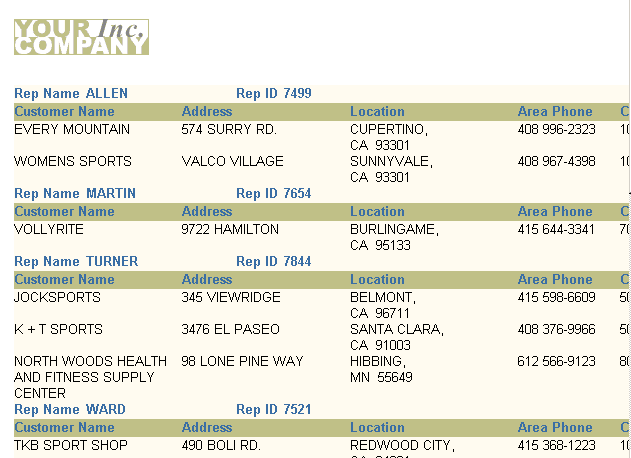

In the Paper Design view, the data is grouped by the Sales Representative with customer data listed below each Sales Representative.
Figure 19-4 Report layout in the Paper Design view
All the data will display on one page and the individual sales transactions for each customer is not yet available. You will need an additional query in the Data Model to accomplish this.

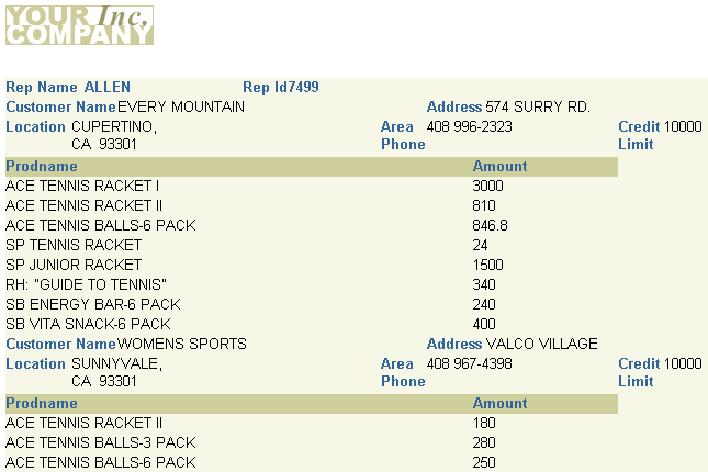

- On the Template page, click Finish to display your report output in the Paper Design view. It should look something like this:
Figure 19-5 Revised report layout in Paper Design view
Note that the data is still grouped by the Sales Representative with customer data listed below each Sales Representative. But now, the individual products sold to the customers are listed below each customer. The report now has multiple pages.

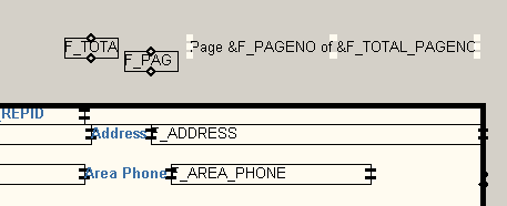

- Click the Field tool in the tool palette and draw a field about two characters long in the center of your margin.
- Double-click the new field object (F_1) to display the Property Inspector, and set properties:
- Under General Information, set the Name property to F_TOTAL_PAGENO.
- Under Field, set the Source property to Total Pages, and set the Visible property to No.
- Under General Layout, set the Horizontal Elasticity property to Variable.
Hiding both this field and the field you'll create below ensures that they'll appear only where you reference them. Changing the horizontal sizing to Variable ensures that the fields can expand to accommodate large page ranges.
- Under Field, click the Page Numbering property field to display the Page Numbering dialog box:
in the Reset at list, click R_G_ENAME, and verify that the Start at and Increment by values are both 1.
- Close the Property Inspector.
- In the Paper Layout view, click the F_TOTAL_PAGENO field.
- Choose Edit > Copy, then choose Edit > Paste to create a new field with the same dimensions as F_TOTAL_PAGENO next to F_TOTAL_PAGENO.
- Drag the new field object (F_TOTAL_PAGENO1) to an open area of the margin.
- Double-click the new field object (F_TOTAL_PAGENO1) to display its Property Inspector, and make the following changes:
- Under General Information, set the Name property to F_PAGENO.
- Under Field, set the Source property to Page Number.
Because it is a duplicate of F_TOTAL_PAGENO, the Horizontal Elasticity and Visible properties are already set as desired.
- Under Field, click the Page Numbering property field to display the Page Numbering dialog box.
In the Reset at list, click R_G_ENAME, and verify that the Start at and Increment by values are both 1.
Next, you will reference these fields in a text box to display page numbers in the format "Page X of Y Pages".

- In the Paper Layout view, click the Line Color tool in the tool palette.
- In the color palette, click No Line.
- Click the Text tool in the tool palette.
- Position the cursor in the top margin where you would like the page number to appear, and click to create a boilerplate object.
- In the new boilerplate object, type
Page &F_PAGENO of &F_TOTAL_PAGENO.
Figure 19-7 Page number source and reference fields in top margin of report
In the report output, the current page number will appear where you reference the field F_PAGENO, while the total number of pages for each master will appear where you reference the field F_TOTAL_PAGENO. If you wish, you can resize the page number boilerplate text object to lengthen it to ensure that no values for F_TOTAL_PAGENO get truncated.
