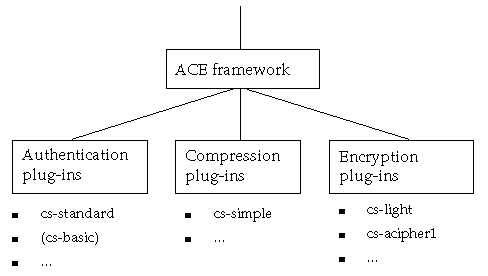

Extending the ACE Framework
The ACE framework provides an interface to an extensible set of authentication, compression, and encryption plug-ins. This section describes the use of these plug-ins, and details the mechanism for extending the set of plug-ins available in the server.
Figure C-1 ACE framework architecture
Text description of aceframe.gif follows.
Plug-Ins
Each plug-in is a shared library under UNIX, or a DLL under NT. The name of the plug-in contains a substring that indicates the type of the plug-in, as shown in the following table.
