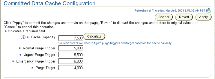

You can also dynamically configure the committed data cache, read-only connection pool, and the writeable connection pool while the service runs.
Or:
To configure the read-only or writeable connection pool, click Connection Pool Configuration. Continue with Step 6.
