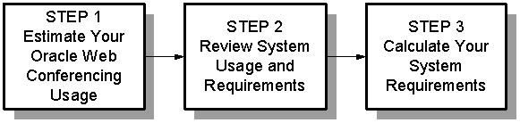

Follow these steps to determine your system's sizing needs.
