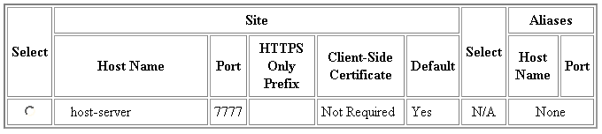

The default site established during installation uses the host name and listening port of the computer on which Oracle Application Server was installed. Figure 7-1 shows the default site definitions.
The default site-to-server mappings use the following rules:
* wildcard host name to map all other virtual site names to the Oracle HTTP Server. The ESI Content Policy Exclude Fragments setting restricts OracleAS Web Cache from fetching ESI content from any sites other than the sites specified in the first rule.
* wildcard host name to map all other virtual site names to the Oracle HTTP Server and a * wildcard port number to map the site name to multiple port numbers. The ESI Content Policy Exclude Fragments setting restricts OracleAS Web Cache from fetching ESI content from any sites other than the sites specified in the first two rules.
Figure 7-2 shows the default site-to-server mappings.

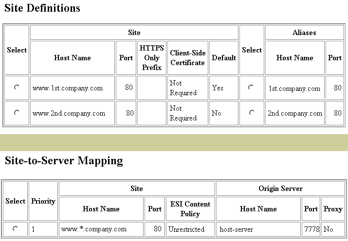

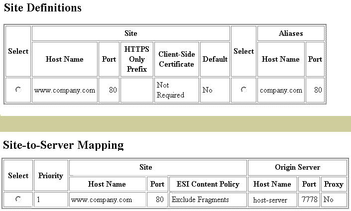

A virtual host site named www.company.com without ESI content could have the following site definition and site-to-server mapping shown in Figure 7-3.
The site definition specifies www.company.com, port 80 as the site and company.com, port 80 as the site alias. The site-to-server rule maps requests to www.company.com to application Web server host-server, port 7778. The ESI Content Policy Exclude Fragments setting restricts OracleAS Web Cache from fetching ESI content from host-server, port 7778 for www.company.com:80.
Figure 7-4 shows the site definitions and site-to-server mappings for virtual host sites www.1st.company.com and www.2nd.company.com that support ESI.
The site definition specifies www.1st.company.com, port 80 and www.2nd.company.com, port 80 as the sites, and 1st.company.com, port 80 and 2nd.company.com, port 80 as the site aliases. The site-to-server rules map sites matching www.*.company.com to application Web server host-server, port 7778. The ESI Content Policy Unrestricted setting enables OracleAS Web Cache to serve site content, as well as assemble ESI include fragments.

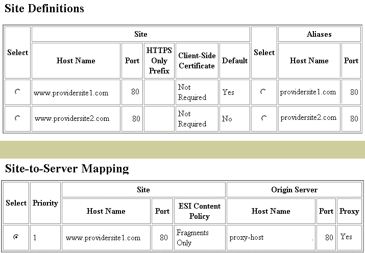

ESI provider sites named www.providersite1.com and www.providersite2.com could have the site definition and site-to-server mapping shown in Figure 7-5.
The site definition specifies www.providersite1.com, port 80 and www.providersite2.com, port 80 as the sites, and providersite1.com, port 80 and providersite2.com, port 80 as the site aliases. The site-to-server rules maps www.providersite1.com to proxy server proxy-host, port 80. The ESI Content Policy Fragments Only setting restricts OracleAS Web Cache from using this mapping for any content that is not ESI. There is no mapping for www.providersite2.com, because the proxy server is not known. Instead, DNS will be used to resolve the site name to the appropriate server. In addition, other ESI provider sites that do not have site definitions will also be resolved through DNS.
