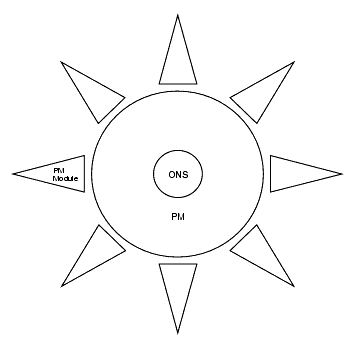

OPMN consists of a core grouping of three components that interpret and convey notification information sent between Oracle Application Server processes within the same or different OPMN servers.
The core of OPMN consists of the following three components:
Figure 2-1 shows the architecture of the core of OPMN.
Oracle Notification Server (ONS) is the transport mechanism for failure, recovery, startup, and other related notifications between components in Oracle Application Server. It operates according to a publish-subscribe model: an Oracle Application Server component receives a notification of a certain type per its subscription to ONS. When such a notification is published, ONS sends it to the appropriate subscribers.
Oracle Process Manager (PM) is the centralized process management mechanism in Oracle Application Server and is used to manage Oracle Application Server processes. It starts, stops, restarts, and detects death of these processes. The Oracle Application Server processes that PM is configured to manage are specified in the opmn.xml file.
The PM waits for a user command to start specific, or all processes. When a specific process or all processes are to be stopped, the PM receives a request as specified by the request parameters. OPMN is monitored by a shadow process that restarts upon request or after a catastrophic failure.
The PM uses the ONS to:
The Application Server Control also uses PM to manage processes.
The Oracle Process Manager Modules (PM Modules) implement Oracle Application Server component-specific process management functionality. The PM Modules pass notification information returned by other Oracle Application Server component PM Modules within the same or different OPMN servers.
The PM Modules:

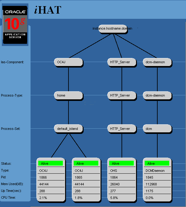

The opmn.xml file contains Oracle Application Server component entries arranged in the following hierarchical structure:
<ias-component> <process-type> <process-set>
<ias-component>: This entry represents the Oracle Application Server component. It enables management of the component for processes such as starting and stopping.
<process-type>: This subcomponent of the <ias-component> entry declares the type of process to run by association with a specific PM module.
<process-set>: This sub-subcomponent of the <ias-component> entry enables you to declare different sets of optional runtime arguments and environments for the Oracle Application Server component.
The following Example 2-1 shows an example of the <ias-component>, <process-type>, <process-set> entries in an opmn.xml file.
<ias-component id="OC4J"> <process-type id="home"> <process-set id="default_island">....

The Oracle Application Server Hi-Av Tool (iHAT) provides a real time, graphical interface view of your enterprise. iHAT displays all Oracle Application Server processes managed by one or more OPMN servers including useful performance metrics about each process. The snapshot of the system is updated continuously at a configurable interval.
iHAT shows your Oracle Application Server instance with Oracle Application Server components. The ias-component, process-set, and process-type levels are displayed for each Oracle Application Server component. The child process display of the process-type shows the status, process-type, process identification (pid), memory usage, uptime, and CPU usage.
Figure 2-2 shows an example of the iHAT display for an enterprise with two Oracle Application Server instances.
