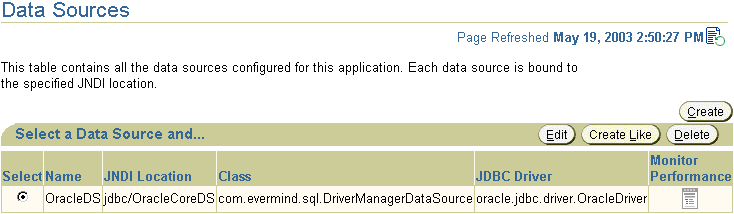

The data-sources.xml file is pre-installed with a default data source named OracleDS. For most uses, this default is all you will need. However, you can also add your own customized data source definitions. Oracle Enterprise Manager displays all data sources in the global Data Sources page. From the OC4J Home Page, select the Administration page and choose Data Source from the Application Defaults column. The following graphic shows the Data Source page.
These data sources are able to be used by all applications deployed in this OC4J instance. To create data sources that are local to a particular application, drill down to the application page and then choose Data Source in the Administration section.

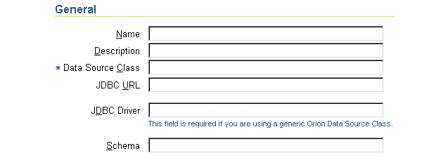

Figure 4-2 shows the General section.
The General section enables you to define the following aspects about a data source:
com.evermind.sql.ConnectionDataSource, that the data source is instantiated as.
jdbc:oracle:thin:@my-lap:1521:SID.
oracle.jdbc.driver.OracleDriver.

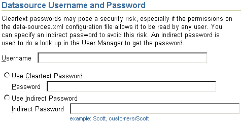

Figure 4-3 shows the username and password.
Username/Password--The username and password used to authenticate to the database that this data source represents. The password can either be entered as clear text, or you can provide a username for an indirect password. For details, see the Oracle Application Server Containers for J2EE Services Guide.

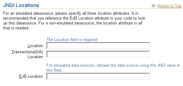

Figure 4-4 shows the JNDI Locations section.
The JNDI Locations section enables you to define the JNDI location string that the data source is bound with. This JNDI location is used within JNDI lookup for retrieving this data source. For emulated, you must provide all locations, even though only the EJB Location is used. That is, you should only refer to the EJB Location in your application.

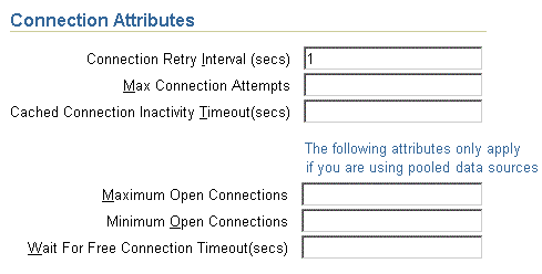

Figure 4-5 shows the Connection Attributes section.
This section enables you to modify connection tuning parameters, including the retry interval, pooling parameters, timeout parameters, and maximum attempt parameter.

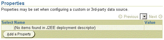

Figure 4-6 shows the Properties section for the data source.
If your data source is a third party data source, you may need to set certain properties. These properties would be defined in the third-party documentation. In addition, properties must be set for JTA transactions for the two-phase commit coordinator.

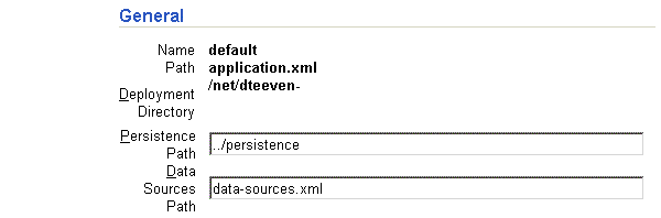

The elements you add or modify are stored by Oracle Enterprise Manager in an XML file. This file defaults to the name of data-sources.xml and is located in /j2ee/home/config. If you want to change the name or the location of this file, you can do this in the General Properties page off of the default application screen.
On the Applications page, scroll down to Default Application. Choose default. This brings you to the default application screen. Scroll down to the Administration section and choose General from the Properties column. Within the General Properties screen, shown below, you can modify the name and location of the data sources XML configuration file. Any location that you configure in the data sources path field must be relative to the /j2ee/home/config directory.
When applied, the data sources XML filename and path are stored in the global application.xml file. In the application.xml file, the <data-sources> element contains both the name and path of the data sources XML file.
The following shows the default configuration:
<data-sources path = "data-sources.xml" />
The path attribute of the <data-sources> tag contains both path and name of the data-sources.xml file. The path can be fixed, or it can be relative to where the application.xml is located.
