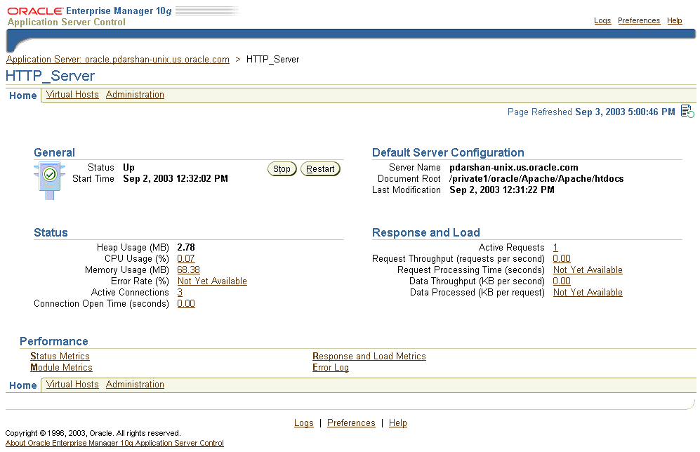

Figure 7-1 displays the Oracle HTTP Server Home page.
The Oracle HTTP Server Home page is divided into three sections: Home, Virtual Hosts, and Administration, where you can perform tasks such as:
Click on Help on the browser page you are on to get additional information about the functionality provided on that page.

You can monitor the heap usage, CPU usage, memory usage, error rate, number of active connections, and the time the connections have been open, on the "Status" section under the "Home" tab of the Oracle HTTP Server Home page.
You can monitor the number of active requests, the request throughput time, request processing time, data throughput, and data processed on the "Response and Load" section under the "Home" tab of the Oracle HTTP Server Home page.
You can view the general server status, and the response and load information under the "Home" tab on Oracle HTTP Server Home page.
The "Status" section provides information such as heap usage, CPU usage, memory usage, error rate, number of active connections, and time the connections have been open.
Click on "Status Metrics" under the "Performance" section to view detailed status details.
The "Response and Load" section provides information such as number of active requests, how many requests were submitted, and how long it took for the server to respond to your request. It also provides information about how many bytes of data were processed with the requests.
Click on "Response and Load Metrics" under the "Performance" section to view detailed response and load information.
The "Module Metrics" section allows you to view the status of the modules being used by clicking on "Module Metrics" under the "Performance" section. It provides information such as the number of active requests, number of requests processed since startup, number of current requests throughput, and the current request processing time.
You can view the last 2000 lines of the httpds error log by clicking "Error Log" under the "Performance" section.

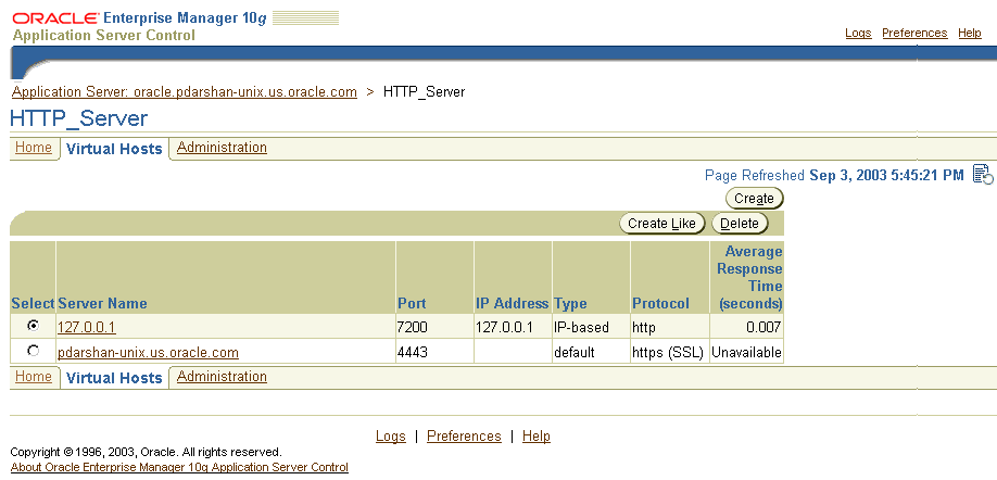

Figure 7-2 displays the Virtual Hosts page. You can view the Virtual Hosts page by clicking on the "Virtual Hosts" tab on the Oracle HTTP Server Home page. The following topics are discussed in this section:
Virtual hosts that meet the following requirements can be managed by the Application Server Control:
ServerName directive is specified for each virtual host.
IP listen address>:<port> pair that meets the following requirements can be specified for the virtual host:

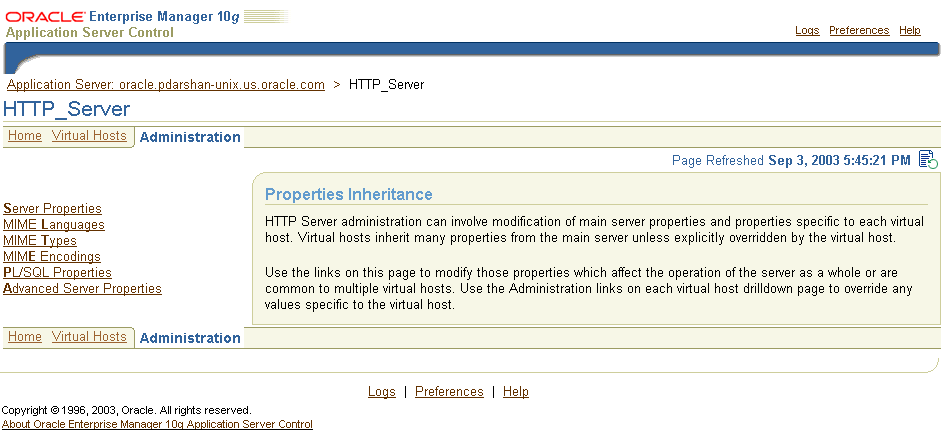

Figure 7-3 displays the "Administration" page. You can view the "Administration" page by clicking on the "Administration" tab on the Oracle HTTP Server Application Server Control Home page. The following topics are discussed in this section:
