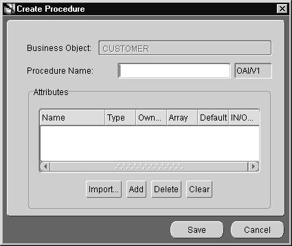

Creating a Procedure
To create a procedure:
  1. From the File menu, select New, then select Procedure. The Create Procedure dialog displays:
    Text description of createprocedure.gif follows.
    Enter information in the following fields:
    Business Object Name--The name of the category to which the procedure belongs. Select from the drop down list.
    Procedure Name--The name of the procedure. Only alphanumeric characters can be used.
    OAI/V1--The owner and version number of the procedure. This field cannot be edited.
  2. Add or import attributes to this procedure.
    See Also:
  3. Click Save.

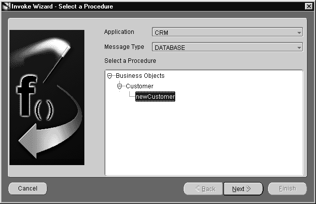

Invoking a Procedure
Invoking a procedure in iStudio involves using the Invoke Wizard. To start the Invoke Wizard:
  1. In the Design Navigation tree, expand the Application node. Select and expand the Application node to display the Invoked Procedures leaf. Right-click Invoke Procedures and select Invoke. The Invoke Wizard displays:
    Text description of is09.gif follows.
    1. Use this page to enter information for the following fields:
      Application--The name of the application invoking the procedure. Select an application from the drop down list.
      Message Type--This field specifies the mode of communication between OracleAS InterConnect and the application. Select from the following message types:
      Database--OracleAS InterConnect communicates with the application using the database.
      Generic--OracleAS InterConnect communicates with the application using a user-defined bridge.
      XML--OracleAS InterConnect communicates with the application using XML data described through a DTD using the FTP, SMTP, HTTP, MQ Series, or user-defined adapters.
      AQ--OracleAS InterConnect communicates with the application through Oracle Advanced Queues using the Advanced Queue adapter. The payload can be Oracle Objects where fields may be XML or RAW XML.
      D3L--The adapter communicates with the application using D3L.
    2. Select the procedure to invoke in the Select a Procedure box.
    3. Click Next.

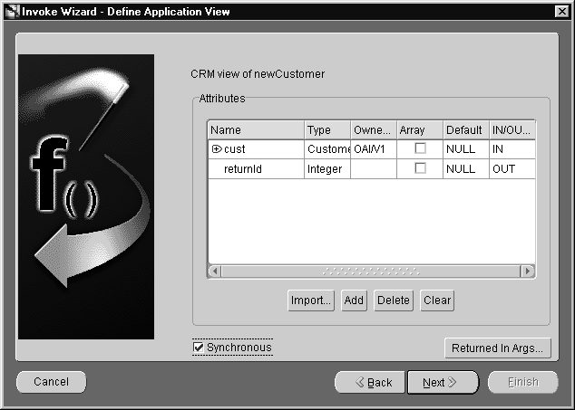

  2. Define Application View Page
    After clicking Next on the Select a Procedure page, the Define Application View page displays:
    Text description of is10.gif follows.
    Once a procedure is selected to invoke, the application view is defined. The application view page is initially an empty table. Define the attributes using Add or import the definitions from a database or an API Repository using Import.
    1. Add or import attributes by clicking Add or Import.
    2. Check the Synchronous box if this is a synchronous invoke. For example, if the request will block until a reply is recieved.

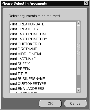

    3. To specify IN arguments to be returned, click Returned In Args. The Please Select In Arguments dialog displays:
      Text description of is11.gif follows.
    4. Select the input and output arguments to be returned. Use the left mouse button to select multiple arguments. Only non user-defined input arguments are shown for selection.
    5. Click OK to return to the Define Application View page.
    6. Click Next.

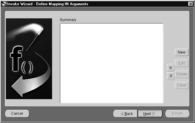

  3. Define Mapping IN Arguments Page
    Mapping arguments involves copying the individual fields or simple shape-change transformations. After clicking Next on the Define Application View page, the Define Mapping IN Arguments page displays:
    Text description of is12.gif follows.
    1. Click New to define mappings. The Mapping Parameters page displays:
      Text description of mappingparameters.gif follows.

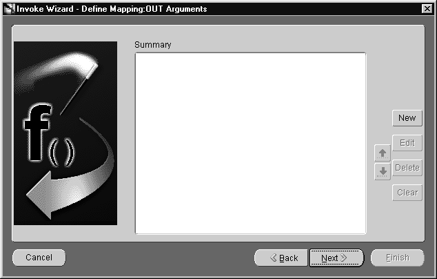

  4. Define Mapping OUT Arguments Page
    Mapping arguments involves copying the individual fields or simple shape-change transformations. Use this page to map the common view return arguments to the application view return arguments.
    Text description of is13.gif follows.
    2. Click Finish.

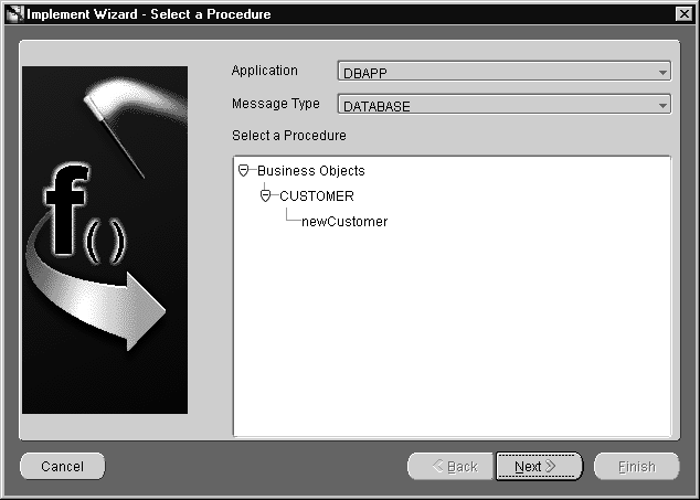

    Use this page to select a procedure to implement.
    1. Select information for the following fields:
      Application--The name of the application implementing the procedure. Select an application from the drop down list.
    2. Select the procedure to invoke.
    3. Click Next.

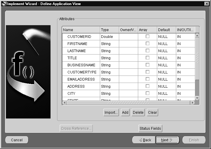

    After selecting the procedure to implement, the Define Application View page displays:
    Text description of implementproc2.gif follows.
    Initially, this page is an empty table, used to define the application view. Attributes can be defined by using Add. Attribute definitions can be imported from a database or an API Repository by using Import.
    2. Click Cross Reference... to populate cross reference tables.
    3. Click Next.

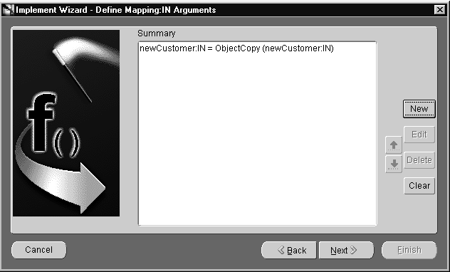

    Mapping may involve copying individual fields, or simple shape-change transformations. After clicking next on the Define Application View page, the Define Mapping IN Arguments page displays:
    Text description of is18.gif follows.
    Use this page to define mapping IN arguments.
    2. Click Next.

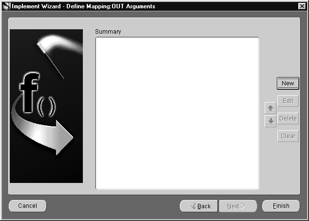

    After clicking Next on the Define Mapping IN Arguments page, the Define Mapping OUT Arguments page displays:
    Text description of is19.gif follows.
    Use this page to define mapping OUT arguments.
    2. Click Next.

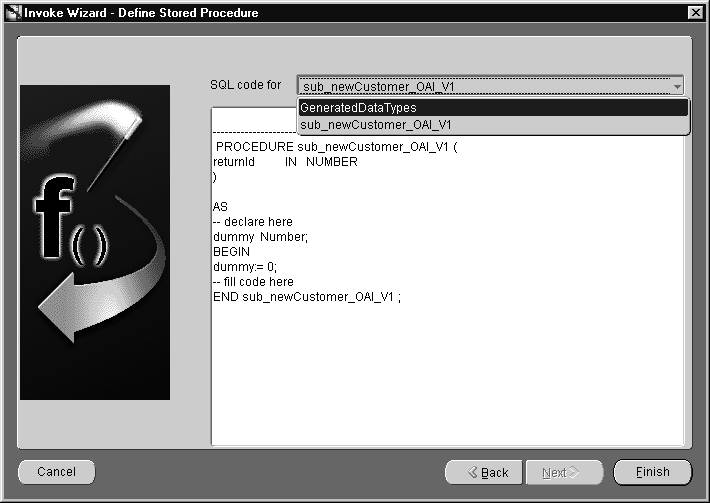

  5. Define Stored Procedure Page
    After clicking Next on the Define Mapping OUT Arguments page, the Define Stored Procedure page displays:
    Text description of is14.gif follows.
    If the message type selected was database, the data is received by a stored procedure. In this stored procedure, the action performed when the values are returned to the application can be specified. The adapter invokes the stored procedure at runtime with the appropriate data.
    The following arguments will be returned:
    • All OUT arguments.
    • All IN arguments specified to be returned as part of the reply.
    1. Select a generated procedure from the SQL code for drop down list.
    2. Click Finish.

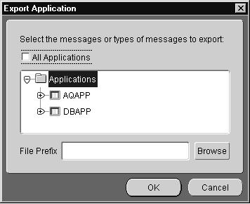

Exporting Stored Procedures
iStudio generates stored-procedure stubs to enable an application to interface with the OracleAS InterConnect run-time easily. These stubs are exported to a file using the export functionality.
To export stored procedures:
  1. Select File from the menu bar, then select Export. The Export Application dialog displays:
    Text description of exportapp.gif follows.
  2. Select the messages to export stored procedures. Messages can be filtered as follows:
    • Export all messages--Select Applications at the top of the directory.
    • Export all messages of a certain type for all applications--Check All Applications, then select one or more types of messages to export.
    • Export all messages for a specific application--Select the application name.
    • Export all messages of a certain type for a specific application--Select the type under the application name in the directory.
    • To export specific messages--Select the messages by name. To select more than one message or class of messages click the application.
  3. Enter the name of the file to contain the exported stored procedures in the File Prefix field. The name generates multiple files.
    To view the directory page, click Browse.
  4. Click OK. The stored procedure is now exported.
