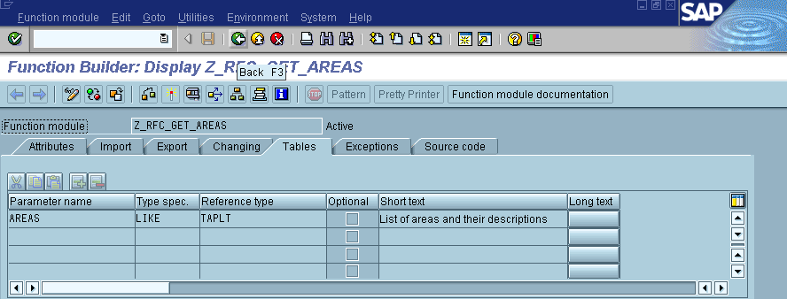

Table Parameters/Exceptions Interface
Table 5-3 describes table parameters.
Table 5-3 Table Parameters
Table Parameters Ref. Structure Short Text
AREAS
TAPLT
Lot of areas and descriptions

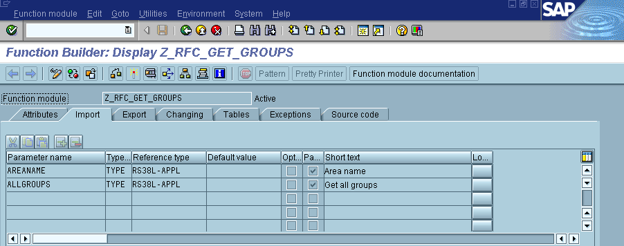

Import/Export Parameter Interface
Figure 5-2 displays the Z_RFC_GET_GROUPS import and export parameters.
Figure 5-2 Function Module Display:Import/Export Parameters Z_RFC_GET_GROUPS
Text description of rfcimportexposrtgroups.gif follows.
Table 5-4 Import parameter definitions
Import parameter Reference field Proposal Optional Short Text
AREANAME
RS38L-APPL
N/A
N/A
Get all Groups
ALLGROUPS
RS38L-APPL
SPACE
X
Area Name

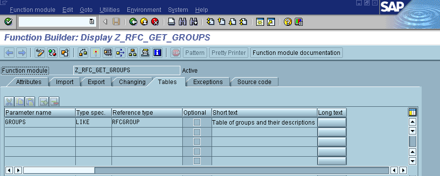

Figure 5-3 displays the Remote Function Call parameters group.
Figure 5-3 Remote Function Call Table Parameters Group
Text description of rfctableparamsgroups.gif follows.
Table 5-5 Table Parameter Definitions
GROUPS
RFCGROUP
Table of Groups and their descriptions

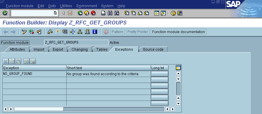

Exception
N/A
N/A
NO_GROUP_FOUND
N/A
No Group was Found according to the Criteria
Figure 5-4 Remote Function Call Exception Group
