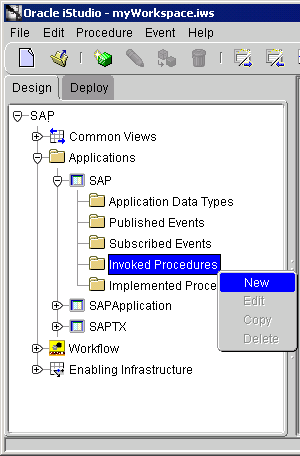

Creating an Application Link Enabling Implemented Procedure

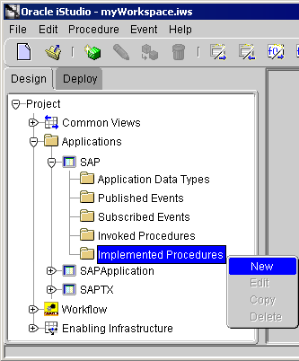

  1. Start iStudio and open your project.
  2. Expand the Applications folder.
  3. Expand your Application.
  4. Right-click Implemented Procedures and select New.
    Figure 3-1 Creating an Implemented Procedure
    Text description of newimplementedprocedure.gif follows.

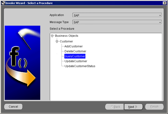

    The Implement Wizard--Select a Procedure dialog displays.
    Figure 3-2 Implement Wizard --Selecting a Procedure
    Text description of selectaprocedure.gif follows.
  5. Select the Application and Message Type from the dropdown menus.
  6. Select a procedure and click Next.

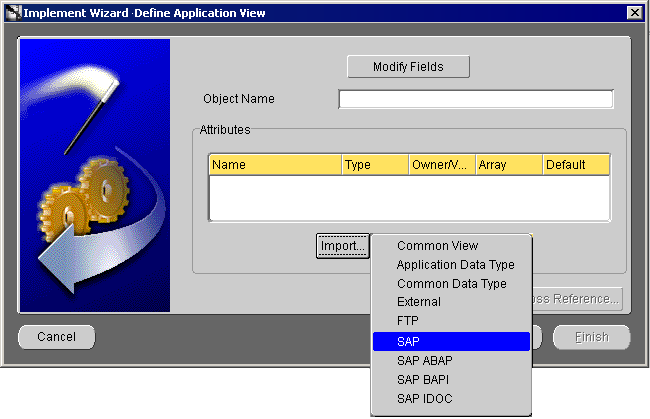

  7. Click Import and select SAP from the dropdown menu.
    The SAP Login dialog displays.

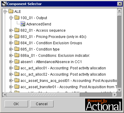

    Once logged in to SAP, the Component Selector dialog displays.
    Figure 3-4 Component Selector for Application Link Enabling
    Text description of aleidoc.gif follows.

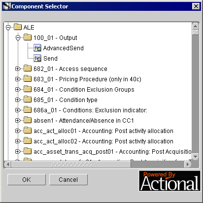

  8. Expand the ALE tree until the correct component displays for selection.
  9. Select AdvancedSend or Send and click OK.

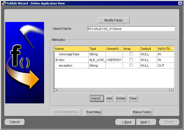

    The Send method populates the control record of the intermediate document from the parameters set up in the SAP R/3 configuration editor. The AdvancedSend method allows more flexibility. When you use this method, you must pass the control data to the method.
    The Define Application View dialog displays with the selected component and its attributes.
    Figure 3-5 Populated Implement Wizard - Define Application View dialog
    Text description of implaledefineapp.gif follows.

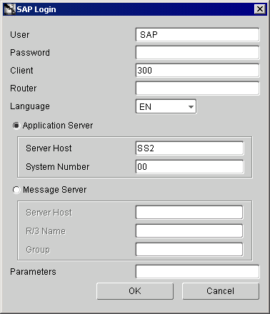

    The first time you log in from a new workstation, you are required to enter information in every field that is required for your setup. Every subsequent login from that workstation only requires a password to log in. For every iStudio session, only one login is required.
    Figure 3-6 Initial SAP Login dialog
    Text description of istudiosaplogin.gif follows.
  2. Enter information in the following fields:
    • User--The user ID for the SAP R/3 system.
    • Password--The user password for the SAP R/3 system.
    • Client--The client number for the SAP R/3 system.
    • Router--A destination router used to connect to the Application Server or Message Server. For example: /H/UNICENTER/H/204.79.199.5/H.
    • Language--The language required by SAP R/3 system. By default the Language parameter retrieves the language information from the users operating system.
    • Application Server--Select if using the Application Server and enter information the following fields:
      • Server Host--The identification of your SAP R/3 system. This value defines a connection to an Application Server representing a single SAP R/3 system.
      • System Number--The SAP System number identifying the system on the host. This number specifies the TCP/IP service of the Remote Function Call Gateway containing the registered Agent.
        System Number further identifies the Host to a specified Service level. The service is the TCP/IP service name (a port number through \winnt\system32\drivers\etc\services). For example, using ss1:00 as the connecting host in the browser, the 00 is what SAP calls the system number. When specifying a service name, sapgw00, the 00 also represents the system number. That is, if an SAP R/3 system uses system number 23, then ss1:23 is in the login dialog and uses sapgw23 as the service number for the SAP Agent. sapgw is a name assigned on installation to identify the gateway machine.
    • Message Server--Select if using the Message Server and enter information in the following fields:
      • Server Host--The Server type which identifies the Message and provides the Server host name. This value defines a connection to a message server acting as a load-balancing server redirecting the login to an application server. The message server option is only valid for inbound calls. For example, hs0016.WDF.SAP-AG-DE.
      • SAP R/3 Name--The System ID identifying the SAP System. For example, D15.
      • Message Server Group--If your message servers belong to a group, enter the message server group. For example, PUBLIC.
    • Parameters--The host identification parameter.
      A route string that contains a substring for each SAP router and for the target server. The route string syntax is: /H/host/S/service/W/pass that is, it comprises any number of substrings of the form /H/host/S/service/W/pass. For example, a connection from hostA to hostB, port 3333 via the saprouter host hostR with SAProuter password summer has the route string /H/hostR/S/3299/W/summer/H/hostB/S/3333.

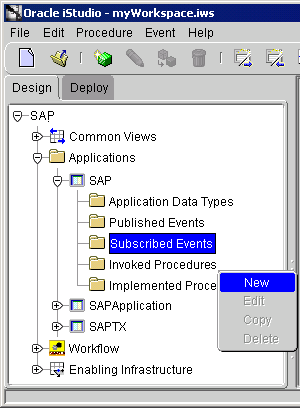

Creating an Application Link Enabling Subscribed Event
To create an Application Link Enabling subscribed event using iStudio:
  1. Start iStudio
  2. Open your project.
  3. Expand the Applications folder.
  4. Expand your application.
  5. Right-click Subscribed Events and select New.

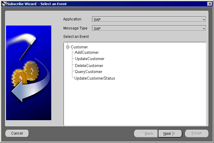

    The Subscribe Wizard--Select an Event dialog displays.
    Figure 3-8 Subscribe Wizard - Selecting an Event
    Text description of selectevent.gif follows.
  6. Select the Application and Message Type from the dropdown menus.
  7. Select an event and click Next.

    The Component Selector dialog displays.
    Figure 3-10 Component Selector
  9. Expand the ALE tree until the correct component displays for selection.
  10. Select AdvancedSend or Send and click OK.
    The populated Define Applications View dialog displays.

    The populated Define Application View dialog displays.
    Figure 3-16 Implement Wizard - Define Application View
    Text description of implrfcdefapp.gif follows.
  11. Click Next.
    Figure 3-17 Creating a Subscribed Event
    Text description of newsubevent.gif follows.
    Figure 3-18 Subscribe Wizard - Selecting an Event
    If this is the initial login for this machine, enter the correct information.
    See Also:
    "Importing Attributes from SAP"
    If this machine has been logged in to SAP before, enter the password on the SAP Login dialog and click OK.

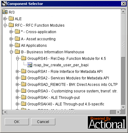

    Figure 3-20 Component Selector - RFC - RFC Function Modules
    Text description of rfccompsel.gif follows.
  9. Expand the RFC - RFC Function Modules tree until the correct component displays for selection.
  10. Select a component and click OK.

Creating an Outbound Application Link Enabling Invoked Procedure
  1. Start iStudio.
  5. Right-click Invoked Procedures and select New.
    Figure 3-22 Creating an Implemented Procedure
    Text description of newinvokedproc.gif follows.

    The Component Selector displays.
    Figure 3-25 Component Selector - Application Link Enabling
    Text description of aleadvancedsend.gif follows.

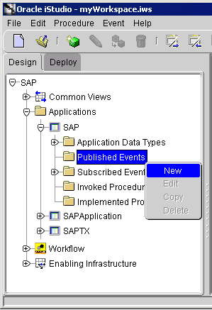

  5. Right-click Published Events and select New.
    Figure 3-27 Creating a Published Event
    Text description of newpubevent.gif follows.
    The Publish Wizard--Select an Procedure dialog displays.

    The Define Application View dialog displays.
    Figure 3-29 Publish Wizard - Define Application View
    Text description of pubaledefineapp.gif follows.
  8. Click Import and select SAP.
    See Also:
    Figure 3-30 Component Selector - Application Link Enabling AdvancedSend

    Figure 3-31 Publish Wizard - Populated Define Application View
  11. Click Next.
    The Define Mappings dialog displays.
  12. Click New to define mappings and click Finish.
    The new populated event will display in the right panel in iStudio.
Creating a Remote Function Call Invoked Procedure
To create a Remote Function Call invoked procedure in iStudio:
  1. Start iStudio.
    Figure 3-32 Creating an Invoked Procedure
    The Invoke Wizard--Select a Procedure dialog displays.
    Figure 3-33 Invoke Wizard - Selecting a Procedure
    Text description of invselectaprocedure.gif follows.
  7. Select a procedure and click Next.

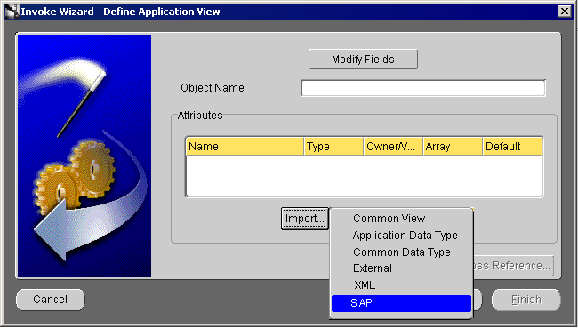

    Figure 3-34 Invoke Wizard - Define Application View
    Text description of invistudioimport.gif follows.
