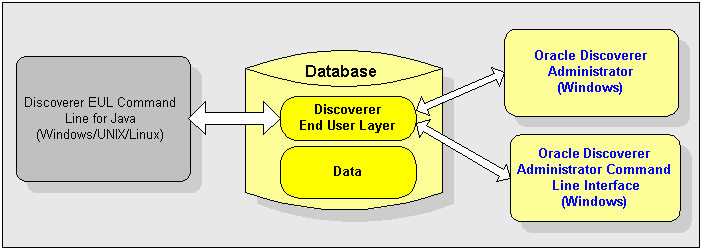

The figure below shows three different ways in which you can manipulate Discoverer EULs:
Notes:

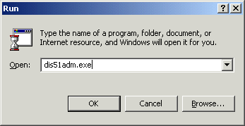

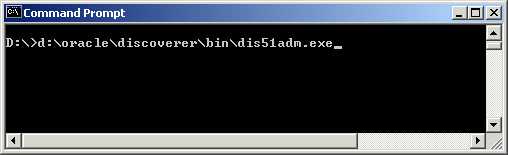

You can run Discoverer commands in the following ways:

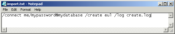

How to create a command file
You can create a command file using a text editor. Type the command into the text editor and save the file using the extension .txt.
