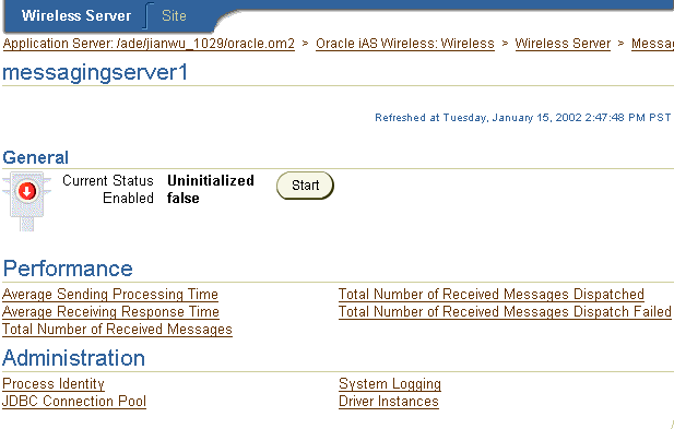

12.1.3 Configuring a Messaging Server Process
From the messaging server process detail screen, you can perform the following configuration tasks:
12.1.3.1 Configuring the Process Identity
To configure a process identity:
  1. Enter the process name. This is a required field.
  2. Select, or clear the Process Enabled check box.
  3. Select Participate in Cache Synchronization to enable cache synchronization with other processes.
  4. Click Apply. In the General Status section of the detail screen, the enabled status for the process displays as true. If you wish to prevent the process from participating in cache synchronization, the enables status displays as false.

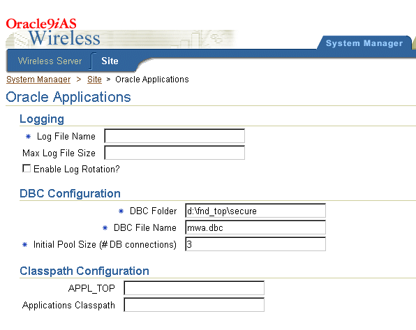

12.4.14 Configuring Oracle Applications
The Oracle Applications configuration screen, invoked by selecting Oracle Applications in the Administration enables you to configure the Oracle Application properties used by Wireless. If Wireless is not running Oracle Applications, then you do not have to configure the Oracle Applications properties.
Figure 12-2 Applications Configuration
Text description of image20.gif follows.
To configure Oracle Applications:
  1. Enter the name of the log file for Oracle Applications to use in the Log File Name Field.
  2. Enter the max size (in bytes) that the log file can reach in the Max Log File Size Field.
  3. If the log should be rotated after reaching the max file size, click on Enable Log Rotation?.
  4. Enter the location of the DBC Folder in the DBC Folder Field.
  5. Enter the name of the DBC File in the DBC File Name Field.
  6. Enter the number of initial Application's database connections in the Initial Pool Size Field.
  7. Enter the location of APPL_TOP in the APPL_TOP Field.
  8. Enter the comma-delimited list of .jar or .zip files that should be in the Classpath of the Wireless Server into the Applications Classpath Field.
