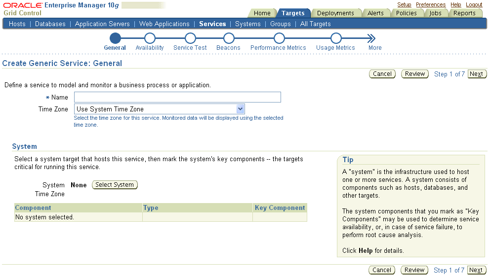

To create a service, click the Targets tab and Services subtab. The Services main page is displayed. Select a service from the Add drop-down list and click Go. The following screen is displayed:
Follow the steps in the wizard to create your service. This involves the following:
Identifying the type of service to be created. You can define different types of services based on your requirement. Some of the services that you can define are Generic Service, Web Application, Aggregate Service, and Forms Application. A Generic Service is used to monitor a variety of different protocol based services. A Web Application is used to monitor Web transactions. Enterprise Manager provides additional monitoring and diagnostics features for Web applications. A Forms Application is used to monitor Forms transactions. Each Forms transaction can consist of one or more actions that can be monitored. You can also define other services that are specific to an application such as the OCS Service. You can combine one or more services to form an Aggregate Service.
Selecting a system target that hosts this service and then marking the system's key components that are critical for running the service. These key components are used to determine the availability of the service and identify possible causes of service failure. For more information on defining systems and monitoring them, refer to the Service Management chapter in Oracle Enterprise Manager Concepts.
Setting up the availability definition for the service. This can be service test-based or system-based. If you select service test, the service's availability is based on the execution of the service test by the one or more key beacons. If availability is based on system, availability is based on the status of one or more key components of the system.
Adding one or more beacons to monitor service tests. Click Add to add one or more beacons for monitoring the service. It is recommended that you use beacons that are strategically located in your key user communities in order for them to proactively test the availability of the service from those locations. If no beacons exist, click Create to create a new beacon.
Beacons marked as key beacons will be used to determine the availability of the service. The service is available if one or more service tests can be successfully executed from at least one key beacon.For Web applications, you can compare the performance of the service test execution from each remote beacon against the local beacon.
Defining the metrics that will be used to measure the performance of the service. Performance metrics can be based on service tests or system components. After defining the metrics, you can specify the critical and warning thresholds. You can also specify the metric that is to be displayed in a graphical format on the Service Home page.
Defining the metrics that will be used to measure the user demand for the service. Usage metrics can be based on one or more system components. After defining the metrics, you can specify the critical and warning thresholds. You can also specify the metric that is to be displayed in a graphical format on the Service Home page.
You can define usage metrics for system-based services only.After you have completed all the steps in the wizard, click Finish to create your service. Refer to the Enterprise Manager Online Help for more details on these pages.

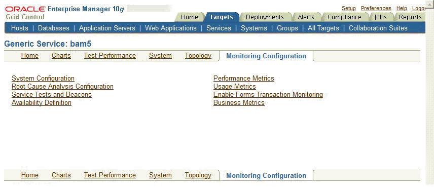

After you have created the service, you can configure it further by selecting an option from the Monitoring Configuration page. To configure a service, select a service from the Services main page and click Configure to go to the Monitoring Configuration page. The following screen is displayed.
The following options are available:

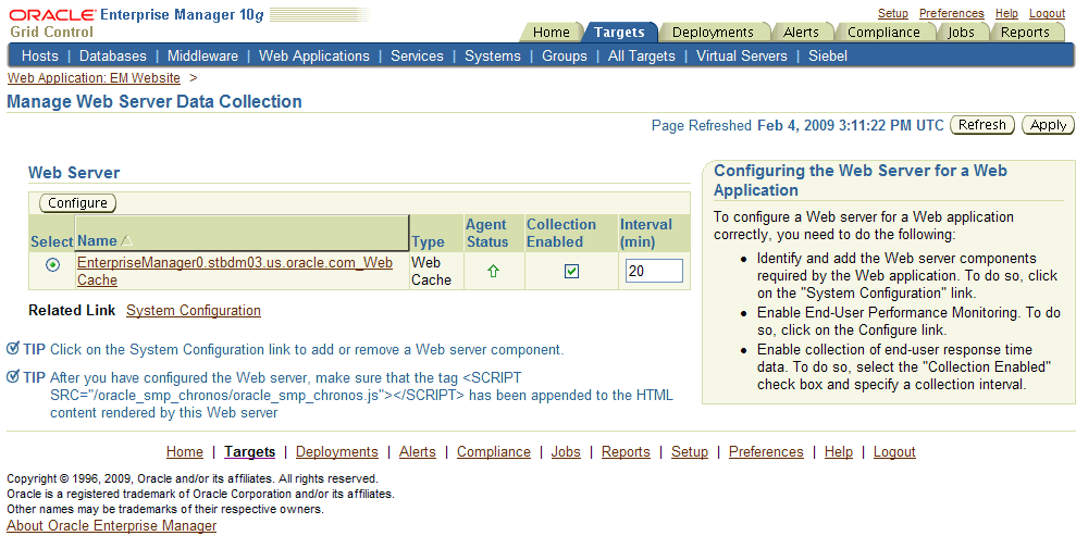

Apart from these options, for Web applications, the end-user and request performance monitoring features can also be configured. For more information, refer to the following sections:

To configure Root Cause Analysis, follow these steps:
From the Service Home page, click Monitoring Configuration.
From the Monitoring Configuration page, click Root Cause Analysis Configuration.
If the current mode is set to Automatic, click Set Mode Manual to disable RCA. If you choose to perform the analysis manually, you can perform the analysis from the Service home page at anytime by choosing Perform Analysis if the service is down. If the current mode is set for Manual, click Set Mode Automatic to enable RCA when the state of the service and its components change
Click the link in the Component Tests column of the table for the key component you want to manage. You can then manage component tests for the service on the Component Tests page by adding, removing, or editing tests. Refer to the Enterprise Manager Online Help for details on defining component tests.

Navigate to the Web Application Home page in the Grid Control Console and click Monitoring Configuration.
Click Manage Web Server Data Collection. You will see a table which lists the Web Servers including Oracle HTTP Server Based on Apache 2.0 or higher, Apache HTTP Server version 2.0 or higher, or OracleAS Web Cache.
Select the Oracle HTTP Server or Apache HTTP Server from the table and click Configure. Enter the host credentials required for modifying the Apache configuration file.
After logging in, you will see a table containing the list of sites that are being hosted by the Apache server. These include a list of virtual hosts defined by the user in the Apache Configuration file. The up and the down arrows under the Monitoring Status column shows the corresponding site is currently being monitored. For each site, check or uncheck the Enable Monitoring checkbox to indicate whether this site is to be monitored. For the site that is to be monitored, enter the log file name in the text box to indicate the location in which the end-user performance data is to be stored. By default, the log file will be created under the logs/directory under Apache root directory. To save the log file in a different directory, enter a file name with the absolute path.
Make sure that the log file name and the location you specify here match the Log file name and Log file directory in the Monitoring Configuration page of the Oracle HTTP Server or Apache HTTP Server target.
You can also use the one button accelerator to enable all sites or disable all sites all at once.
To selectively disable or enable certain URLs on a specific site, select the site, click Set URLs. Click Insert Before or Insert After to create a URL rule and place it in the desired place among all URL rules. A URL rule contains a URL Pattern, URL Pattern Type, and a check box indicating if this URL is to be monitored or not. For example, a URL rule with URL Pattern "abc" and URL Pattern Type "Ends With" and Monitor unchecked means that any URL ending with "abc" will not be monitored by End-User Performance Monitoring. The user can also delete a URL rule, move a URL rule up or down to increase or decrease its priority.
After you have made the configuration changes, click OK to go to the Apache Restart page. Restarting the Apache server will finalize all configuration changes, and end-user performance data will be logged by the Apache server.
After you have configured the Apache server, you will return to the Manage Web Server Data Collection page. You can now enable the collection of end-user performance data. For more details, refer to "Starting and Stopping End-User Performance Monitoring". If you do not see data after End-User Performance Monitoring has been enabled, refer to the "Verifying and Troubleshooting End-User Performance Monitoring".

Navigate to the Web Application home page in the Grid Control Console and click Monitoring Configuration.
Click Manage Web Server Data Collection. Enterprise Manager displays the Manage Web Server Data Collection page.
In the Interval (minutes) column, enter the interval at which Enterprise Manager will collect performance data.
Check the Collection Enabled checkbox.
Click Apply, review the changes and confirm by clicking Apply again. End-User Performance Monitoring collection is enabled and data will soon be uploaded to the database and shown under the Page Performance page.

Navigate to the Manage Web Server Data Collection page.
Clear the check box in the Collection Enabled column of the table and click Apply.
Click Apply again to confirm the changes.

Navigate to the Forms Application Home page in the Grid Control Console and click Monitoring Configuration.
Click Enable Forms Transaction Monitoring.

This section lists troubleshooting steps that you can use when the Forms transaction End-user Performance Monitoring (EUM) data is not being displayed.
Ensure that the Forms server is configured with EUM.
From the Manage Web Server Data Collection page, select the Forms server and click Configure. Log in using the credentials of the host where the Forms server is installed. Ensure that the correct Forms configuration section has been configured with EUM enabled and that the correct EUM URL is specified. Go to the Forms application URL (with the correct configuration section) and perform "Save" or "Query" actions to generate EUM traffic.
Ensure that the Web server is configured to log End-User Performance Monitoring data.
From the Manage Web Server Data Collection page, select the Web server and click Configure.
If you are using a Web Cache to log EUM data, login to the Web Cache Administration page or Web Cache Manager and check if the access_log file is set to either End-User Performance Monitoring or WCLF format. End-User Performance Monitoring data is logged into Web Cache's access_log.
If you are using HTTP Server or Apache HTTP Server, log in using the credentials of the host where the HTTP Server is installed. Then check if EUM has been enabled and note the path of the log file in the configuration page.
