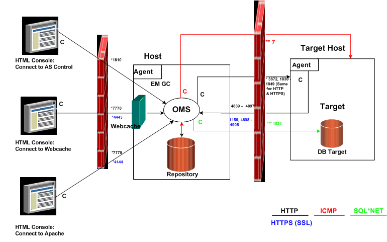

Figure 7–1 provides a topology of an Enterprise Manager grid environment that is using a firewall, and also illustrates the default ports that can be used.
Figure 7-1 Firewall Port Requirements (Default)
The conventions used in the preceding illustration are as follows:
| Convention | Description |
C |
Is the entity that is making the call. |
Enterprise Manager will default to the first available port within an Enterprise Manager set range. |
Enterprise Manager will default to the first available port. |
Are the Database listener ports. |
The direction of the arrows specify the direction of ports.
Port 1159, 4898-4989 specify that 1159 is the default. If this port is not available, the Management Service will search in the range that is specified.
To clone between two target hosts separated by a firewall, the agents will need to communicate to each other on the agent ports. The initiating agent will make the call.

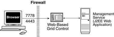

Connections from your browser to the Oracle Enterprise Manager 10g Grid Control Console are performed over the default port used for your Oracle HTTP Server.
For example, the default, non-secure port for the Oracle HTTP Server is usually port 7778. If you are accessing the Grid Control Console using the following URL and port, then you must configure the firewall to allow the Grid Control Console to receive HTTP traffic over port 7778:
http://mgmthost.acme.com:7778/em
On the other hand, if you have enabled security for your Oracle HTTP Server, you are likely using the default secure port for the server, which is usually port 4443. If you are accessing the Grid Control Console using the following URL and port, then you must configure the firewall to allow the Grid Control Console to receive HTTP traffic over port 4443:
https://mgmthost.acme.com:4443/em
Figure 7-2 shows the typical configuration of a firewall between your browser and the Grid Control Console Web-based console that is rendered by the Management Service.
Figure 7-2 Firewall Between Your Browser and the Grid Control Console

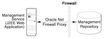

By default, the Enterprise Manager installation procedure assigns port 4889 as the Repository upload port. However, if that port is occupied, the installation will assign an alternate port number.
In addition, when you enable Enterprise Manager Framework Security, the upload port is automatically changed to the secure 1159 HTTPS port.
See Also:
"Configuring Security for Grid Control" for information about Enterprise Manager Framework SecurityAdministrators can also change the upload port after the installation.
See Also:
Chapter 13, "Reconfiguring the Management Agent and Management Service" for information about locating and changing the default ports for the Oracle Management Service and the Oracle Management Agent.After you determine the port number assigned to the Management Service upload port, you must then configure the firewall to allow incoming HTTP or HTTPS traffic (depending upon whether or not you have enabled Enterprise Manager Framework Security) on that port.
See Also:
Your firewall documentation for more information about opening specific ports for HTTP or HTTPS trafficSecure connections between the Management Service and the Management Repository are performed using features of Oracle Advanced Security. As a result, if the Management Service and the Management Repository are separated by a firewall, you must configure the firewall to allow Oracle Net firewall proxy access.
See Also:
"Configuring Secure Sockets Layer Authentication" in the Oracle Database Advanced Security Administrator's GuideFigure 7-8 shows a typical configuration of a firewall between the Management Service and the Management Repository.
Figure 7-8 Firewall Between the Management Service and the Management Repository

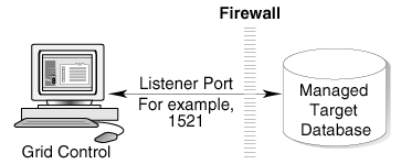

When you are using the Grid Control Console to manage a database, you must log in to the database from the Grid Control Console in order to perform certain monitoring and administration tasks. If you are logging in to a database on the other side of a firewall, you will need to configure the firewall to allow Oracle Net firewall proxy access.
Specifically, to perform any administrative activities on the managed database, you must be sure that the firewall is configured to allow the Oracle Management Service to communicate with the database through the Oracle Listener port.
You can obtain the Listener port by reviewing the Listener home page in the Grid Control Console.
Figure 7-9 shows a typical configuration of a firewall between the Management Service and the Management Repository.
Figure 7-9 Firewall Between the Grid Control and a Managed Database Target
