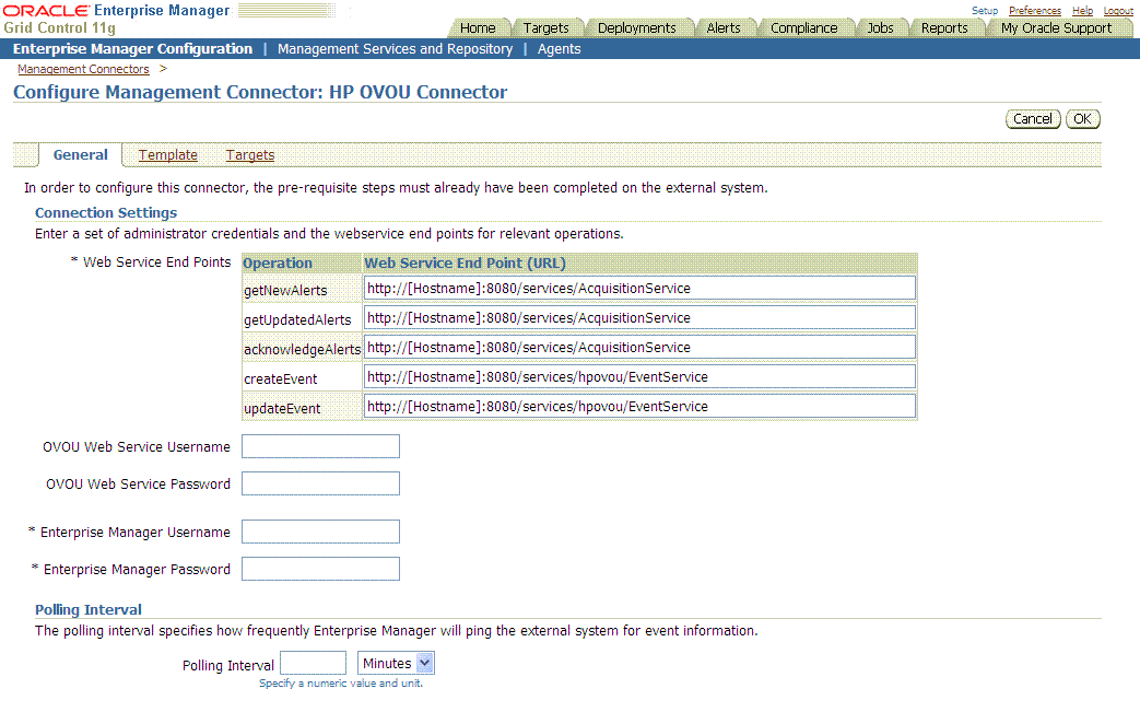

To configure the General page:
From the Management Connectors page, select the HP OVOU Connector and click the Configure icon. By default, the General sub-page of the Configure Management Connector page appears, as shown in Figure 3–1.
Change HTTP to HTTPS at the beginning of the web service URLs if you have configured the HP OpenView Operations web services with HTTPS. Otherwise, go to the next step.
Change the port to the port on which the web services are running. For example, the default port for HTTP is 8080 and the default port for HTTPS is 8443.
If you are using HTTPS as the protocol, you must also include the HP OpenView Operations web service certificate in the Enterprise Manager as described in Adding Signed Certificates to Enterprise Manager.
getNewAlerts — Creates alerts in Oracle Enterprise Manager based on events (messages) that originate in HP OpenView Operations. Oracle Enterprise Manager uses this operation when polling for events in HP OpenView Operations.
getUpdatedAlerts — Updates alerts in Oracle Enterprise Manager based on events (messages) that originate from HP OpenView Operations. Oracle Enterprise Manager uses this operation when polling for events from HP OpenView Operations.
acknowledgeAlerts — Acknowledges the alerts after Oracle Enterprise Manager has processed them. Oracle Enterprise Manager uses this operation when polling for events in HP OpenView Operations.
createEvent — Generates events (messages) in HP OpenView Operations based on alerts that originate in Oracle Enterprise Manager. Oracle Enterprise Manager invokes this operation when it forwards a new alert to OVOU.
updateEvent — Updates events (messages) in HP OpenView Operations based on alerts that originate in Oracle Enterprise Manager. Oracle Enterprise Manager invokes this operation when it forwards a new alert to OVOU.
The connector uses two different URLs. One URL is used for operations that poll data out of HP OpenView Operations (getNewAlerts, getUpdatedAlerts and acknowledgeAlerts), and defaults to the following value:
http://[Hostname]:8080/services/AcquisitionService
You need to replace [Hostname] in the URL when configuring it for HTTP.
The other URL is used for operations that push data into HP OpenView Operations (createEvent and updateEvent), and defaults to the following value:
http://[Hostname]:8080/services/hpovou/EventService
Enter the user name and password of the Oracle Enterprise Manager account.
Optionally enter a polling interval to specify how often Oracle Enterprise Manager should poll the HP OpenView Operations web service for new or updated messages to process. The poll interval defaults to 5 minutes if not specified.
Click OK to save your configuration changes.

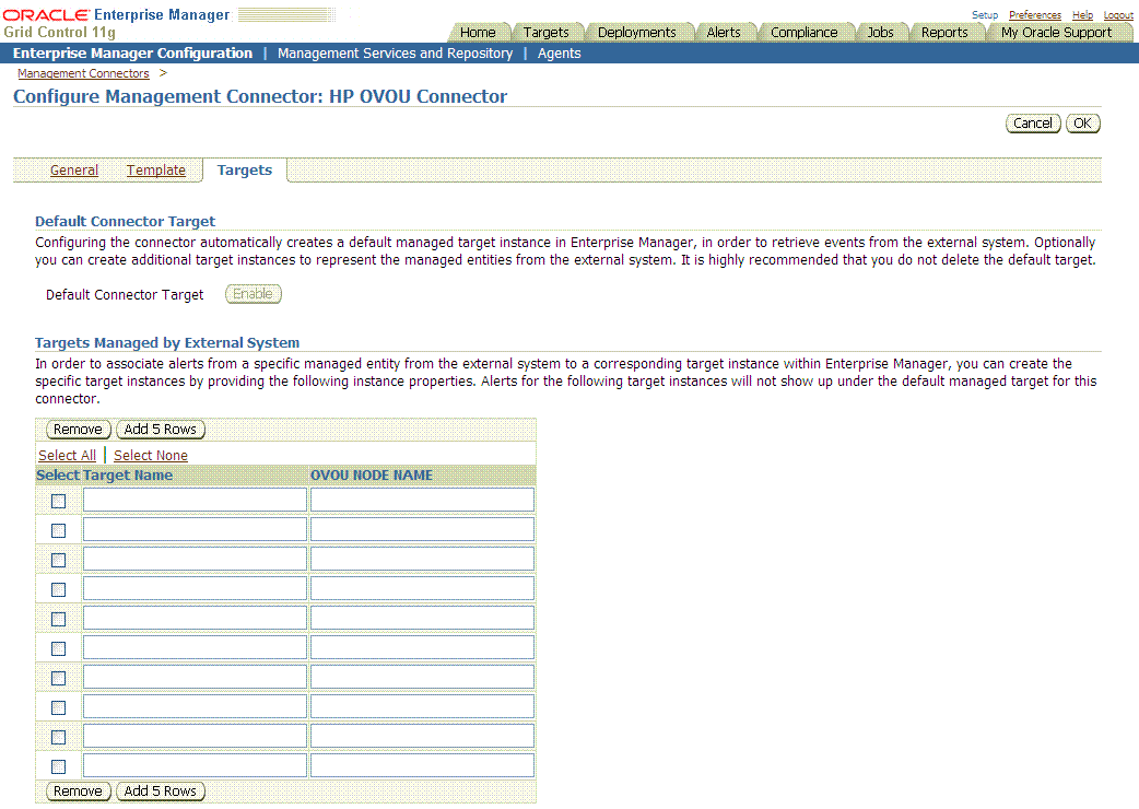

Whenever an HP OpenView Operations message is translated into an Oracle Enterprise Manager alert, the HP OVO message node determines the target-type instance associated with the alert in Oracle Enterprise Manager. If a target instance that matches the message node is not found, the default target instance of generic_ovou_managed_node is used for the alert.
To add proxy targets in Oracle Enterprise Manager:
From the Configure Management Connector page, click the Targets link to display the Targets page, as shown in Figure 3–2.
Provide a target name. The Target Name field is set to the node name specified in the OVO message and must match the message node name exactly.
Provide the fully qualified OVOU node name in the OVOU NODE NAME field. This field must be set to the same value as the Target Name field.
Repeat this process for as many target instances as desired.
