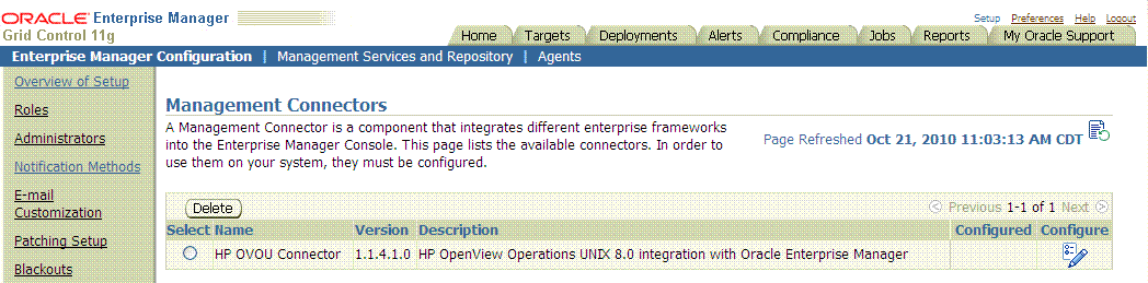

The new HP OVO connector should now appear in the Management Connectors page after the emctl register_connector command has loaded the connector, as shown in Figure 2–2.
Table 2–1 provides descriptions for the parameters shown in the procedure above.
