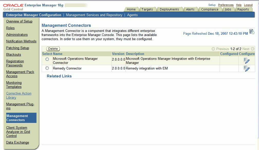

As Super Administrator, from the Enterprise Manager console, click Setup.
The Overview of Setup page appears.
Click Management Connectors in the left pane.
The Management Connectors page appears. For the Remedy Connector row, the Configured column should be blank (Figure 2-1).
A check mark instead indicates that the Connector is already configured.Click the Configure icon for the Remedy Connector.

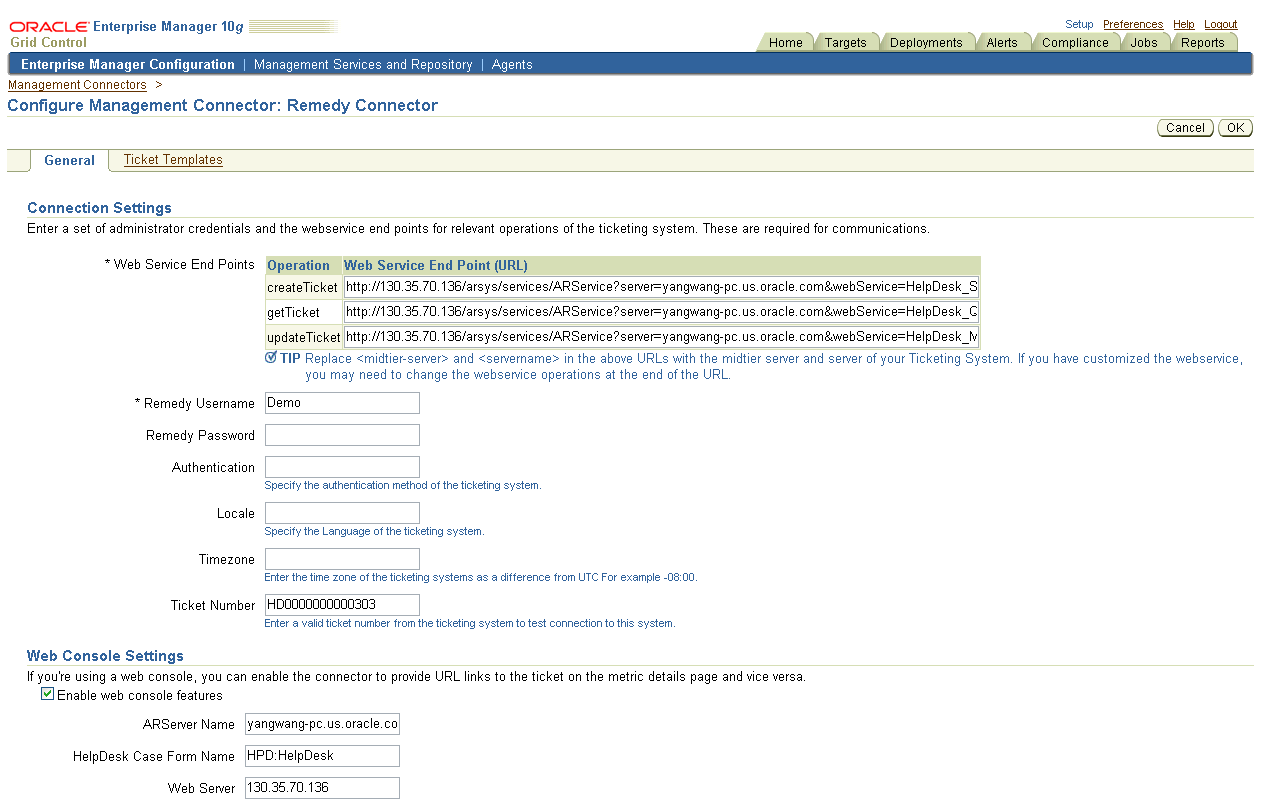

The General tab of the Configure Management Connector page appears (Figure 2-2).
Provide the required settings. See "General Settings" for details.
Click OK.
The Management Connectors page reappears. The row for the Remedy Connector should have a check mark in the Configured column.

The Remedy Trouble Ticket connector communicates with the Help Desk through their Web services. Mandatory fields are indicated by an asterisk ( * ).
Web Service End Points — End points to createTicket, updateTicket, and getTicket Web services exposed by Remedy Help Desk. See "Web Service Details" for additional details.
If your Remedy installation does not have an operation to query a ticket by case ID, you need to import the HelpDesk_Query_Service_By_Case_ID.def file into your Remedy instance. This file is located here:
$ORACLE_HOME/sysman/connector/Remedy Connector
Remedy Username — User with the privilege to create, update, and query tickets in Remedy.
Remedy Password — Password associated with the supplied Remedy user.
Authentication — String that a Remedy administrator sets for additional security. Applies only if the Remedy Administrator has configured it on the Remedy AR server. It communicates with the server if there is a secondary authentication server that can be used to verify the Remedy credentials.
Locale — Language of the Remedy system (optional).
Time Zone — Time zone of the Remedy AR System Server (optional).
Ticket Number — Enter a valid ticket number if you want to test the connection when you save the configuration. There are four possibilities for this field:
If you do not enter a ticket number, no message appears on the Management Connectors page after you click OK and the configuration is saved.
If you specify the correct Web service end points and enter a valid ticket number, the following message appears on the Management Connectors page after you click OK:
"Connection test succeeded. The configuration was saved."
If you have not previously saved the connector configuration and enter an invalid ticket number, the following message appears on the Management Connectors page after you click OK:
"Connection test failed. The configuration was saved."
If you have saved the connector configuration before, specify incorrect Web service end points, and specify either a valid or invalid ticket number, the following message appears on the Management Connectors page after you click OK:
"Connection test failed. The configuration was not saved."

To enable this functionality, provide the following Web console settings.
Enable web console — Check this box to enable launching of the Remedy ticket page within context from Enterprise Manager.
ARServer Name — Remedy AR Server name.
HelpDesk Case Form Name — Remedy form name that the Remedy Web Services (you configured the connector to use) is based on. The Remedy default Help Desk Web services, for example, use the form HPD:HelpDesk.
Web Server — The name or IP address of the server that hosts Remedy Mid-Tier.

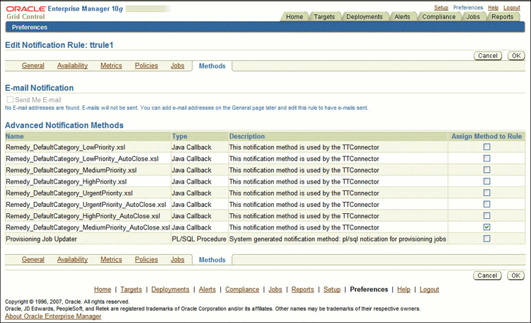

In the Create Notification Rule Methods page, choose the ticket template from the Advanced Notification Methods table (Figure 2–3).
In the table, registered ticket templates appear as Java Callback type notification methods under the same name as the ticket template's file name. This ticket template is used to open tickets for all availability and metric alerts specified in this notification rule.
This makes the ticket templates available for use to open tickets.

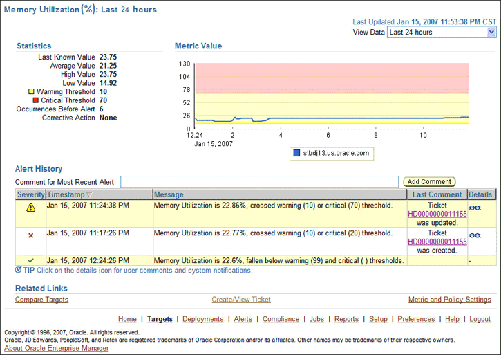

A notification is sent to the Remedy Connector when a metric alert triggers that matches your rule. The Remedy connector creates/updates a ticket according to the ticket template as set in the notification rule.
The ticket is created or updated on the Remedy Trouble Ticket system.
In Enterprise Manager, the alert annotation is updated. A comment is added to the Metric Details page of the alert to indicate that a ticket was created or updated, along with the ticket ID and ticket page URL.
A ticket is updated if there is an existing active ticket for an alert. In Figure 2-4, the first screen shows the ticket in Remedy console, and the second screen shows the alert as displayed in Enterprise Manager.

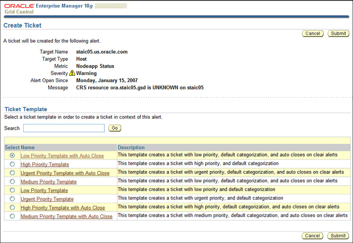

Perform the following steps to manually create a trouble ticket:

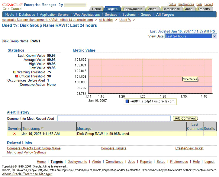

After a metric alert occurs, go to the associated metric details page for the alert. To access this page, click the alert message in the Enterprise Manager console (Figure 2-5).
Click the Create/View Ticket link in the Related Links section.
The Create Ticket page appears if no active ticket exists for the alert.
Select a ticket template and then click Submit (Figure 2-6).
If you do not see the desired template, you can register one using the emctl command. See "Registering Ticket Templates".
If creating or updating the ticket is successful, the ticket ID appears in the Last Comment column of the Alert History table for the metric alert.If the Web console settings are configured and enabled, the ticket ID appears as a link to the ticket page in the Remedy Help Desk. If there is no annotation, the ticket creation fails and error information is logged in the file emoms.log.

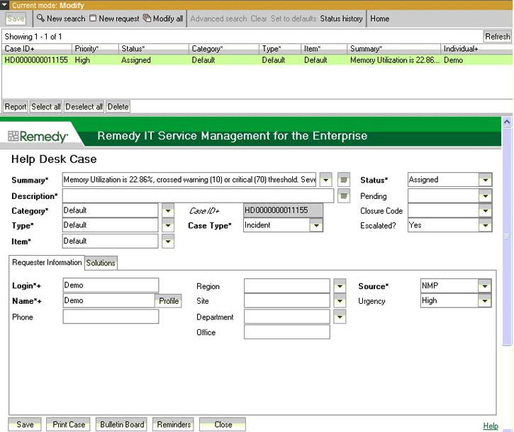

From a ticket page, click the link in the Description field to the Alert Details page in the ticket message body (Figure 2-7). This takes you to the Enterprise Manager console login page. After you provide the Enterprise Manager user name and password, you are forwarded to the alert related to this ticket.
The Enterprise Manager user whose name you specify should at least haveView privileges on the target on which the alert was raised.
On the Remedy console, if the URL appears as text, you need to cut and paste the URL into the browser.

(If not found) Click the icon in the Details column to get more information about the alert.
On the page that appears, locate the ticket ID in the Alert Details table.
Click the ticket ID link. You are forwarded to the Remedy Web console login page.
Provide valid Remedy account details.
The ticket page associated with this alert is displayed.
If you do not use the Remedy Web console, uncheck the Enable web console option in the Web Console Settings section so that ticket ID is shown in plain text. Otherwise, it is displayed as a link that does not work.This section provides details on the out-of-box ticket templates shipped along with the Remedy Connector. The ticket templates specify the mappings between Enterprise Manager alert attributes and Remedy ticket attributes.
All out-of-box templates cause the following actions to occur when a you create a ticket for an alert:
Write alert information to Description (Remedy ticket description).
Set the Remedy ticket summary based on the alert message. On update, the ticket summary field is updated to include the latest alert message information.
Set the Category, Item, and Type fields in Remedy to the default.
Set the Priority (ticket's priority) to the value indicated by the file name of the ticket template. For instance, Remedy_DefaultCategory_HighPriority.xsl sets the ticket priority to High.
Following are the out-of-box templates:
Remedy_DefaultCategory_LowPriority.xsl
Remedy_DefaultCategory_MediumPriority.xsl
Remedy_DefaultCategory_UrgentPriority.xsl
Following are the out-of-box templates with the AutoClose suffixed to the file names. They set the ticket status to Close when the event severity value becomes Clear.
Remedy_DefaultCategory_LowPriority_AutoClose.xsl
Remedy_DefaultCategory_MediumPriority_AutoClose.xsl
Remedy_DefaultCategory_HighPriority_AutoClose.xsl
Remedy_DefaultCategory_UrgentPriority_AutoClose.xsl
Following are the out-of-box templates with Wlog suffixed to the file names. They are customized for the Web services with worklog enabled.
Remedy_DefaultCategory_LowPriority_w_Wlog.xsl
Remedy_DefaultCategory_MediumPriority_w_Wlog.xsl
Remedy_DefaultCategory_HighPriority_w_Wlog.xsl
Remedy_DefaultCategory_UrgentPriority_w_Wlog.xsl
Remedy_DefaultCategory_LowPriority_AutoClose_w_Wlog.xsl
Remedy_DefaultCategory_MediumPriority_AutoClose_w_Wlog.xsl
Remedy_DefaultCategory_HighPriority_AutoClose_w_Wlog.xsl
Remedy_DefaultCategory_UrgentPriority_AutoClose_w_Wlog.xsl

If the out-of-box ticket templates do not satisfy your requirements, you can modify them. To do this, Oracle recommends that you use one of the existing templates as the base template. Copy this ticket template to a new file, modify, and register the new ticket template.
In most cases, when you modify the ticket template, you might only be changing the mappings. The following examples illustrate this point:
Example 2-2 Marking a Category to MyCategory
To create a template to mark the category to MyCategory, modify the following attribute in the template:
<urn:Category>MyCategory</urn:Category>
Example 2-3 Altering the Message Type
If you only want the alert message to appear as ticket summary instead of both message and severity, modify the following attribute:
<urn:Summary><xsl:value-of select="ns0:Message"/></urn:Summary>
The templates are highly customizable. Oracle recommends that only users with advanced knowledge of XSLT make complex changes.
You can use notification rules as a filter to associate proper ticket templates with alerts. You can have as many tickets templates as you want. One notification rule can have only one ticket template.
The out-of-box templates are based on the HPD:HelpDesk form. If the new ticket templates you define are based on the HPD:HelpDesk form, Customizing Ticket Templates applies.
However, if you use a custom Remedy Form, such as HPD:CustomHelpDesk, you need to define a new ticket template.
