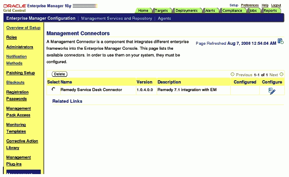

As Super Administrator, from the Enterprise Manager console, click Setup.
The Overview of Setup page appears.
Click Management Connectors in the left pane.
The Management Connectors page appears. For the Remedy Service Desk Connector row, the Configured column should be blank, as shown in Figure 3–1.
A check mark instead indicates that the Connector is already configured.Click the Configure icon for the Remedy Service Desk Connector.
The General tab of the Configure Management Connector page appears, as shown in Figure 3–2.
Provide the required settings. See "General Settings" for details.
Click OK.
The Management Connectors page reappears. The row for the Remedy Service Desk Connector should have a check mark in the Configured column.

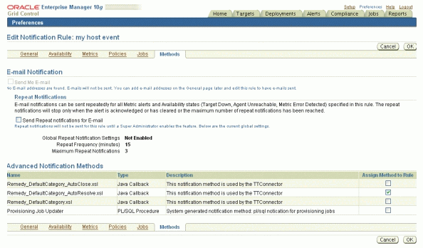

Create a notification rule using the following steps:
Important:
Do not select more than one ticket template for this notification rule.From the Enterprise Manager console, click Preferences.
In the left pane, under Notification, click Rules, then Create.
In the Create Notification Rule General page, specify the rule name, a description, and the targets for which this rule should apply.
In the Create Notification Rule Availability page, select the availability states for which you want to create tickets.
In the Create Notification Rule Metrics page, select the metrics and their associated alert severities for which you want to create and update tickets.
Ensure that you select all relevant alert severities if you want to update the ticket when the alert severity changes. For example, to open a ticket for a critical alert on the CPU Utilization(%) metric and the ticket is to be updated if the CPU Utilization(%) changes to warning or clear severity, in the notification rule select Critical, Warning, or Clear severities for the CPU Utilization(%) metric.
In the Create Notification Rule Methods page, choose the ticket template from the Advanced Notification Methods table, as shown in Figure 3–3.
In the table, registered ticket templates appear as Java Callback type notification methods under the same name as the ticket template's file name.

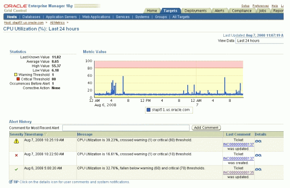

A notification is sent to the Remedy Service Desk Connector when a metric alert triggers that matches your rule. The Remedy Service Desk Connector creates/updates a ticket according to the ticket template as set in the notification rule.
The ticket is created or updated on the Remedy Ticket system.
In Enterprise Manager, the alert annotation is updated. A comment is added to the Metric Details page of the alert to indicate that a ticket was created or updated, along with the ticket ID and ticket page URL.
A ticket is updated if there is an existing active ticket for an alert. Figure 3–4 shows the ticket in the Remedy console, and Figure 3–5 shows the alert as displayed in Enterprise Manager.

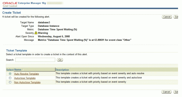

Perform the following steps to manually create a ticket:

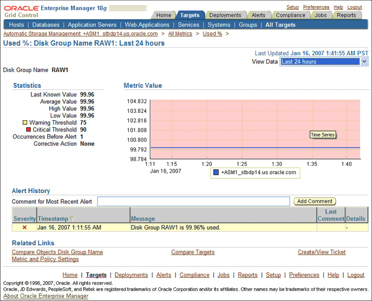

After a metric alert occurs, go to the associated metric details page for the alert. To access this page, click the alert message in the Enterprise Manager console, as shown in Figure 3–6.
Click the Create/View Ticket link in the Related Links section.
The Create Ticket page appears if no active ticket exists for the alert.
Select a ticket template and then click Submit, as shown in Figure 3–7.
If you do not see the desired template, you can register one using the emctl command. See Section 3.4.2.1, "Registering Ticket Templates".
If creating or updating the ticket is successful, the ticket ID appears in the Last Comment column of the Alert History table for the metric alert.If the Web console settings are configured and enabled, the ticket ID appears as a link to the ticket page in the Remedy Service Desk.

In the Alert History table, locate the ticket ID link in the Last Comment column.
(If not found) Click the icon in the Details column to get more information about the alert.
On the page that appears, locate the ticket ID in the Alert Details table.
Click the ticket ID link. You are forwarded to the Remedy Web console login page.
Provide valid Remedy account details.
The ticket page associated with this alert is displayed.
If you do not use the Remedy Web console, uncheck the Enable web console option in the Web Console Settings section so that ticket ID is shown in plain text. Otherwise, it is displayed as a link that does not work.This section provides details on the default ticket templates shipped along with the Remedy Service Desk Connector. The ticket templates specify the mappings between Enterprise Manager alert attributes and Remedy ticket attributes.
All out-of-box templates cause the following actions to occur when a you create a ticket for an alert:
Write alert information to Description (Remedy ticket description).
Set the Remedy ticket summary based on the alert message. On update, the ticket summary field is updated to include the latest alert message information.
The out-of-box templates are as follows:
Remedy_DefaultCategory_AutoResolve.xsl
Remedy_DefaultCategory_AutoClose.xsl
Remedy_DefaultCategory.xsl
The Remedy_DefaultCategory_AutoResolve.xsl template sets the ticket status to Resolved when the event severity value becomes clear. When the same event with a Critical or Warning severity occurs within the grace period time, the following occurs:
The ticket is reopened.
The status field is set as Assigned.
The ticket Summary, Notes, Work Info Summary, and Work Info Notes fields are updated with the latest event information. If you leave an incident as resolved, the Incident Management application closes the incident after 15 days. See the BMC Remedy Service Desk: Incident Management 7.0 User's Guide for more information.
The Remedy_DefaultCategory_AutoClose.xsl template ets the ticket status to Closed when the event severity value becomes Clear. After the Ticket Status is closed, it cannot be reassigned to other values. When the same event with critical or warning severity occurs within the grace period time, the following occurs:
The ticket is not reopened.
The status field remains Closed, but the ticket Summary, Notes, Work Info Summary, and Work Info Notes fields are updated with the latest event information.
Oracle recommends that you do not select Remedy_DefaultCategory_AutoClose.xsl if you want tickets to be reopened when a critical or warning event has occurred within the grace period.The Remedy_DefaultCategory.xsl template does not close the ticket when the event severity value becomes clear. When the same event with a Critical or Warning severity occurs within the grace period time, the ticket Summary, Notes, Work Info Summary, and Work Info Notes fields are updated with the latest event information.
