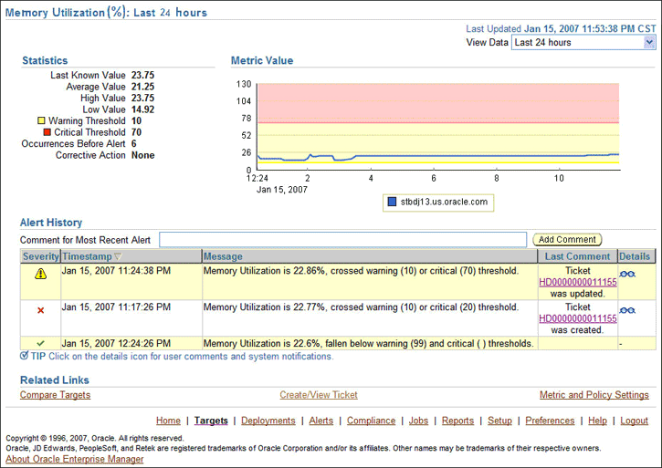

A notification is sent to the Siebel Connector when a metric alert that matches your rule triggers.
The Siebel connector creates/updates a ticket according to the ticket template as set in the notification rule.
In Enterprise Manager, the alert annotation is updated. A comment is added to the Metric Details page of the alert to indicate that a ticket was created or updated, along with the ticket ID and ticket page URL.
A ticket is updated if there is an existing active ticket for an alert. In Figure 4-4, the first screen shows the ticket in the Siebel HelpDesk page, and the second screen shows the alert as it is displayed in Enterprise Manager.
