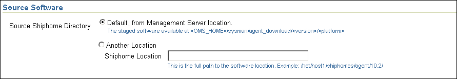

In the Source Software section, select an installation source directory. This directory can either be the default directory that exists within the OMS, for example <OMS_HOME>/sysman/agent_download/10.2.0.2.0/<platform>, or any other location where the software is available.
If you select Default, from Management Server location, then ensure that the path to the Management Agent software directory on the OMS host that you specify is visible over HTTP from all remote hosts.
To choose a location other than the default location from the OMS, select Another Location, and specify the full path to the software location where the software is staged. Ensure that the path leads up to the product.xml file. For example: /net/host1/shiphomes/linux/agent/stage/products.xml. Also ensure that this location (shared or non-shared) is accessible from all the remote hosts , and you have read permission on it.
Caution:

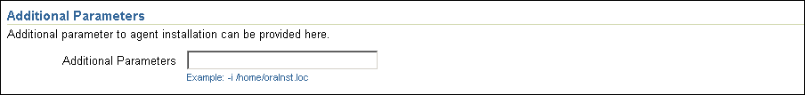

The additional parameters that you specify later in the installation process depend on the source software location that you select here.if you select the default software location, you must specify additional parameters that are supported by the agentDownload script. See Table H-1, "Parameters Supported by agentDownload Script" for a list of parameters supported by this script.
If you select an alternative location, you must specify additional parameters that are supported by Oracle Universal Installer (OUI). See Table H-2, "Parameters Supported by Oracle Universal Installer" for a list of parameters supported by OUI.

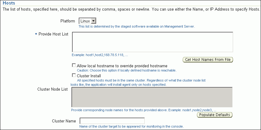

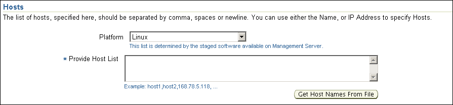

In the Hosts section, do the following:
Select the appropriate platform on which you want to perform this installation.
In the Provide Host List text box, specify all the hosts (host names or IP addresses) on which you want to perform the Management Agent installation.
Ensure that you do not specify duplicate entries of the host list. If there are duplicate host entries in this list, the application hangs. Also ensure that you use the same host names for which the SSH has been set.
When virtual host names are provided in Provide Host List and when Cluster Install checkbox is selected, the same virtual host names will be populated in Cluster Node List. These virtual host names listed in Cluster Node List must be changed to match the actual cluster node names of the hosts. The correct cluster node names can be found in OraInventory/ContentsXML/inventory.xml on each remote host.
Alternatively, click Get Host Names From File to browse and select the file that contains a list of all the required host names.
If you choose to select a file that contains a list of all required host names, then ensure that the file format is similar to /etc/hosts file. Note that the first column of the file must have the host name and when you provide multiple hosts, then ensure that the hosts are mentioned in separate lines.
Let's consider that you have the following hosts in your environment:
(1) host1 with fully qualified name host1.foo.com and IP address 154.87.3.229
(2) host2 with fully qualified name host2.foo.com and IP address 154.87.3.109
(3) host3 with fully qualified name host3.foo.com and IP address 154.80.5.218
In this case, the format of the host file should look like this:
host1 host2 host3
Alternatively, if you already have a file that has the following format, then you can use that file and format as is.
host1 host1.foo.com 154.87.3.229 host2 host2.foo.com 154.87.3.109 host3 host3.foo.com 154.80.5.218
The Agent Deploy application picks up only the values in the first column of the Host List file that you specify/select. Ensure that the host list format is appropriate because the Agent Deploy application does not validate this format on the selected file.
For Grid Control 10.2.0.1 and 10.2.0.2, use the "Populate Details" button to populate the cluster node list or provide a comma-separated list.Select Allow local hostname to override provided hostname if the specified host name is a virtual host name and not a physical host name.
For example, if the destination host name is mypc.server.com but the virtual name given to it is host1, then you can specify host1 in the Provide Host List text box, but select this check box to indicate that the specified host name is a virtual host name. The Agent Deploy application will internally interpret the virtual host name specified and map to its real, physical host name in the network.
This step is applicable only for Enterprise Manager 10g Grid Control Release 5 (10.2.0.5) or higher. In Enterprise Manager 10g Grid Control Release 4 (10.2.0.4) or lower, the New Agent Installation Wizard does not display this check box and for specifying virtual host names, you must update the agentpush.properties file as described in Prerequisites.Select Cluster Install if you want to install the Management Agent on a cluster.
For Cluster Node List, specify the cluster nodes on which the Management Agent must be installed. Ensure that you specify only the short names of the hosts, not the fully-qualified names. Alternatively, click Populate Defaults to populate this text box with all the host names that you had selected in step b.
The node names that you specify here must be the host short names, not the fully-qualified names. For example, if the node is xyz.server.us.com, and the short name is xyz, then specify only xyz in the Cluster Node List field.
If you have set up the cluster over a vendor clusterware, the node names can be different from the machine names. You can confirm the node names by executing olsnodes from the <Oracle Clusterware home> on one of the cluster nodes. If you are using Oracle Cluster release 9.2, confirm the node names by executing lsnodes from the cluster Oracle home. See Chapter 12, "Deploying Management Agent on a Cluster" for more information.
When virtual host names are provided in Host List and when Cluster Install is selected, the same virtual host names will be populated in Cluster Node List (the next field). These virtual host names listed in the Cluster Node List textbox must be changed to match the actual cluster node names of the hosts. The correct cluster node names can be found in OraInventory/ContentsXML/inventory.xml on each remote host.
In the Cluster Name text box, specify a unique cluster name. If you are extending a cluster, specify the existing cluster name here. The cluster name that you specify here identifies that cluster in the Grid Control console.
When you select the cluster installation option, Agent Deploy performs the Management Agent installation only on those cluster nodes that you have specified, irrespective of the number of hosts that make up that cluster.For example, if you choose to perform a cluster installation on a cluster having 10 nodes, but specified only 5 nodes, Agent Deploy installs the Management Agent only on the 5 nodes of the cluster that you have specified.
If you are extending an existing cluster, ensure that the cluster name you specify is the same as the existing cluster. You must also specify all the nodes of the existing cluster along with the new node on which you are installing the cluster Management Agent.

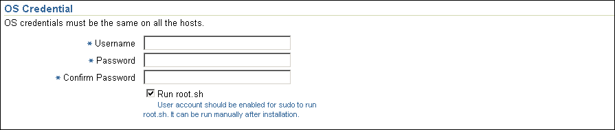

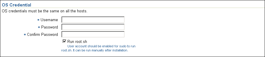

In the OS Credentials section, specify the appropriate operating system user credentials. Select Run root.sh (on UNIX machines only) if you want Agent Deploy to execute this script.
The OS credentials that you specify here must be the same for all the selected hosts.The root.sh script runs after the configuration assistants are run and before the postinstallation scripts (if any) are run. If you do not select this option here, you must run root.sh on each node manually.
Agent Deploy application uses sudo to run the root.sh script, and therefore, you must have SUDO privileges to run the script. You must also specify the invoking user's password here.
If /etc/sudoers is configured in such a way that sudo never prompts for a password, then a directory with the host password as the title gets created in the invoking users home directory. To avoid this, ensure that you configure /etc/sudoers file such that running a command using sudo always prompt for a password.

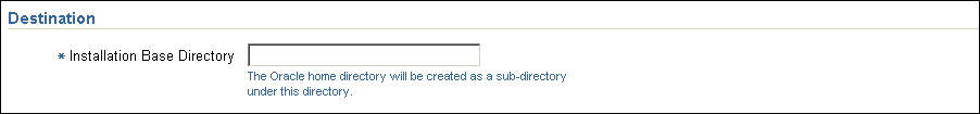

In the Destination section, specify the absolute path for the Installation Base Directory. This directory is created on all the specified hosts, and the Management Agent Oracle home directory is created as a subdirectory under this directory.
For the Management Agent installation to be successful, ensure that you extract the agentDownload kit before performing the installation.Note:
Ensure you have write permissions on the installation Base Directory that you specify.In the Port section, specify the port on which the Management Agent will communicate. The default port value for 10.2 Management Agent is 3872.

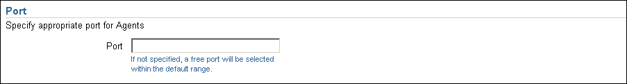

Ensure that the port you specify is not busy, otherwise the prerequisite check fails. If you do not specify a port here, then the Agent Deploy application automatically picks up a free port (3872 or in the range of 1830 - 1849).In the Load Balancer Host and Port section, specify the name of the host and port where the Server Load Balancer is set up so that communication between the Management Agent and the host running the Server Load Balancer can be enabled. This is required only if you are deploying the Management Agent in an environment that has multiple OMSes managed by a Server Load Balancer.
You can specify an HTTP or HTTPS port. However, if your OMS is configured only for secured communication(HTTPS), then you must specify only an HTTPS port.

The additional parameters you specify here depend on the software source location that you have selected.
Default Management Service Location: If you have selected the default software source directory, the additional parameters that you specify must be supported by the agentDownload script, as the Agent Deploy application uses the agentDownload.<platform> script to perform the installation. See Table H-1, "Parameters Supported by agentDownload Script" for a list of all the parameters supported by the agentDownload script.
Another Location: If you have selected an alternative software location, the additional parameters that you specify must be supported by Oracle Universal Installer (OUI), as Agent Deploy then uses OUI to perform the installation. See Table H-2, "Parameters Supported by Oracle Universal Installer" for a list of parameters supported by OUI.
Oracle recommends you to specify only those parameters that you want to run in addition to the general parameters you have already provided in this page for installation. For example, in step (7), you are providing the installation base directory. Therefore, for additional parameters, try to avoid specifying the installation base directory again. If you still do so, then the value you specified in step (7) will be ignored and the value you specified here will be used instead.
And note that if you are specifying more than one parameter, then separate them with a white space. For example, -i /etc/oraInst.loc -p /home/config/staticports.ini.

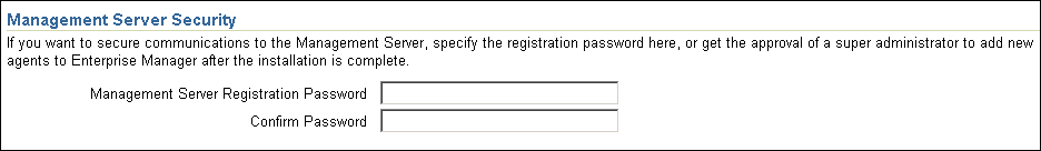

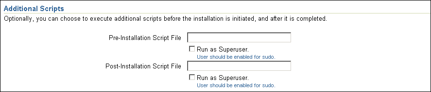

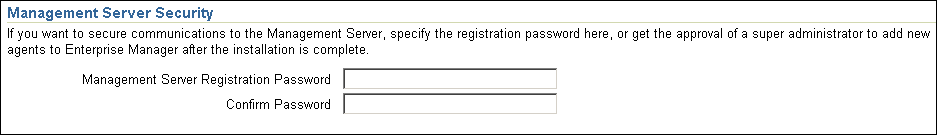

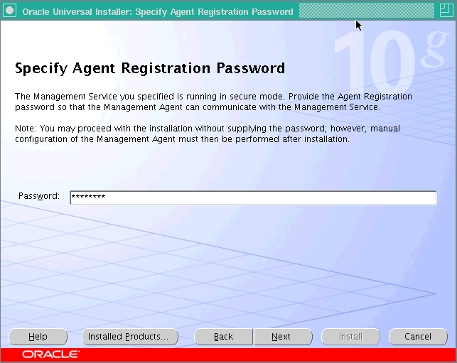

Specify the Management Service Registration Password if you want to secure communications between the Management Agent and OMS. Alternatively, the super administrator can approve the addition of new agents to Grid Control after the installation is complete.
An unsecure Management Agent cannot upload data to a secure OMS. Oracle also recommends for security reasons that you change the OMS password specified here after the installation is complete.In the Additional Scripts section, specify any preinstallation and/or postinstallation scripts that you want to execute.

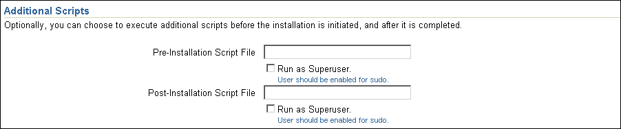

Select Run as Superuser if you want to run these scripts as root.
The preinstallation and/or postinstallation scripts that you specify must be available on all the hosts. These files are not copied onto the hosts from the software source location during installation.Click Continue.

In the Hosts section:
Alternatively, click Get Host Names From File to select the file that contains a list of all the required host names.
If you choose to select a file that contains a list of all required host names, then ensure that the file format is similar to /etc/hosts file. Note that the first column of the file must have the host name and when you provide multiple hosts, then ensure that the hosts are mentioned in separate lines. To understand how the format should look, see Example 10-1, "Host File Format".

If the Installation Base Directory is shared among the hosts that you have specified in the host list, the installer is invoked from one of these hosts (typically, the first host in that list).While the installation is performed on only one host, the application executes the configurations on all nodes in the list. That is, the preinstallation, postinstallation, and collect logs are executed on all the nodes.

In the OS Credentials section:
Specify the appropriate operating system user credentials.
The OS credentials that you specify here must be the same for all the selected hosts.Select Run root.sh (on UNIX machines only) if you want Agent Deploy to execute this script.
Agent Deploy application uses sudo to run the root.sh script. You must specify the invoking user's password here.

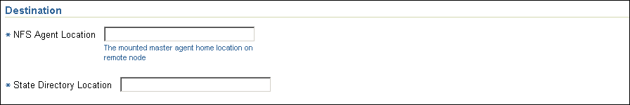

In the Destination section:
Specify the complete path to the NFS Agent Location. This is the shared directory location on the source Management Agent host that must be visible (NFS-mounted) from all remote hosts.
Ensure that the directory to which the NFS Agent is mounted on the remote hosts is the same as the NFS Agent home directory on the source host. For example, if the NFS Agent is installed at /scratch/oraclehome/agent10g, then on all the target remote hosts, the location /scratch/oraclehome/agent10g must refer to the same NFS Agent home directory.Specify an appropriate EMState Directory Location. This is a directory for storing configuration files such as emd.properties, targets.xml, log files, and so on, on each host. Every host that shares the Management Agent has its own EMSTATE directory.
In the Port section, specify the appropriate port on which the Management Agent will communicate. This is a mandatory field if you are using Enterprise Manager 10g Grid Control Release 4 (10.2.0.4) or lower.
Ensure that the port you specify is not busy, otherwise the prerequisite check fails. If you do not specify a port here, then the Agent Deploy application automatically picks up a free port (3872 or in the range of 1830 - 1849).In the Additional Parameters section, specify the parameters that you may want to pass during installation. You can specify multiple parameters, separated by a white space.

Specify any preinstallation and/or postinstallation scripts that you want to execute. These scripts are optional. If you do not want to customize your installation, leave these fields blank and continue.

If the nfsagent is the first Oracle product that is installed on the host, you must run the following command from theEMSTATE directory after completing the installation:
<EMSTATE Dir>/bin ./emctl control agent runCollection <Host name>:host Inventory

To specify the location to the oraInst.loc file. The oraInst.loc file contains the complete path to the inventory directory. This option can be used to point the installer to a non-default inventory. (For advanced users only.) |

The base directory is the location in which the Oracle home directory for the Management Agent will be created. For example, if you specify /scratch/agent_download as the base directory, then agent10g is created as a subdirectory in this base directory.

After the installation completes successfully, run the following scripts as a root user from each of the hosts.
If this is the first Oracle product you just installed on the host, then run the oraInstroot.sh script from the Central Inventory:
$ORACLE_HOME/oraInventory/oraInstRoot.sh
For example, if you are using sudo to change to a root user, then you will run the following command:
/usr/local/bin/sudo $ORACLE_HOME/oraInventory/oraInstRoot.sh
Run the root.sh script from the Oracle home directory of the Management Agent:
<agent_oracle_home>/root.sh
/usr/local/bin/sudo /scratch/OracleHomes/agent10g/root.sh
The root.sh script must be run as root; otherwise, the Grid Control job system will not be accessible to the user. The job system is required for some Grid Control features, such as hardware and software configuration tasks and configuring managed database targets.
Finally, secure the Management Agent.
For Management Agents 10g Release 2 (10.2.0.2) or lower, secure the Management Agent by running the following command. However, note that even after securing the Management Agent, some data might still be transferred over the network without being encrypted.
<Agent_Home>/bin/emctl secure agent
For Management Agent 10g Release 3 (10.2.0.3) or higher, secure the Management Agent in one of the following ways:
Set the environment variable AGENT_INSTALL_PASSWORD
Set the password in the agent_download.rsp file.
Do not perform Step (6.a) and Step (6.b) so that you can be prompted by the script. At the prompt, provide the Management Agent registration password.
The agentDownload script can be used to install Management Agents onto clustered environments. In order to perform this type of installation, the command-line options to be used are listed in Table 10-6.
Table 10-6 Command-Line Options for Cluster Installation
| Options | Description |
-c |
This option is followed by a comma-separated list of the nodes in the cluster. It is possible to install a standalone Management Agent that will still discover cluster targets by not specifying this option, while still specifying the cluster name with the |
-n |
This option is followed by the name of the cluster. This option is required for Oracle9i clusters; for Oracle Database 10g clusters, if this option is not specified, the default cluster name from the |
-l |
This option specifies that the installation should be done just on the local node of the cluster. |
For example, to use the agentDownload script to install a Management Agent on just the local node of a cluster that consists of nodes host1, host2, and host3, with cluster name myCRS, you must execute the following:
./agentDownload.<platform> -b <name of the Oracle Homes> -m <fully-qualified Oracle Management Service host name> -r <Oracle Management Service ports> -c "host1,host2,host3" -n myCRS -l
For example for Linux operating system, the command would be as follows:
./agentdownload.linux - b /oracle/agentinstall -m foo.us.oracle.com -r 4889 -c "host1,host2,host3" -n myCRS -l

By default, this installation option from Oracle Universal Installer uses the Management Agent software that is arealdy available on the host running OMS, and installs Oracle Management Agent 10g Release 1 (10.2.0.1). If you need the latest release of Management Agent, then you must patch this first release with the help of the latest patch set. The patch sets are available on My Oracle Support (formerly Metalink) at:Alternatively, to install the latest release of Management Agent, you can use the Management Agent software kit (full kit) that is available on Oracle Technology Network (OTN) at:
http://www.oracle.com/technology/software/products/oem/htdocs/agentsoft.html
You can accept the license agreement, download the software kit (zip file), extract the contents, and invoke the runInstaller from there to start Oracle Universal Installer.

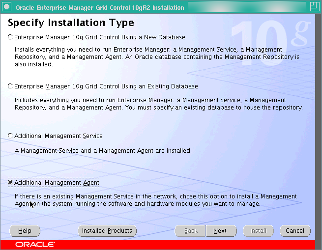

In the Specify Installation Type screen, select the fourth option (Additional Management Agent), and specify the parent directory path and installation name.

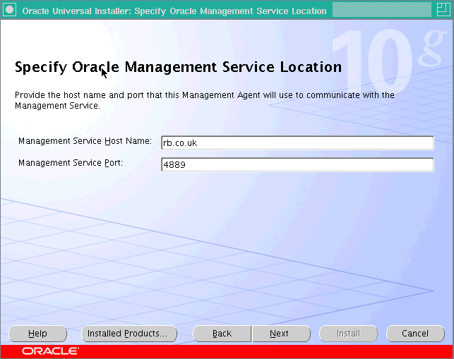

Specify the OMS host name. For example: dlsun1444.acme.com. Use the fully qualified host name (including domain). If your OMS is behind a Server Load Balancer (SLB), then specify the SLB host name.
Caution:
When specifying the host name, ensure you do not include the protocol (that is,http:// or https://).Enter the port number for the OMS. The default port is 4889 and the default secure port number is 1159. If your OMS is behind an SLB, then specify the SLB port number.
If you are installing Oracle Management Agent 10g Release 4 (10.2.0.4 or lower), not using a patch set but using a full Management Agent software download, then for Management Service Port, you must specify only a nonsecure port number (4889) even if you are specifying a secure and locked OMS. You must connect over HTTP to receive the certificate before you can connect over HTTPS.
If you are installing Oracle Management Agent 10g Release 5 (10.2.0.5 or higher), not using a patch set but using a full Management Agent software download, then for Management Service Port, you can specify either a secure port number (1159) or a nonsecure port number (4889).
If your OMS has been secured and locked, you are prompted to enter the Agent Registration password (used to secure the OMS environment). If you do not know the password, obtain it from the user who configured the OMS for SSL.
Click Next. If the OMS is found to be running in a secure mode, the Specify Agent Registration Password screen appears. You must provide the correct password to enable communications between the new Management Agent and the Secure Sockets Layer (SSL)-enabled OMS.
If you do not know the password and choose to leave the Password field blank, you must do the following after installation to enable communication between the Management Agent and secure OMS:Find out the correct password for the secure and locked OMS environment. If you do not know the password, obtain it from the user who configured the OMS for SSL.
If you have forgotten the password, then you can reset the password from the Grid Control console. Login to Grid Control as SYSMAN, select Setup from the top-right corner of the page, select Registration Passwords from the left menu panel, and on the Registration Password page, click Add Registration Password.
In the <AGENT_HOME>/bin directory, run the following command:
emctl secure agent -reg_passwd <password>
The variable <passwd> should be replaced with the Agent Registration password.
emctl secure agent
When you execute this command, you will be prompted to specify the Agent Registration password. However, note that even after securing the Management Agent, some data might still be transferred over the network without being encrypted.
