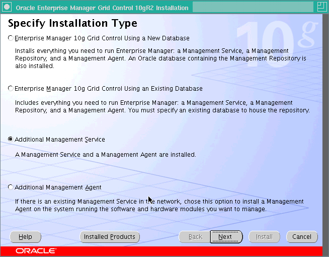

Additional Management Service |
Installs an additional OMS and a Management Agent. Allows you to map the additional OMS to an existing Management Repository, either local or remote. |

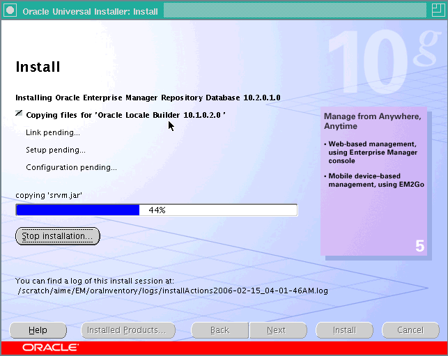

The following describes the installation process and the software components installed for this installation type.
Table 8-2 Installation Process for Installing Enterprise Manager Grid Control with a New Database
| Sequence | Action | Component Installed/Configured | Description |
1 |
Installation |
Oracle Database 10g Release 1 (10.1.0.4) |
In the specified installation directory, the installer creates a subdirectory for Oracle Database and places the software binaries in it. This Oracle Database contains an embedded Management Repository. For example, if the installation directory is /scratch/OracleHome, then the subdirectory created for the database is:
2 |
Installation |
Oracle Management Service 10g Release 2 |
Technically, the installer installs an application server, that is, Oracle Application Server 10g Release 2 (10.1.2.0.2) where the OMS is deployed. In the specified installation directory, the installer creates a subdirectory for OMS and places the software binaries in it. For example, if the installation directory is /scratch/OracleHome, then the subdirectory created for OMS is:
3 |
Installation |
Oracle Management Agent 10g Release 2 |
In the specified installation directory, the installer creates a subdirectory for the Management Agent and places the software binaries in it. The subdirectory is agent11g. For example, if the installation directory is /scratch/OracleHome, then the subdirectory created for the Management Agent is:

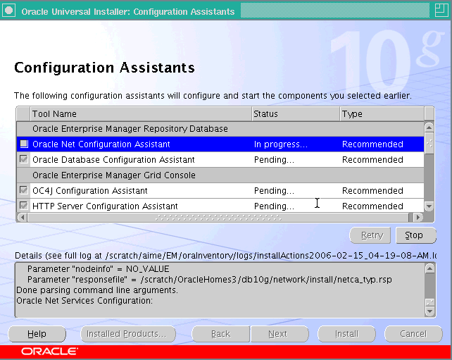

The installer runs the Configuration Assistant tools to configure all the installed components: |

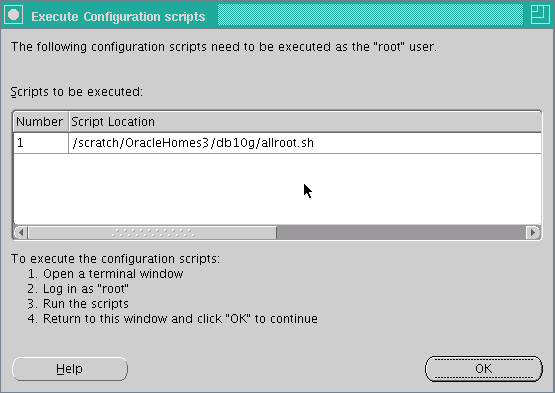

Run the root.sh script from the Oracle home of the Management Agent:
$<ORACLE_HOME>/root.sh

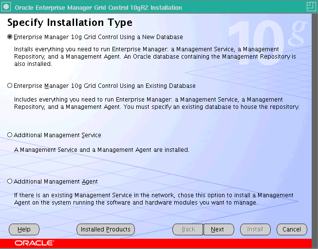

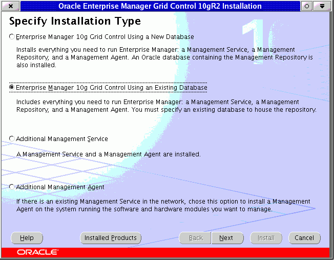

Select the first option (Enterprise Manager 10g Grid Control Using a New Database). By default, this option is selected when you invoke the installer.

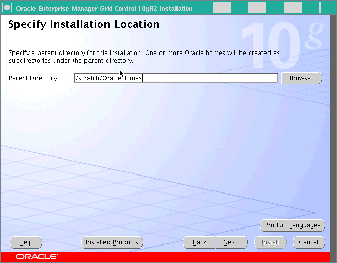

Click Next. In the Specify Installation Location screen that appears, specify a parent directory (base directory), for example, /scratch/OracleHomes (on Linux), for the new installation. All the Oracle homes created during this installation are created as subdirectories under this parent directory. For example: db10g, oms10g, and agent10g.
Ensure you do not use symbolic links to specify the Oracle home path.The selected products are installed in the English language by default. If you want to install the product in a different language, click Product Languages.

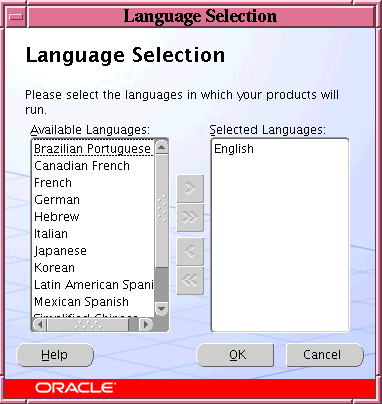

The Language Selection screen appears.
Choose the languages that you want to use to run Grid Control.
The languages that you select here change the language of Grid Control only, and not the language of the installation itself.Click Next. The Specify Inventory Directory and Credentials screen appears only if Grid Control is the first Oracle product that you are installing on the machine.

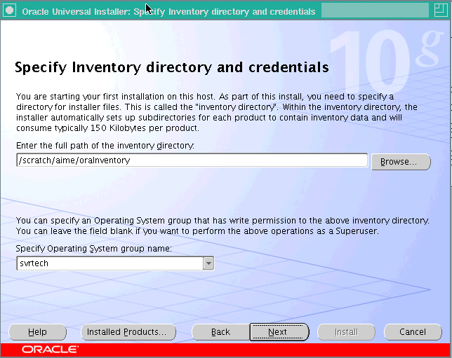

Specify the full path to the directory where Oracle Universal Installer (OUI) should place inventory files and directories. For example, oracle_base/oraInventory (on Linux).
If you are performing the installation on a Microsoft Windows platform, the Specify Inventory Directory and Credentials screen will not appear.On Microsoft Windows, the default inventory files location is <system drive>\Program Files\Oracle\Inventory.
Refer to the Grid Control online Help for more information on guidelines recommended by Oracle for naming the directories.
Select the appropriate operating system group name that will own the Oracle inventory directories. The group that you select must have write permissions on the Oracle Inventory directories.

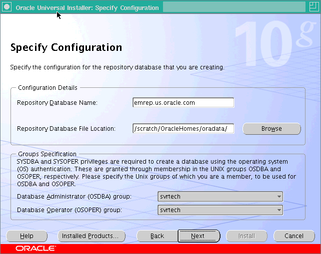

You must specify the configuration details for the new database that you are creating, and select the appropriate recipients of the OSDBA and OSOPER privileges (on UNIX only).
Your Management Repository may also require patches to be applied after successful installation. See Operating System, Browser, Target Certification for more information.Specify the new Database Name and the Database File Location (location where the new database is going to reside).
It is recommended that you specify a fully qualified database name (for example,emrep.<domain_name>), though appending the database name with the domain name is not mandatory.In the Group Specification section, select the OSDBA and OSOPER groups of which you are a member. These memberships are required to grant the SYSDBA and SYSOPER permissions that are, in turn, required to create the new database using the operating system authentication.

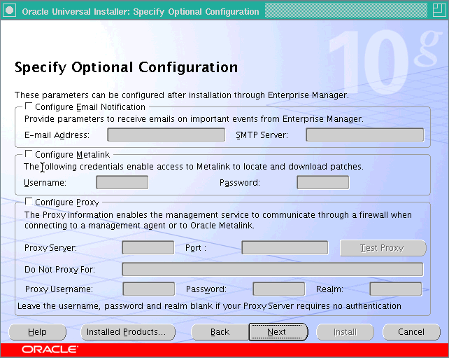

Click Next. The Specify Optional Configuration screen appears.
As the name suggests, all the fields on this screen are optional, and are disabled by default. Select the required check box to enable the corresponding fields.
In the Configure Email Notification section, specify an appropriate e-mail address, and the corresponding SMTP server name. You will receive important information on the condition of the monitored targets, including critical alerts at this e-mail address.
The e-mail address that you specify should be associated with the SYSMAN user to receive notifications.
The SMTP Server is the name of the mail server (for example mail.acme.com). For Linux, the default SMTP server is the local host name. Use the fully qualified host name (including domain).
If you do not provide the e-mail notification information, this feature is not enabled upon installation. You may also choose to configure these settings through the Grid Control console by clicking Notification Methods under Setup. Refer to the Grid Control online Help for more information.Specify the My Oracle Support (formerly Metalink) credentials.
If you prefer, you can also enter this information through the Grid Control console after installation by clicking Patching Setup, under Setup.

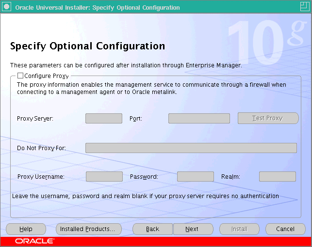

Grid Control uses these credentials to search for and download patches fromhttp://oracle.com/support/metalink/index.htmlSpecify the Proxy Information if Grid Control is using a proxy server for external access. Table 8-4 describes each of the fields under this section.
Table 8-4 Specify Proxy information - Input Fields
| Input | Description |
Proxy Server |
Specify the proxy server host name. For example, |
Port |
Specify the port at which the server is listening. For example, |
Do Not Proxy For |
Specify the URLs that do not need the proxy server to be accessed. You can specify multiple comma-separated values. For example, .here.com, .us.mycompany.com, .uk.mycompany.com, and so on. Note that you must always specify fully qualified host names. |
Proxy User and Password |
Specify the user name and password only if the proxy server has been configured to use these credentials for authentication. These are optional fields. |
Realm |
Specify an appropriate realm value. This becomes a mandatory field only if the proxy server credentials have been configured using a realm. A realm is a string value assigned by the proxy server to indicate the secure space that requires authentication. |
Test Proxy |
Click this button to verify your proxy server settings. |
When you search for a patch, if the proxy properties (saved in thesysman/config/emoms.properties file) are not set, or are set incorrectly, you receive an error message indicating that Grid Control cannot access the My Oracle Support (formerly Metalink) Web site.Caution:
If the proxy server requires user authentication before providing access, you must specify these credentials here or through the Patching Setup screen under Setup in the Grid Control console.Click Next. The Specify Security Options screen appears.

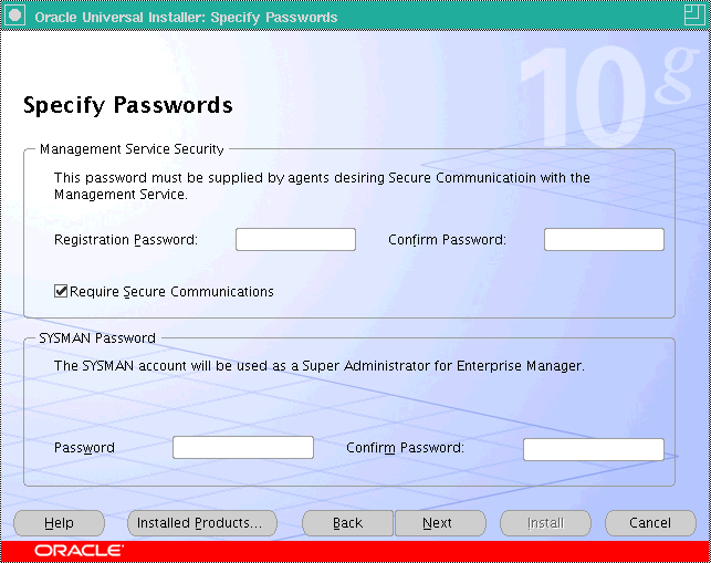

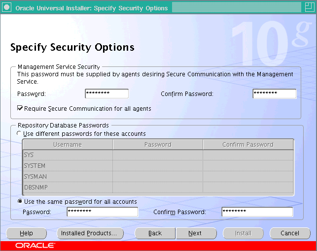

You must specify the passwords that are used to secure your entire Grid Control environment. This screen has two sections - Management Service Security, and Repository Database Passwords.
Management Server Security: The password that you specify here is used to secure and lock the OMS.
Select Require Secure Communications for all agents if you want the secure OMS to communicate only with secure Management Agents. This is optional, though recommended.
For example, consider you have unsecured 10.1.n agents in the Grid and you have secured the OMS. Now, if you select the Require Secure Communications option, then all communication between the 10.2 OMS and 10.1.n agents fails (because these agents have not been secured).
To secure a Management Agent, run following command. However, note that even after securing the Management Agent, some data might still be transferred over the network without being encrypted.<AGENT_HOME>/bin/emctl secure agent
Repository Database Passwords: Specify the passwords for each of the administrative database accounts listed in Table 8-5.
Table 8-5 Repository Database Passwords
| User Account | Applies to | Description |
SYS |
Management Repository |
Super Administrator for the Management Repository database. |
SYSTEM |
DBSNMP |
Monitoring user for the Management Repository database. |
SYSMAN |
Management Repository, Application Server, and Grid Control |
The default Grid Control Super Administrator and Owner of the Management Repository database schema and the Grid Control application user. The default ias_admin password is the same as the password assigned to the SYSMAN account. This is required to access the Oracle application server ( After the installation, if you want to change this default password, then go to the Oracle home directory of the OMS and run the following command:
If you do not remember the old ias_admin password, then follow the instructions outlined in Document ID 280587.1 that is available on My Oracle Support (formerly Metalink). |
You can use the same password for all four accounts, or specify a different password for each one. These passwords are used to secure the Management Repository database.
To specify a different password for each account, select Use different passwords for these accounts and specify the passwords for each account.
To specify the same password for all accounts, select Use the same password for all accounts and specify one password to be used for all database accounts.
The SYS, SYSMAN, DBSNMP, and SYSTEM users are privileged database users. You must remember the passwords that you specify for them. For more information on password restrictions and recommendations, see Oracle Database Administrator's Guide.Password Restrictions and Recommendations
The following restrictions apply to passwords:
Passwords must be between 5 and 30 characters long.
Passwords should not start with a number.
Passwords cannot be the same as the user name.
Passwords must include letters (lowercase/uppercase) and numbers only.
The SYSMAN password can include underscores (_), and hyphens (-), dollar ($), and hash (#) along with alphanumeric characters. Alphabetic characters can be uppercase or lowercase.Passwords cannot be Oracle reserved words. See Appendix I, "Oracle Reserved Words" for more information.
Oracle recommends that the passwords you specify have the following characteristics:Have at least one letter, one integer, and one special character (underscore).
Are not simple or obvious words such as welcome, account, database, or user.

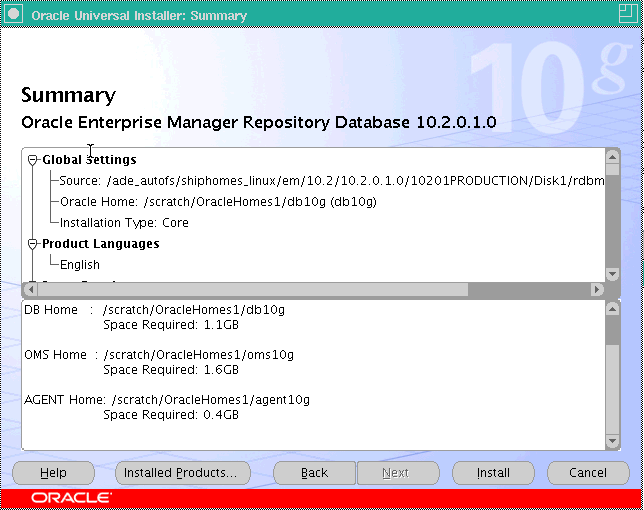

Click Next. The Summary screen appears.
This screen provides a summary of the options that you have selected during the installation process. Depending on the installation type, it also provides any or all of the following details:
Global Settings
Product Languages
Space Requirements
Installed Products
Verify the choices that you have made.
Click Install to start the installation. The Install screen that appears displays the installation progress bar.
The installer seamlessly installs all Grid Control components based on the installation type you selected.
During the installation, you are prompted to execute certain configuration scripts. These scripts and their locations are listed in the Execute Configuration Scripts dialog box that appears (on UNIX only).
The Execute Configuration Scripts dialog box will not appear on Microsoft Windows. You will be directed to the Configuration Assistants screen (step 9) in the next step.Go to the computer window, log in as root, and run these configuration scripts.
Return to the dialog box (shown in Figure 8-12) after executing the scripts, and click OK to continue the installation.
The Configuration Assistants screen appears. At this point, the installer starts running the configuration assistants.
This screen displays the name, status, and the type of each configuration tool that Oracle recommends to be run before completing the installation.
Table 8-6 lists all the configuration tools that are run during a typical Grid Control installation (Install Enterprise Manager Using a new database).
Table 8-6 Grid Control Configuration Tools
| Product | Configuration ToolFoot 1 |
Oracle Repository Database |
Oracle Enterprise Manager Grid Console |
Oracle Management Agent |
Footnote 1 Depending on the installation type that you have selected, any or all of the configuration tools listed in this table will be run.
For more information on the installation logs that are created and their locations, see Appendix B, "Installation and Configuration Log Files". In case of failure of any configuration assistant, refer to the logs and re-rerun the configuration assistants as described in Configuration Assistants Fail During Enterprise Manager Installation.
The individual log files for each configuration tool are available at the following directory:ORACLE_HOME/cfgtoollogs/cfgfw
Besides the individual configuration logs, this directory also contains cfmLogger_timestamp.log (The timestamp depends on the local time and has a format such as cfmLogger_2005_08_19_01-27-05-AM.log.). This log file contains all the configuration tool logs.
To stop running a configuration tool, select it and click Stop.
To rerun a configuration tool, select it and click Retry.
The installation is considered successful even if all the configuration tools fail, irrespective of their type (recommended/optional). However, failing to successfully run all the configuration tools results in an improperly configured product, which may not function. Refer to the Grid Control installation online Help for more information.Note:
In the event a particular configuration assistant fails, you can choose to rerun only that configuration assistant (in standalone mode). See Configuration Assistants Fail During Enterprise Manager Installation for more information.After successfully running all the recommended configuration tools, the End of Installation screen appears.

This section introduces you to the second installation type offered by OUI, that is, Enterprise Manager 10g Grid Control Using an Existing Database. In particular, this section covers the following:
This section describes the steps required for installing the base release, that is, Enterprise Manager 10g Grid Control Release 2 (for example, 10.2.0.1 Linux or 10.2.0.2 Microsoft Windows).If you are installing Grid Control for the first time in your environment and if you want to have the latest release, then use the'Installing Software-Only and Configuring Later' option that is discussed in Installing 'Software-Only' and Configuring Later.
The second installation type, that is, Enterprise Manager 10g Grid Control Using an Existing Database, is best suited when you already have a certified Oracle Database in your environment and when you want to use it to create the Management Repository. The existing, certified Oracle Database can be on a local or remote host. However, Oracle Real Application Clusters (RAC) databases must be on a shared disk.
To view a list of certified Oracle Database, see Document ID 412431.1 on My Oracle Support (formerly Metalink). If you want to use a RAC database, which is configured on a virtual host, as the existing database, then refer to Document ID 561441.1 on My Oracle Support (formerly Metalink).
If you want to use Oracle Database 11g as the existing database, then see Installing Enterprise Manager 10g Grid Control Release 5 (10.2.0.5) Using Existing Oracle Database 11g.
This installation type does the following:
Installs Oracle Management Service 10g Release 2 (Deployed in Oracle Application Server 10g Release 2 (10.1.2.0.2) that gets installed along with other core components)
Installs Oracle Management Agent 10g Release 2
Configures the Management Repository (in the existing, certified Oracle Database), OMS, and Management Agent.
The following describes the installation process and the software components that are installed for this installation type.

Start Oracle Universal Installer by running the runInstaller script in Linux (<DVD>/runInstaller) from the top directory of the DVD.
In the Specify Installation Type screen, select the second option (Enterprise Manager 10g Grid Control Using an Existing Database). Click Next.
The Specify Installation Location screen appears.
Specify the full path to the parent directory (base directory), for example, /scratch/OracleHomes. All the Oracle homes created during the installation are placed as subdirectories under this parent directory. For example: oms10g, and agent10g.
Caution:
Do not use symbolic links to specify the Oracle home path.The installer by default installs the selected products in the English language.
The Language Selection screen appears. Make the required language selections here, and click Next. See Figure 8-3, "Language Selection" for details.
Click Next. The Specify Inventory Directory and Credentials screen appears if is the first Oracle product that you are installing on the machine. See Figure 8-4, "Specify Inventory Directory and Credentials" for details.

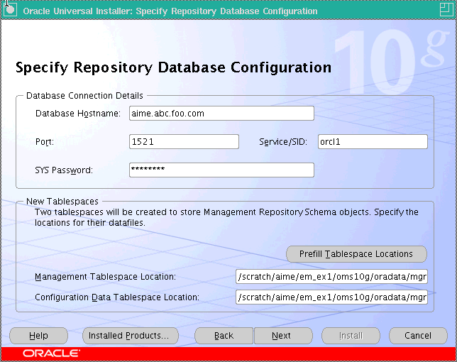

Specify the connection details for the existing database in which the Management Repository should be created. The Management Repository database can be created on the following database releases:
Oracle Database 10g Release 1 (10.1.0.4 and later), Enterprise Edition
If you are performing a Grid control installation using an existing database, ensure the database is of a 10.1.0.3 release or later.Oracle Real Application Clusters 10g Release 1 (10.1.0.4 and later)
If you are performing a Grid control installation using an existing database, ensure the existing Oracle RAC database is of a 10.1.0.3 release or later.Oracle9i Release 2 (9.2.0.6 and later), Enterprise Edition
Oracle9i Real Application Clusters Release 2 (9.2.0.6 and later)
In the Database Connection Details section, specify a fully qualified host name, listener Port number, SID (system identifier) for the database instance, and the SYS password.
The SID identifies a specific Oracle Database and distinguishes it from other databases on the computer.
When selecting an existing cluster database for creating the Management Repository, you can either specify the SID value, or use the OMS name.Enter the password for the SYS user. This account is used to create the SYSMAN user, which is the primary owner of the Management Repository schema.
In the Additional Tablespace section, specify the location for the following:
Management Tablespace Location: The MGMT_TABLESPACE tablespace holds data for the Management Repository.
Configuration Data Tablespace Location: The MGMT_ECM_DEPOT_TS tablespace holds Configuration Management data for the Management Repository.
Caution:
If the existing database that you have selected to create the repository already contains a SYSMAN schema, the installer will display an error similar to the following:"The Grid Control schema already exists in the database that you have provided."
You can choose to manually drop this schema before proceeding with the repository creation.
You can also click Continue. The installer will then automatically drop the existing schema and create a new SYSMAN schema.
For ASM (Automatic Storage Management) devices, the tablespace locations should be specified relative to the ASM disk group. For example: +<ASM Disk>/emrep/tablespace.dbf
For tuning/performance reasons, Oracle recommends placing Binary large objects (BLOBs) in their own tablespace. Because Enterprise Configuration Management data support BLOBs, the Management Repository requires two tablespaces: MGMT_TABLESPACE and MGMT_ECM_DEPOT_TS.
Specify the full path of the file locations for the previously mentioned tablespaces. The directories you specify for these tablespaces must already exist for repository creation to succeed. For raw devices, you must partition your disk before specifying its location. Note that raw device path names vary across volume managers. Ensure to use the right path format for your raw device locations.
If you do not have the complete path for the tablespaces, click Prefill Tablespace Location. Note that the Prefill Tablespace button will be enabled only after you have specified all the Database Connection details. The installer then queries the database you have specified. Look for the SYSAUX tablespace location, and prefill that path in the appropriate box.
The two tablespaces initially require 120 MB of disk space, with MGMT_TABLESPACE requiring 20 MB and MGMT_ECM_DEPOT_TS requiring about 100 MB. Ensure there is enough disk space available.
If you are selecting an existing cluster database for the new Management Repository, the management tablespace file locations must be on a shared device that is accessible to all instances that provide the database service.
Caution:
If theDBMS_SHARED_POOL package has not been installed at the time of the database creation, Oracle Universal Installer displays an error message and prompts you to execute this package before proceeding with the installation.
To check whether or not the DBMS_SHARED_POOL package has been installed, login to the database and execute the following query:
Select count(*) from dba_objects where OWNER = 'SYS' AND object_name = 'DBMS_SHARED_POOL' AND object_type IN ( 'PACKAGE','PACKAGE BODY') ;
This query should return a count of 2.
To install the DBMS_SHARED_POOL package, execute the following script:
<DB_HOME>/rdbms/admin/dbmspool.sql
Caution:
If you had not configure the database initialization parameters, then you might see the following error message:The existing database is not configured to meet the requirements.
To resolve this issue, you must correctly set the database initialization parameters as described in Check Database Initialization Parameters.
As the name suggests, all the fields on this screen are optional, and are disabled, by default. Select the required check box to enable the corresponding fields.
In the Configure Email Notification section, specify an appropriate e-mail address, and the corresponding SMTP server name in this section. You will receive information on important developments and events in Grid Control, including critical alerts, at this e-mail address.
The SMTP server is the name of the mail server (for example mail.acme.com). For Linux, the SMTP server must be the local host name. Use the fully qualified host name (including domain).
Specify the My Oracle Support (formerly Metalink) credentials if you are going to use a proxy server to access My Oracle Support.
If you prefer, you may also enter this information through the Grid Control console after installation by clicking Patching Setup, under Setup.
Grid Control uses the My Oracle Support (formerly Metalink) credentials to search for and download patches fromhttp://oracle.com/support/metalink/index.htmlSpecify the Proxy Information if Grid Control is using a proxy server for external access. See Table 8-4, "Specify Proxy information - Input Fields" for a description on each of the input fields in this section.
If the proxy server requires user authentication before providing access, you must specify these credentials here, or through the Patching Setup screen under Setup in the Grid Control console.Click Next. The Specify Passwords screen appears.
Specify the Management Service Security, and Repository Database passwords that are used to secure your entire Grid Control environment.
Select Require Secure Communications if you want the secure OMS to communicate only with Secure Agents. This is optional, though recommended.
For example, if you have 10g R1 (10.1.n) agents in the Grid environment and you have secured and locked the OMS, and selected the Require Secure Communications option, then all communication between the 10g R2 (10.2) OMS and 10.1 agents fails (because these agents have not been secured).
To secure a Management Agent, run the following command from the Management Agent Oracle home of that particular target. However, note that even after securing the Management Agent, some data might still be transferred over the network without being encrypted.
emctl secure agent
See the section on Password Restrictions and Recommendations in this chapter for more information.
This screen provides a summary of the options that you have selected during the installation process. Depending on the installation type, this screen also provides any or all of the following details:
Global Settings
Product Languages
Space Requirements
New Installations
Installed Products
Verify the choices that you have made and click Install to start the installation. The Install screen that appears displays the installation progress bar.

During the installation, you are prompted to execute certain configuration scripts. These scripts and their locations are listed in the Execute Configuration Scripts dialog box that is displayed (only on UNIX). Refer to Figure 8-12, "Execute Configuration Scripts".
To execute these scripts, go to the computer window, log in as root, and run these configuration scripts.
Return to the Execute Configuration Scripts dialog box after executing the scripts, and click OK to continue the installation.
The Configuration Assistants screen appears. At this point, the installer starts running the recommended Configuration Assistants.
The OMS Configuration Assistant will create the repository. The repository creation log (emca_repos_create<TimeStamp>.log For example, emca_repos_create05_13_33.log) is available at the following directory:
OMS_HOME/sysman/log/
This screen displays the name, status, and the type of each configuration tool that Oracle recommends to be run before completing the installation. Refer to Table 8-6, "Grid Control Configuration Tools" to see the list of configuration tools that are run. In case of failure of any configuration assistant, refer to the logs and re-rerun the configuration assistants as described in Configuration Assistants Fail During Enterprise Manager Installation.

The third installation type, that is, Additional Management Service, installs an additional OMS to your existing Enterprise Manager Grid Control environment. This option is best suited when you already have Enterprise Manager Grid Control with a certified Oracle Database, and when you want to have another OMS for the following reasons:
When you want to balance the load on the existing OMS
When your existing OMS is running out of CPU or RAM resources
However, note that you can have multiple OMSes and still connect to just one Management Repository.

Start Oracle Universal Installer by running the runInstaller script (<DVD>/runInstaller on Linux and /DVD/setup.exe on Microsoft Windows) from the top directory of the DVD.
In the Specify Installation Type screen, select the third option (Additional Management Service).
In the Specify Installation Location screen, specify the full path to the parent directory (base directory), for example, /scratch/OracleHomes. The OMS home created during the installation is placed as a sub-directory under this parent directory. For example: oms10g.
Ensure you do not use symbolic links to specify the Oracle home path.The installer by default installs the selected products in the English language.
The Language Selection screen is displayed. Make the required language selections here. See Figure 8-3, "Language Selection" for details.

In the Repository Database Connection Details section, specify a fully qualified host name on which the Management Repository database is installed, the repository port, and the SID (system identifier) for the database instance.
The SID identifies a specific Oracle database and distinguishes it from other databases on the computer.
When selecting an existing cluster database for creating a Management Repository, you must replace the SID value with the Management Service name.Enter the password for the SYSMAN user (the default Super Administrator account for Grid Control).
In the Management Service Security section, specify the password used to secure and lock the OMS.
Select Require Secure Communications for all agents if you want the secure OMS to communicate only with Secure Agents. This is optional, though recommended.
For example, if you have 10g R1 (10.1.n) agents in the Grid environment, and you have secured the OMS and selected the Require Secure Communications option, then all communication between the Oracle Management Service 10g R2 (10.2) and Oracle Management Agent 10g R1 (10.1) fails (because these agents have not been secured).
To secure Management Agent, run the following command from the Management Agent Oracle home of that particular target. However, note that even after securing the Management Agent, some data might still be transferred over the network without being encrypted.
emctl secure agent
See the section Password Restrictions and Recommendations in this chapter for more information.
The password that you specify here must be the same as the password that you specified to secure the OMS.Ensure that all OMS instances using the same repository must use the same secure password.
Select the Configure Proxy check box (optional) if Grid Control is using a proxy server for external access. Specify the properties for the proxy server host name (enter a fully qualified host name), port number, Do Not Proxy for list, and the Proxy user credentials. See Table 8-4, "Specify Proxy information - Input Fields" for a description of the input fields.
Specify an appropriate Realm value. This becomes a mandatory field only if the proxy server credentials have been configured using a Realm, in which case, you must specify an appropriate Realm value.
A Realm is a string value that is assigned by the proxy server to indicate the secure space that requires authentication.
This screen displays a summary of the options that you have selected during the installation process. Depending on the installation type, this screen displays any or all of the following details:
Global Settings
Product Languages
Space Requirements
New Installations
For more information on each of the previously listed details, see the Grid Control online Help.
Verify the choices that you have made and click Install to start the installation. The installer begins installing the selected Oracle product.
During the installation, you are prompted to execute certain configuration scripts. These scripts and their locations are listed in the Execute Configuration Scripts dialog box that is displayed (only for Linux). Refer to Figure 8-12, "Execute Configuration Scripts".
To execute these scripts, go to the computer window, log in as root and run these configuration scripts.
The Configuration Assistants screen appears. At this point, the installer starts running the recommended configuration tools.
To complete the postinstallation configurations, log in as root (in a new terminal) and run the allroot.sh script from the Oracle home directory of the OMS (oms10g).
For example,
<OMS ORACLE HOME>/allroot.sh
After successfully running all the recommended configuration tools, click Next. The End of Installation screen appears.

To install Grid Control using an existing database, follow these steps:
From the following URL, download the software for the full release of Enterprise Manager Grid Control that was release for your platform:
http://www.oracle.com/technology/software/products/oem/index.html
If your existing database is configured with Database Control, then ensure that you deconfigure it before you begin the installation of Grid Control.
To deconfigure Database Control for a single instance database, run the following command from the Oracle home directory of the database (for example, db10g):
$<ORACLE HOME>/bin/emca -deconfig dbcontrol db -repos drop
To deconfigure Database Control for a Real Application Clusters (RAC) database, run the following command from the Oracle home directory of the database (for example, db10g):
$<ORACLE HOME>/bin/emca -deconfig dbcontrol db -repos drop - cluster
After deconfiguring the Database Control, connect to the database as SYS user and run the following SQL files from the Oracle home of the database:
<ORACLE_HOME>/rdbms/admin/dbmspool.sql
<ORACLE_HOME>rdbms/admin/prvtpool.plb
The command drops all the public synonyms starting with the following names created by any user for any schema:'MGMT$%'
'MGMT_%'
'SMP_EMD%'
'SMP_MGMT%'
'SETEMVIEWUSERCONTEXT'
'DBMS_SHARED_POOL'
'EMD_MNTR'
'ECM_UTIL'
Ensure that the database initialization parameters have the correct values to create a Management Repository in the database.
For information about the initialization parameters to be edited and the values to be provided, see Check Database Initialization Parameters.
If you do not set the database initialization parameters, the installation will fail and you will find the error message "OUI-10155:Error" in the following log file:<DB_HOME>/cfgtoollogs/cfgfw/installActions<time_stamp>.log
To resolve it, set the parameters with correct values as given in Check Database Initialization Parameters, deinstall the failed Oracle homes, and then restart the installation.
Log in to the database as SYSDBA and run the following command:
@?/rdbms/admin/dbmspool.sql
commit;
Install the base release of Enterprise Manager 10g Grid Control Release 2 (10.2.0.1 for Linux or 10.2.0.2 for Microsoft Windows) using the following command:
For UNIX Platforms:
./runInstaller -noconfig -silent -responseFile <absolute_path>/em_using_existing_db.rsp -force
For Microsoft Windows Platforms:
setup.exe -noconfig -silent -responseFile <absolute_path>/em_using_existing_db.rsp -force
The em_using_existing_db.rsp file is packaged with Grid Control software. Before you run this file in silent mode, ensure that you edit the file and specify all the parameters required for a successful installation. To understand the mandatory parameters you need to specify, see Using Silent Mode to Install Enterprise Manager Grid Control Using an Existing Database of Chapter 9, "Installing Enterprise Manager Grid Control in Silent Mode".
Use the -force command only when you want to install in an existing, nonempty directory.

$<ORACLE_HOME>/opmn/bin/opmnctl stopall
(For UNIX Platforms Only) Log in as a root user in a new terminal and run the allroot.sh script from the Oracle home directory of the OMS (for example, oms10g):
$<ORACLE_HOME>/allroot.sh

To install an additional OMS to connect to an existing Oracle Database 11g, follow these steps:
Ensure that the database, which houses the repository, and its listener are running.
Log in to the database as SYSDBA user and convert the repository version from 10.2.0.5.0 or higher to 10.2.0.1.0 by running the following SQL statement:
UPDATE sysman.mgmt_versions SET version = '10.2.0.1.0' where component_name='CORE'; commit;
Invoke the installer of Enterprise Manager 10g Grid Control Release 2 (10.2.0.1):
For UNIX Platforms:
./runInstaller -noconfig -silent -responseFile additional_mgmt_service.rsp use_prereq_checker=false b_skipDBValidation=true
setup.exe -noconfig -silent -responseFile additional_mgmt_service.rsp use_prereq_checker=false
Theadditional_mgmt_service.rsp file is packaged with Grid Control software. Before you run this file in silent mode, ensure that you edit the file and specify all the parameters required for a successful installation. To understand the mandatory parameters you need to specify, see Using Silent Mode to Install Additional Management Service of Chapter 9, "Installing Enterprise Manager Grid Control in Silent Mode".Log in to the database again as SYSDBA user and convert the repository version back to what is was, that is, 10.2.0.5.0 or higher, by using the following SQL statement. The following SQL statement uses 10.2.0.5.0 as an example; therefore, it you are installing a higher release, then replace it with that release number.
UPDATE sysman.mgmt_versions SET version = '10.2.0.5.0' where component_name='CORE'; commit;
$<ORACLE_HOME>allroot.sh
