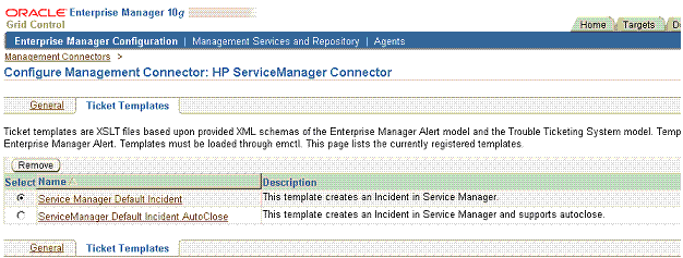

To verify that the templates are registered properly, navigate to the Ticket Templates tab on the Configure Management Connector: HP Service Manager Connector page. The registered templates must be visible in the list as shown in Figure 3–1.
Click a template name to view the code for the template.

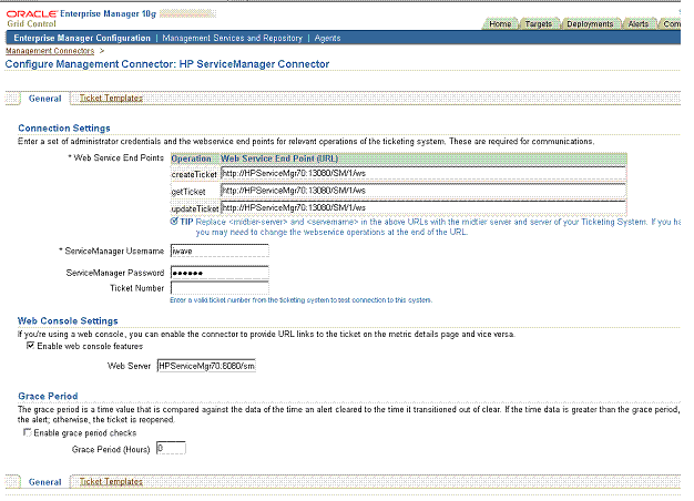

Configure the connection settings:
Web Service End Points
Specify the appropriate server or IP address of the server hosting the Service Manager 7 Web services. Provide the server address in the format ...
http://<server name or IP address>: 13080/
... where 13080 is the default installation port. This may vary with your installation.
These end points to CreateTroubleTicket, UpdateTroubleTicket, and GetTroubleTicket Web services are exposed by HP Service Manager Help Desk. The CreateTroubleTicket and UpdateTroubleTicket operations are used during manual and automated ticketing.
The GetTroubleTicket operation is only used on this window by testing the Ticket Number retrieval process. For more information about testing the ticket retrieval process, see Section 3.4, "Testing the Connector".
Service Manager Username
Specify the user name for HTTP basic authentication supported by the HP Service Manager web services. This user name must have the appropriate privileges/roles in the Service Manager to create, update, and query tickets in the HP Service Manager. All incident tickets created through the connector are generated with this user account.
Service Manager Password
Specify the password associated with the supplied HP Service Manager user.
Ticket Number
Specify this to verify the Web service end point information. See Section 3.4, "Testing the Connector" for more information.
(Optional) Configure the web console settings.
Web console settings are required if you want the Connector to provide links from Enterprise Manager to the HP Service Manager application user interface. These are the User Interface navigational links from Enterprise Manager to the HP Service Manager application user interface.
Enable web console features
Check to launch the HP Service Manager Incident Ticket page within the context from Enterprise Manager. If this is not checked, the HP Service Manager Web console cannot be launched in context of the ticket from the Enterprise Manager console.
Web Server
HP Service Manager host name. Provide the system name and port details of the Web server that hosts the HP Service Manager Application User Interface (not the details of Web services or the database server). Enter the Web Server address in the format:
<Servername or IP Address>:<Port>
See:
To install the middle tier, see the HP Service Manager 7 Web Tier Installation Guide.To configure the Web console, see Section 3.3, "Configuring the HP Service Manager Web Console".
(Optional) Configure the grace period.
If you configure this option, Enterprise Manager alerts that have generated an incident will update or reopen the incident if an alert is triggered. The alert occurs again within the grace period time specified. This setting applies to all alerts processed by HP Service Manager Connector.
See Section 1.5, "Grace Period" for conceptual information about the grace period.

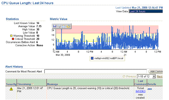

In the Enterprise Manager console, click the alert message to go to the metric details page for the alert.
In the Alert History table, locate the ticket ID link in the Last Comment column shown in Figure 3-3.
If not found, click the icon in the Details column to get more information about the alert.
On the page that appears, locate the ticket ID in the Alert Details table.
