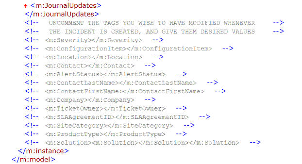

In most cases, when you modify the ticket template, you might only be changing the mappings. Example 4–1 illustrates this concept.
Example 4-1 Adding an existing data element exposed in the Service Manager Incident Management WSDL
Select an out-of-the-box template (.XSL) and make a copy. For example, copy Service_Manager_Default_Incident_AutoClose.XSL to Service_Manager_Main_Incident_AutoClose.XSL.
Modify the new XSL document to reflect the change. This example makes a simple change to set the default company to a fixed 'value' of 'AJAX'. Open the newly-copied XSL file in edit mode as shown in Figure 4–1.
The XSL has two primary branches: Create Incident and Update Incident. This example only modifies the first branch.
Navigate to the code in the incident create block as shown above. Uncomment the Company element as shown below and add the fixed text of AJAX.
<m:Company>AJAX</m:Company>
This instructs the connector framework to supply the value of AJAX in the Service Manager field value of Company.
Save the file and register the template as described in Section 3.1.1, "Registering Ticket Templates".
The template is now ready to use in notification rules or as a template for manual ticket creation. When used, it behaves the same as the out-of-the-box template copied, except when a Service Manager incident is created, the incident company will be AJAX. Of course, AJAX must be a valid Service Manager company or the request will fail.
